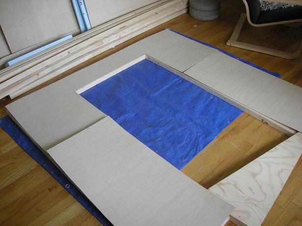

Yesterday was a day given to the family (primarily a baby shower for one of my daughters) but I am back to work on the trailer today. The weather looked iffy but I decided to try working outside, as the living room is getting crowded. The sunshine held up fine! :)

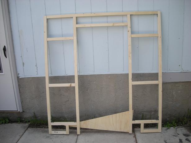

I framed the back wall (the one that will have a door) and cut the pieces of 1/8 ply that will cover the inside of that wall. I also glued canvas to the outside of the front wall, leaving 8" at the bottom for "tucking under" later.
This means that I now have 4 walls, in various stages of completion! :woohoo:
The back wall has a piece of ply across the bottom, just to keep it square for now. I will remove that once I attach that wall to the trailer. It's almost suppertime, so I'm quitting for now. After supper I will glue & screw the 1/8 ply to the new wall framing, and let it dry overnight. Tomorrow, on to other trailer tasks! Luckily, I have 3 days off from my job. :)

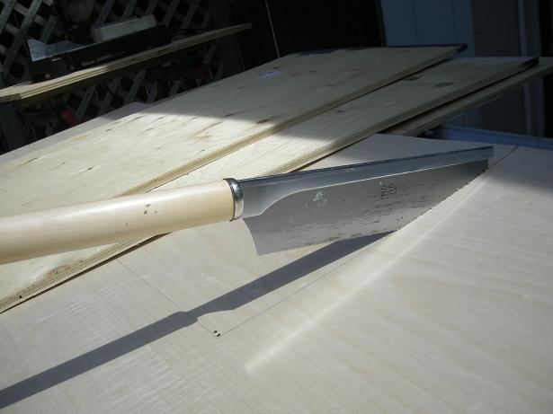

dozuki with maple ply.JPG (37.91 KiB) Viewed 1580 times

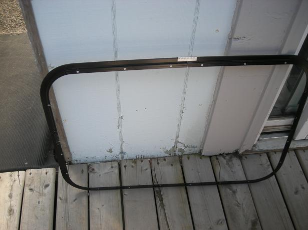

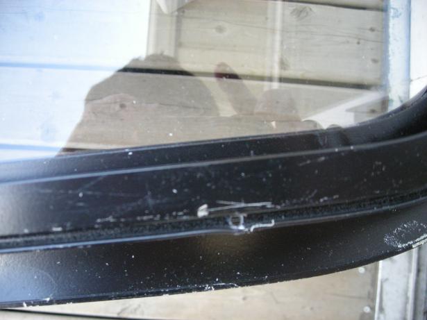

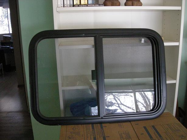

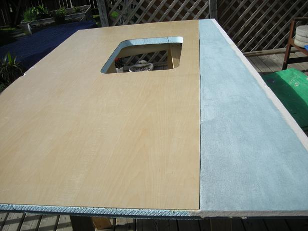

My next task is to mark and cut the holes for the windows. When I bought the windows from the rv place, I paid no attention to how they would fit into the wall. It turns out they come with an extra frame, which is meant to go on the inside of the wall. This frame has pre-drilled holes in it, and it looks like, in its previous life, this window worked by having screws driven through those holes on the inside frame, and INTO the metal of the window frame proper. The window attached to itself, with the wall sandwiched between. The holes left by those screws are quite small, making me think the screws were narrow ones.
I could try to use this same system for my trailer, or I could drill new holes in the flange on the outside, turning the flanges into nailing fins. I haven't decided which way to go. In either case, my first step is to cut a hole. And insert some sort of wooden framing.

Postby KCStudly » Wed May 21, 2014 4:04 pm
Find the correct screws and use the clamp rings. That way you have a lot less holes going through that you need to worry about staying water proof.
You will have to make sure that the window/clamp ring combo is compatible with your wall thickness. If not some people will make a spacer/shim ring to take up the difference. You may also be able to invert the rings.

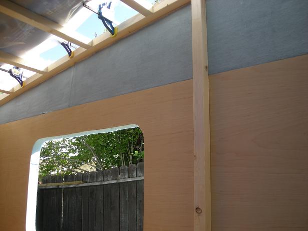

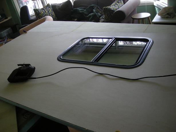

Thanks, KC! I will keep all that in mind. Today I work an aft/eve shift at my job, so I just had time to cut the holes for the windows. In one of these pics, I have a window stuck in (on the wrong side of the wall) to test the fit. Funny thing, when I cut the first piece out (with jigsaw) it fell softly to the ground (like a feather) because it was so light. The second one got stuck in the hole and had to be gently pushed out. Now I wonder what to do with these 2 piece of 2" foam with 1/8 ply laminated to them. :)

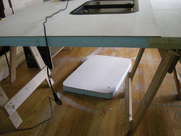

Shar wrote:Now I wonder what to do with these 2 piece of 2" foam with 1/8 ply laminated to them.
I did a test piece that is basically the same thing. It makes a very good cutting mat and protects my work bench when I am cutting out router templates using the razor knife and/or chisel. I also use it like a tray for holding small parts during finishing. Tape some butchers paper to it, brush poly on a handful of parts, set them on the "tray" (sometimes on little scraps to hold the pieces up so they don't stick); then I can move the tray and all the parts as one to another part of the bench and move on to larger parts that are lined up in the "finish me" queue.

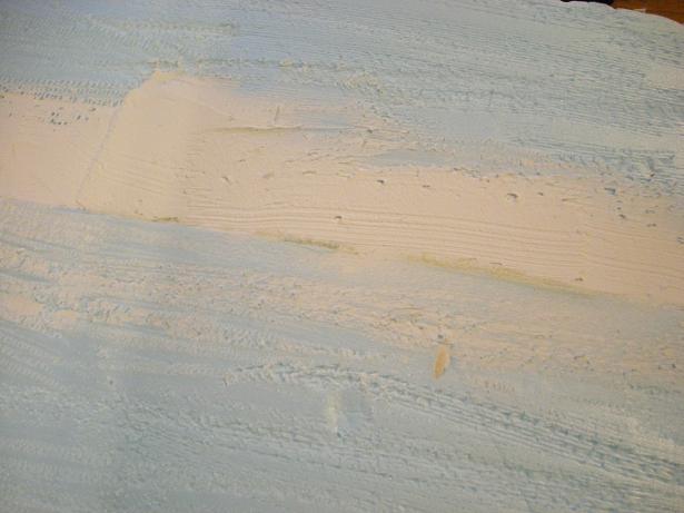

Yesterday, I finished prepping the back wall panel, and prepared the BIG pieces of canvas for the side walls. Today, I've suddenly got the flu and can't do anything. :Oh Brother:
Tomorrow, exciting things can happen if I'm feeling a lot better by then! We shall see.

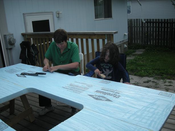

My daughter and granddaughter came over today, and with my daughter's help I was able to test-fit each of the walls and drill the guide holes for the screws I will be using when I "glue & screw" it all later. I found I had to cut out some foam from the side panels to allow for the fenders, and notch the foam next to the brake lights, and even (sob) cut a small piece out of the plywood to allow for the presence of the hinge joint near the middle of the trailer frame. We also did a bunch of sanding, to round off the foam at the bottom of the walls and around the fenders. Tomorrow I will do more sanding and maybe glue canvas on. I can't glue the canvas at the edges of the walls, because it isn't all fitted together yet, but maybe I can glue the centers and leave the edges flapping for now?? :NC
Here I am sanding foam with one of my helpers.

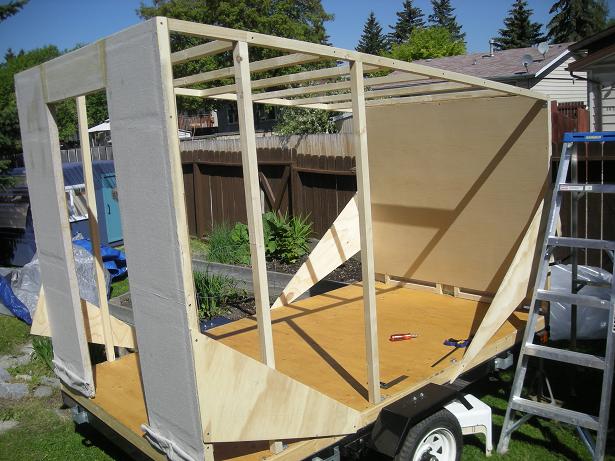

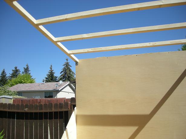

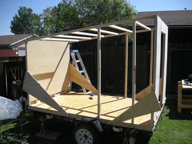

Last night after work, and this morning, was our first chance in recent days to work on the trailer together- this part required 2 pairs of hands. I came down with a nasty cold at the same time, but we persevered and got the wooden parts of the cabin and roof framed. There are a few details not done, such as the frame for the roof vent, but I can do those later in the week when I'm not so sick. :no:
Thursday is our next chance, and I'm hoping we can attach the side walls then. In the meantime I will glue the sections of foam together for the roof (they will sit on top of the spars you can see in the pics).
It started raining again this afternoon, but we had baby all nestled in tarps so things should be ok. The ply braces you see in the pics are to hold it steady till the foam side walls are attached.

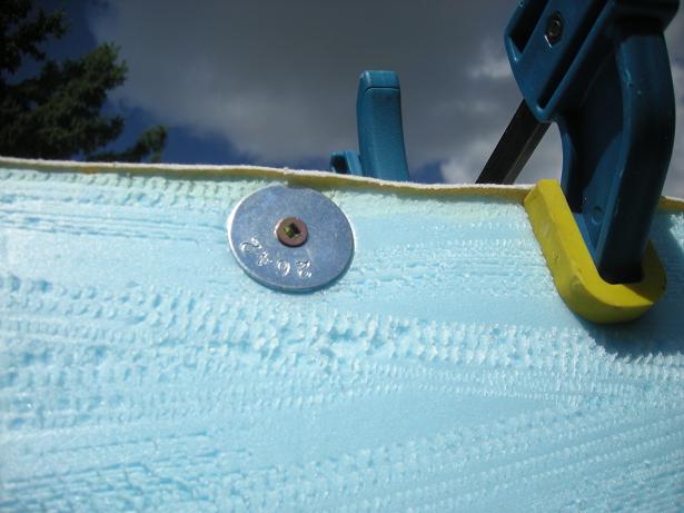

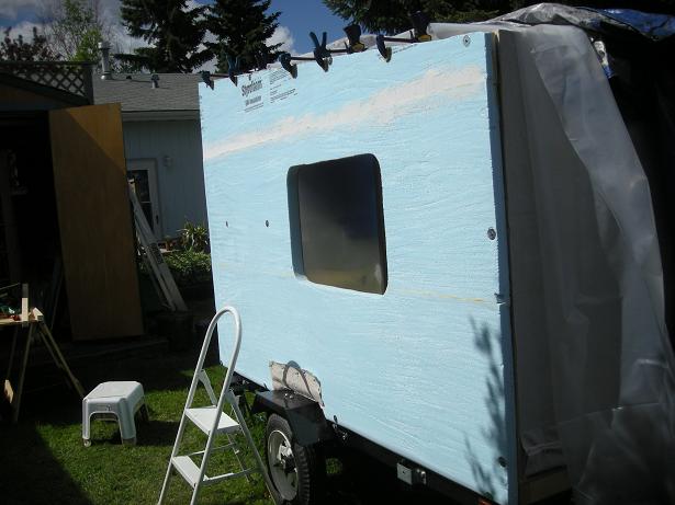

I was able to attach another wall today. This was one of the foam side walls, which I glued to the floor and the end walls with Gorilla Glue, using clamps and some 3 inch screws with washers on them to hold the surfaces together. That was all we had time to do before I had to go to work.
Someday soon we will attach the other wall, and in the meantime I can make the door, prepare the roof foam, and do any gap-filling and sanding needed on the 3 walls that are in place. I will not do any more canvasing till all the walls and roof are on. It occurred to me today that it might be possible to fill small gaps by putting some GG in there, then spraying in some water. The glue should foam up and fill the gap. Bigger gaps will need GS instead, I suppose.
Here are some views of what we did today, and how it's looking inside. The blue inside surface is painted canvas.
