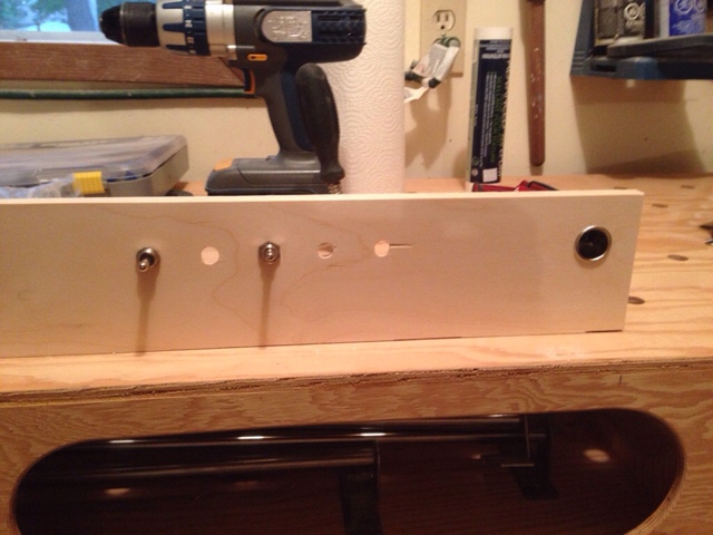

I'm still thinking about how to deal with the excess hatch seal so I went on to other work while I contemplated that matter. This evening I hacked together a panel to finish the top of my interior cabinets and function as a switch board to turn on and off power to some lights both inside and out as well as provide a place for some 12v lights to plug in. Here is the result. All prepped to be given some coats of Varathane.
Tomorrow I will start the finishing of it and then get it wired up on the weekend.

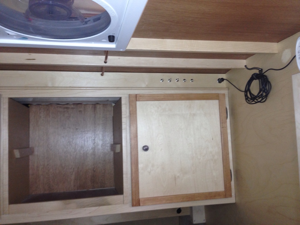

The photos aren't great but here is the finished panel and switches installed in the trailer.

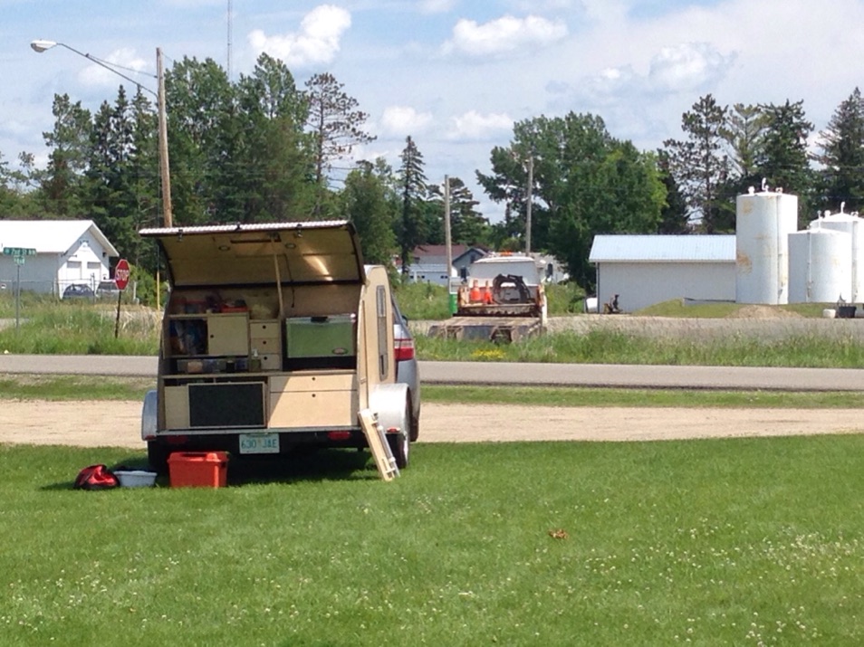

Lunch at a rest stop on US-2 east bound though Minnesota.
