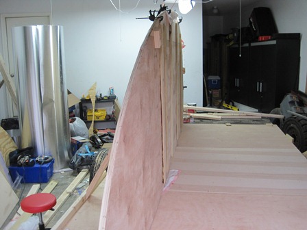

Over the weekend I did get the 2nd wall joined together and both walls clamped together and belt sanded. Last nite I also bought the the cross pieces for the roof joist, and got the liner panels for inside.
Next job is to get the bottom layer of aluminum sheeting on, and get the floor permanently fastenend to the trailer.

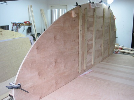

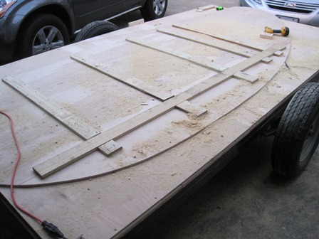

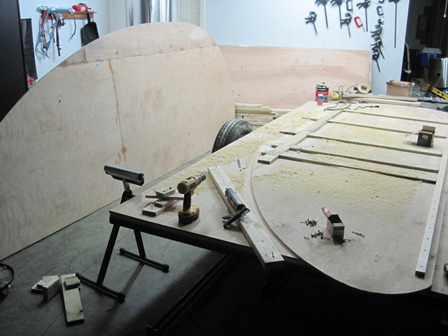

Postby BuildingForFun » Wed Aug 13, 2014 11:39 am

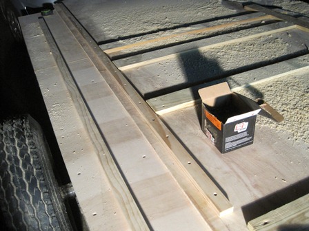

Last nite I added some wall studs, and the bottom piece of wood that will sit on the floor of the trailer. Moving, but slowly.
Both walls clamped together.
Both Walls sanded.
BuildingForFun
Posts: 110
Joined: Fri Jul 25, 2014 3:09 am
Re: 1st time build, A surprise for the Wife :)

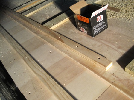

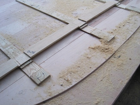

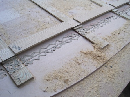

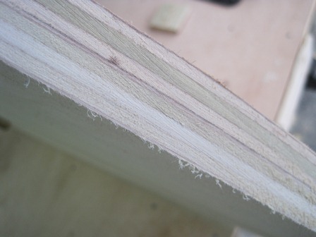

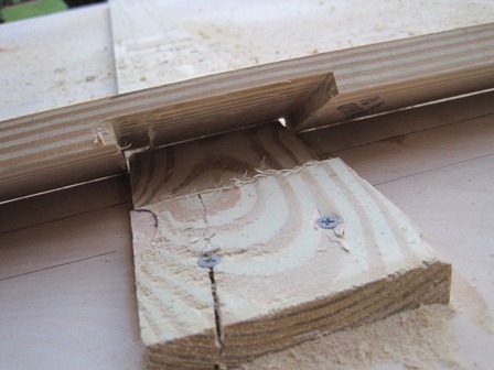

Postby BuildingForFun » Wed Aug 13, 2014 11:42 am
I took the router and cut into both pieces of wood, hopeing that it would make it stronger.
BuildingForFun
Posts: 110
Postby BuildingForFun » Wed Aug 13, 2014 11:47 am
Fit into place.
This is the wood strip that will rest on the floor, while the wall will over hange off the edge.
Last edited by BuildingForFun on Wed Aug 13, 2014 11:49 am, edited 1 time in total.
BuildingForFun
Posts: 110
Postby BuildingForFun » Wed Aug 13, 2014 11:49 am
End of day.....also the garage is in a lil better order now. :)
Done for the nite.

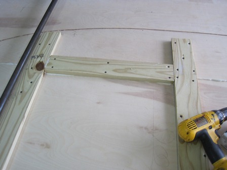

Postby BuildingForFun » Thu Aug 14, 2014 8:04 am
RollingBean wrote:I have to ask. I'm about to start my build and questions are popping to my head as i follow your blog. How far are you spacing your screws for your joists?
Hurry and get started!!! :thumbsup: but beware, its addictive, im having lots of fun.....my only complaint is that I cant spend enough time in the garage. lol
To answer your question, are you talking about the wall joist? See photo below.
If so, I believe I was putting 2 screws side by side about every 8 to 12 inches, plus the glue.......this prob is a lil over kill...... but I would rather to many, than it start coming apart later on.

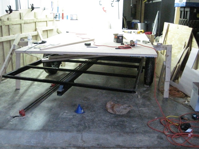

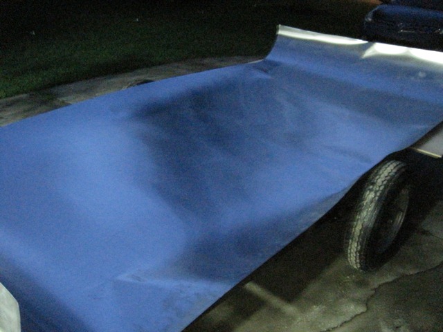

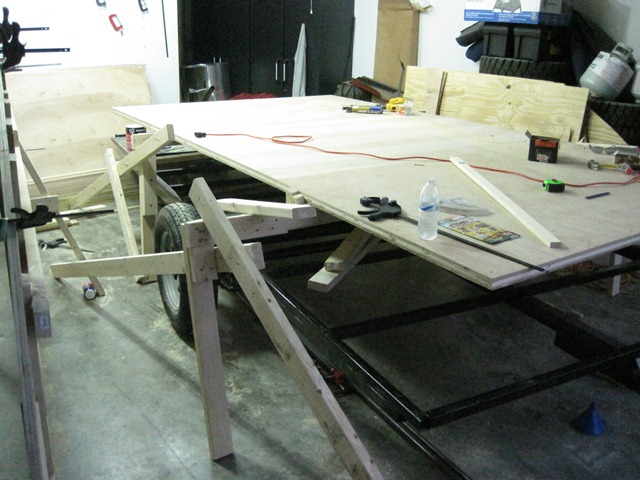

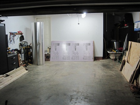

Postby BuildingForFun » Wed Aug 20, 2014 7:30 am
So, the only thing keeping me from putting on the walls and fastening them permantly to the floor is,
1. Putting the aluminum layer under the floor for a weather barrier.
2. Bolting the floor to the frame.
So, last night I built some temporary bucks to hold the floor above the trailer, so that I could back the trailer out, and lay the aluminum sheeting on the frame.

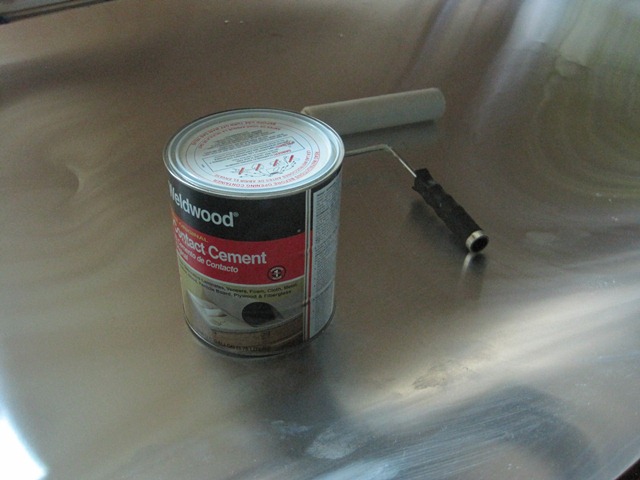

After I got this done, I rolled the trailer back into the garage, spread the contact cement, and lowered the floor back onto the aluminum sheeting and frame........Sure do miss forklifts.....
Floor lifted off Frame, Be Careful not to Sneeze, it may fall over.....lol
BuildingForFun
Posts: 110

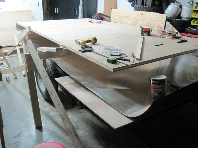

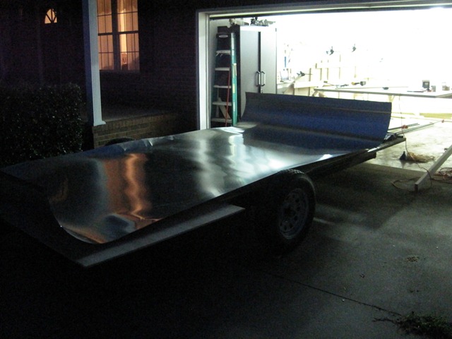

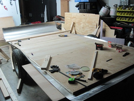

Postby BuildingForFun » Wed Aug 20, 2014 7:32 am
Trailer backed out from under the floor, and the aluminum rolled out.
BuildingForFun
Posts: 110

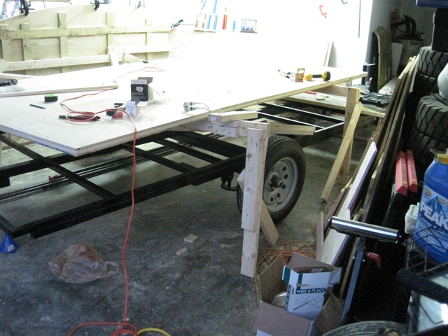

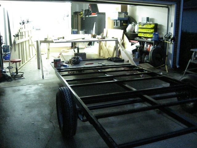

Postby BuildingForFun » Wed Aug 20, 2014 7:37 am
Trailer under the floor again, I then crawled/squeezed in between, spread the glue, and set the floor back onto the frame and alum to dry......
Next is to bolt the floor to the frame, and start fastening the walls as soon as they are ready.
Trailer rolled back under the floor.
Getting ready to spread the contact cement
Glued, and drying.
