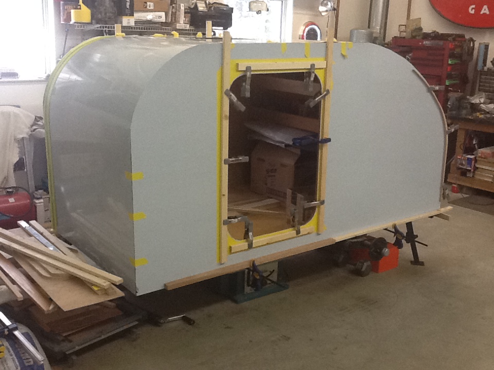

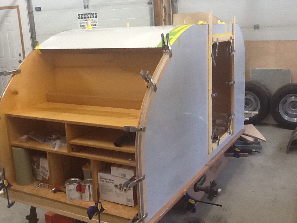

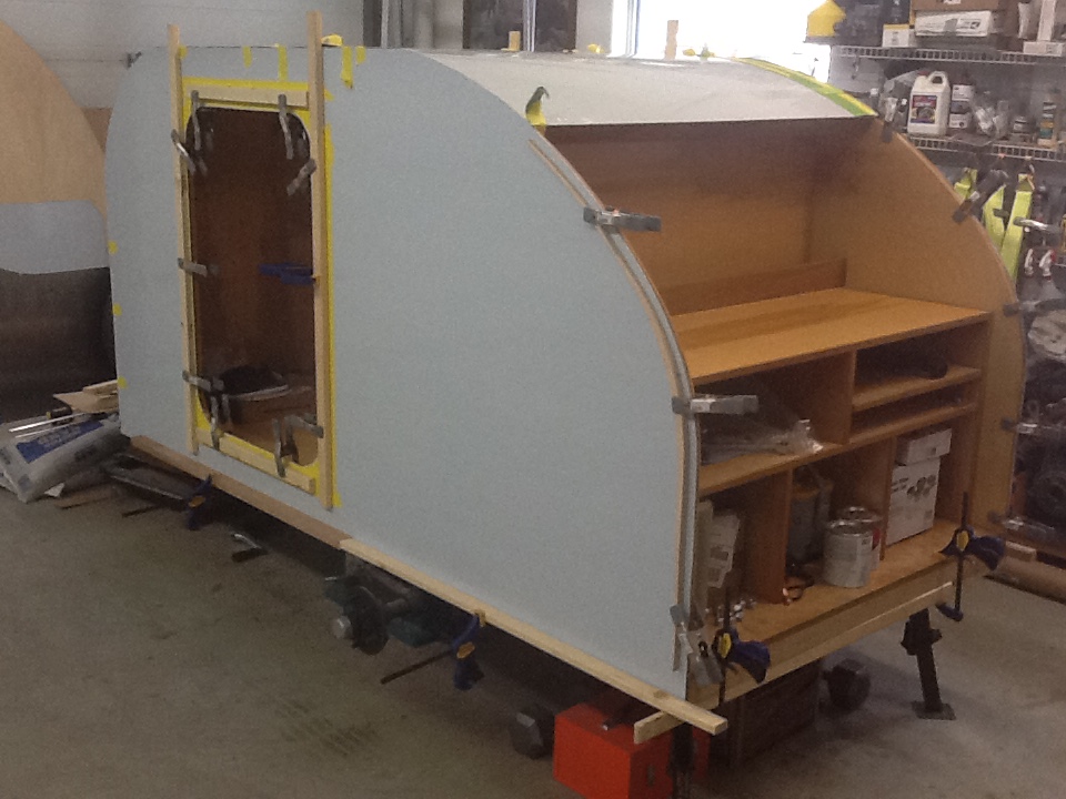

Postby ratrod71 » Sun Feb 21, 2016 3:57 pm

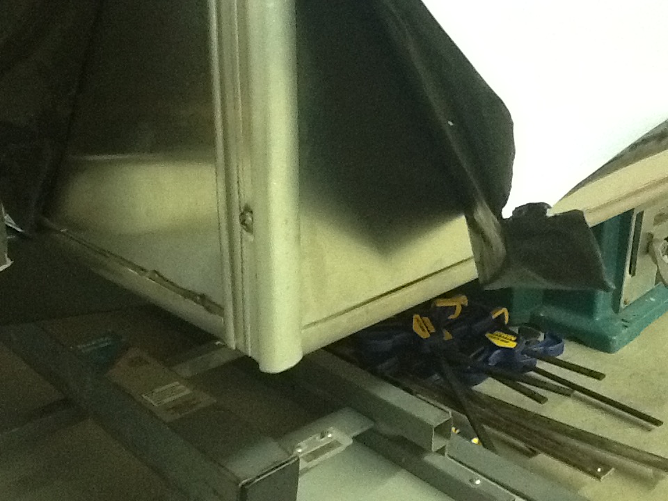

The aluminum sides are on! Been waiting for this day a long time. I chose to use 3M 4200 around the perimeter and around the door to seal out mousture. Next steps are to mount the roof vent/fan, and the side trim. Happy building, Bryan

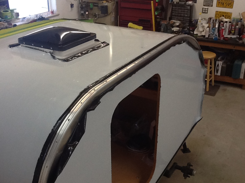

Postby ratrod71 » Sun Feb 21, 2016 7:08 pm

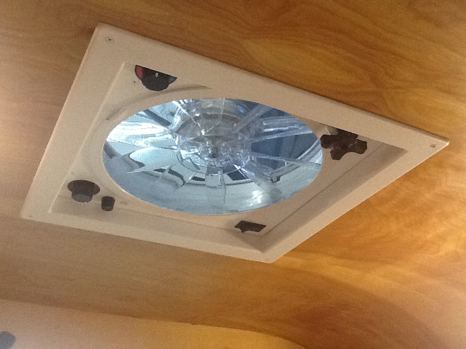

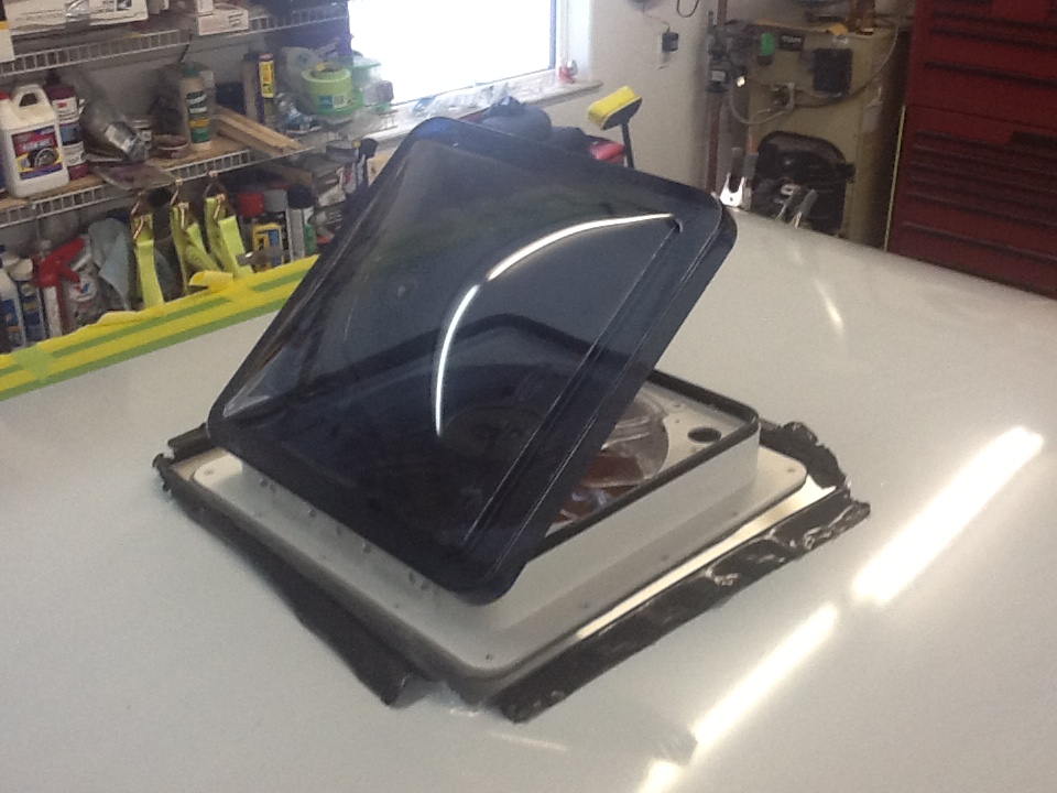

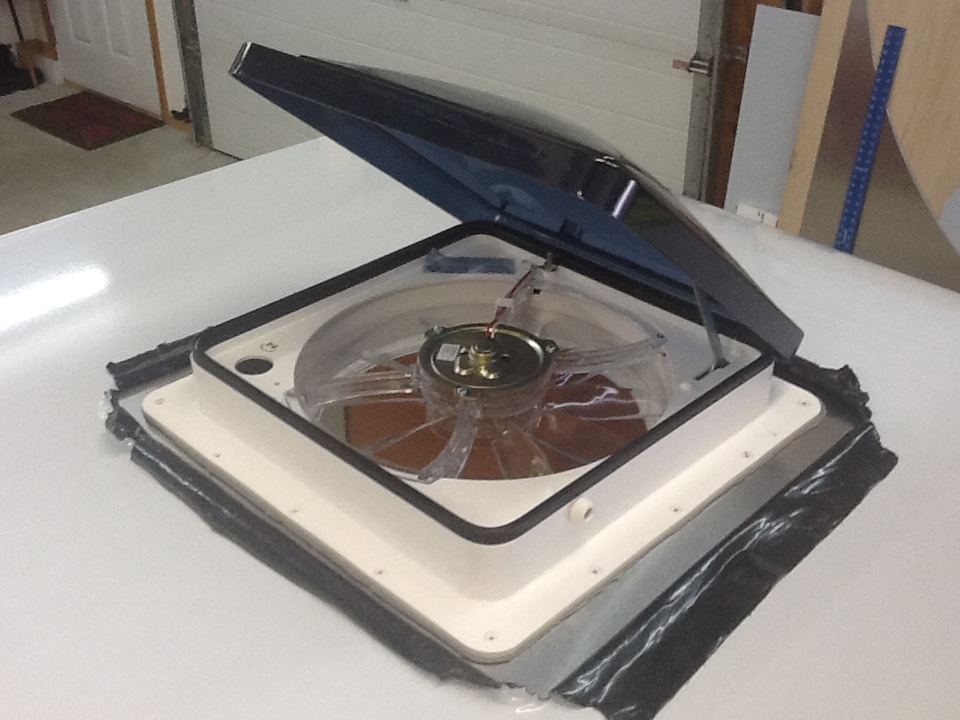

Fantastic Vent fan assembly is installed and works perfectly.

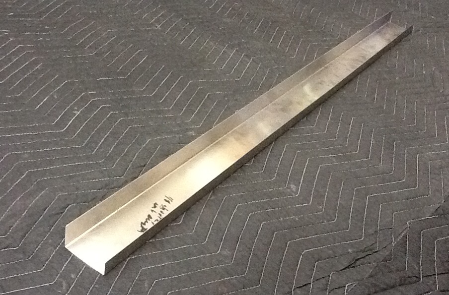

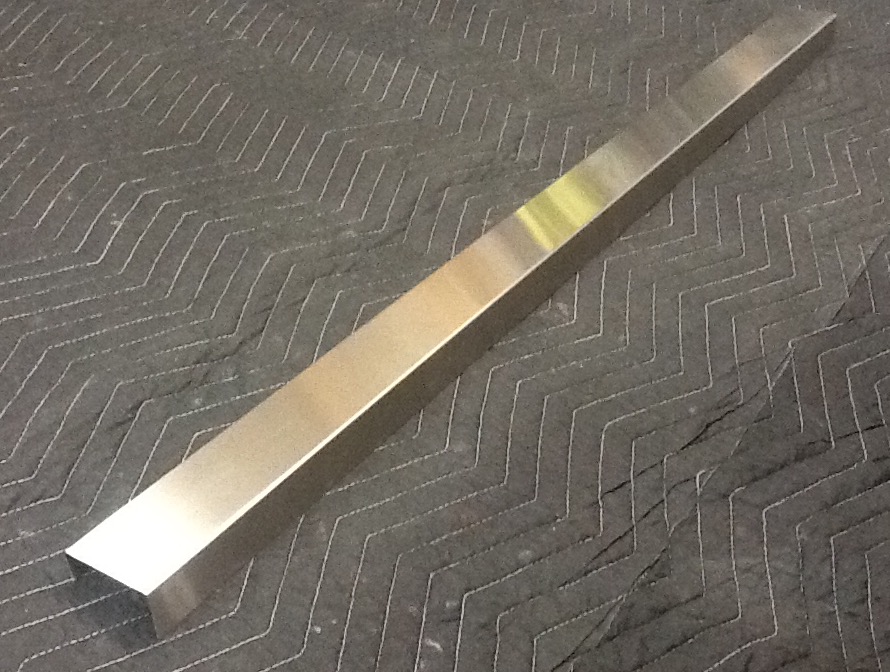

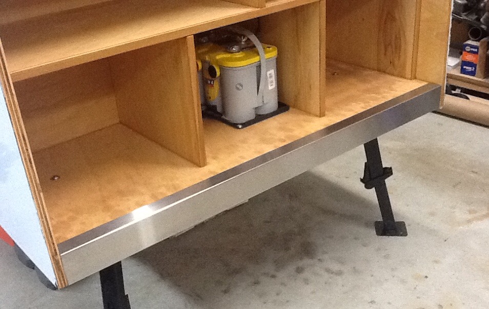

Postby ratrod71 » Fri Feb 26, 2016 11:22 pm

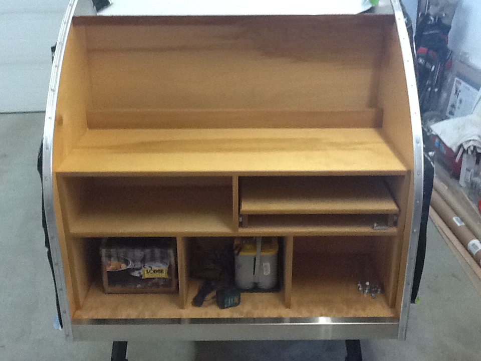

Had a local sheet metal shop bend me up a piece stainless to cap off the rear section.

Postby ratrod71 » Sat Feb 27, 2016 7:27 pm

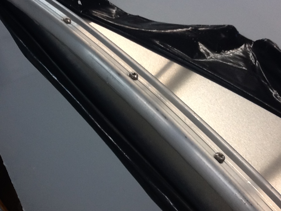

Got the trim molding on all the edges. I used butyl sealant tape under all the moldings, and used stainless screws. Happy building, Bryan

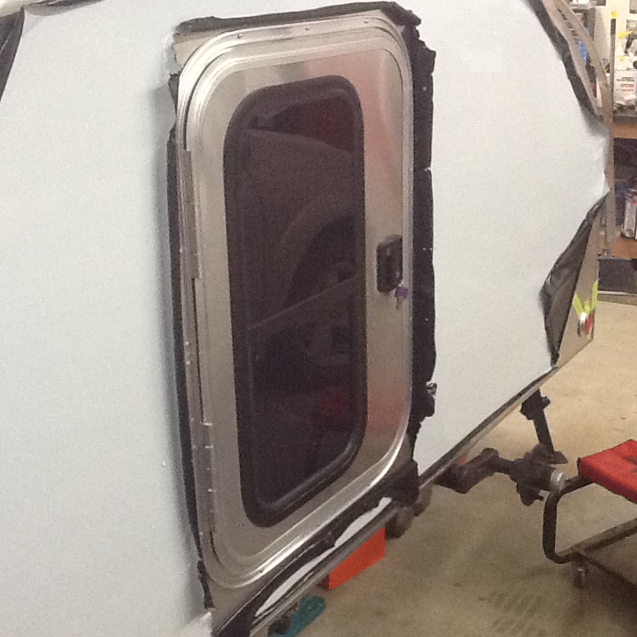

Postby ratrod71 » Sat Mar 05, 2016 4:43 pm

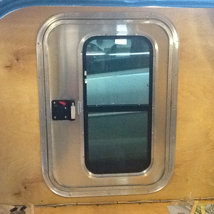

Woo Hoo! Doors are installed.

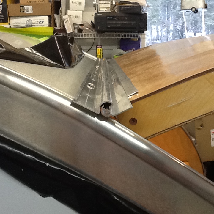

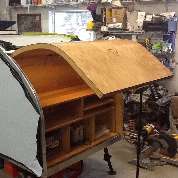

Postby ratrod71 » Sat Mar 26, 2016 1:51 pm

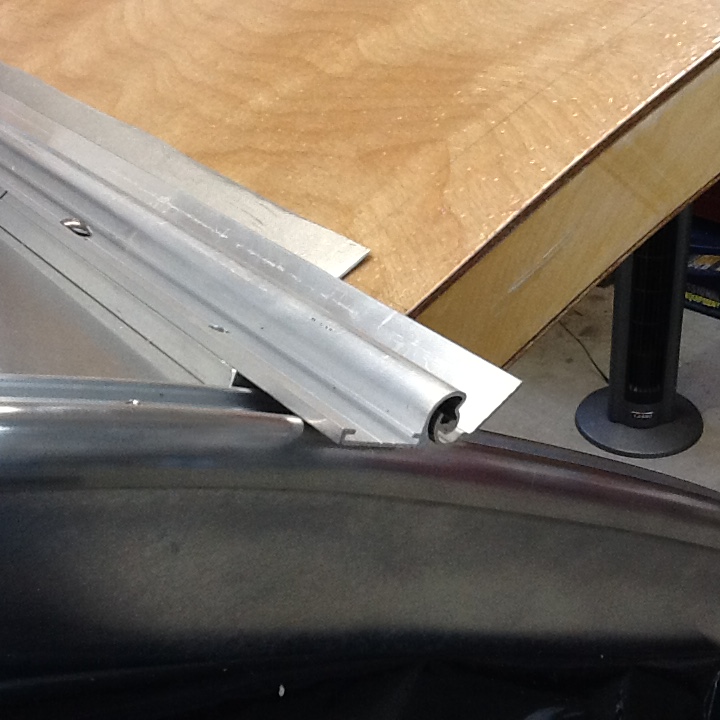

First fitting of the hatch. So far so good. Very pleased with the fit. Using the Vintage Technologies recommendation on the hinge setup. Non offset hinge with a spacer. Butyl tape will fill the edge voids where the hinge goes over the molding. Bryan

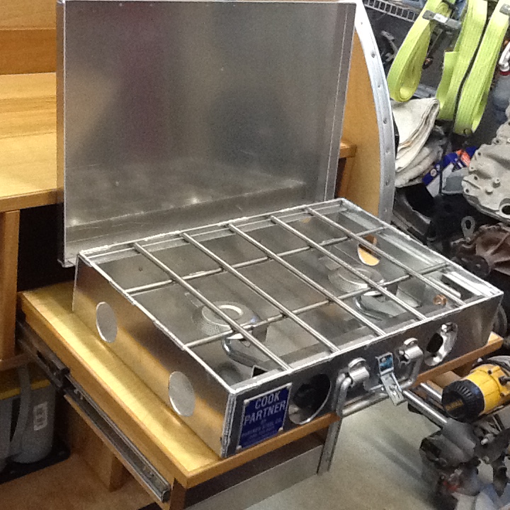

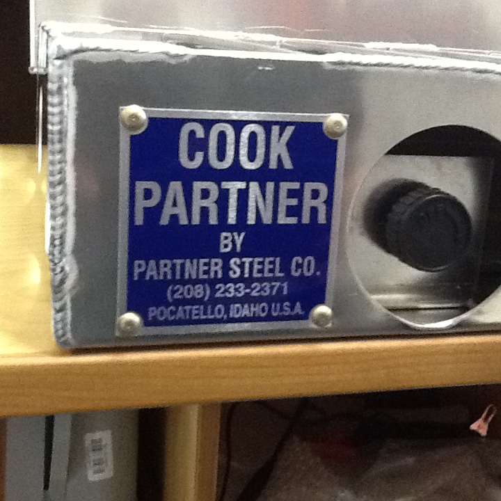

Postby ratrod71 » Mon Apr 04, 2016 10:01 pm

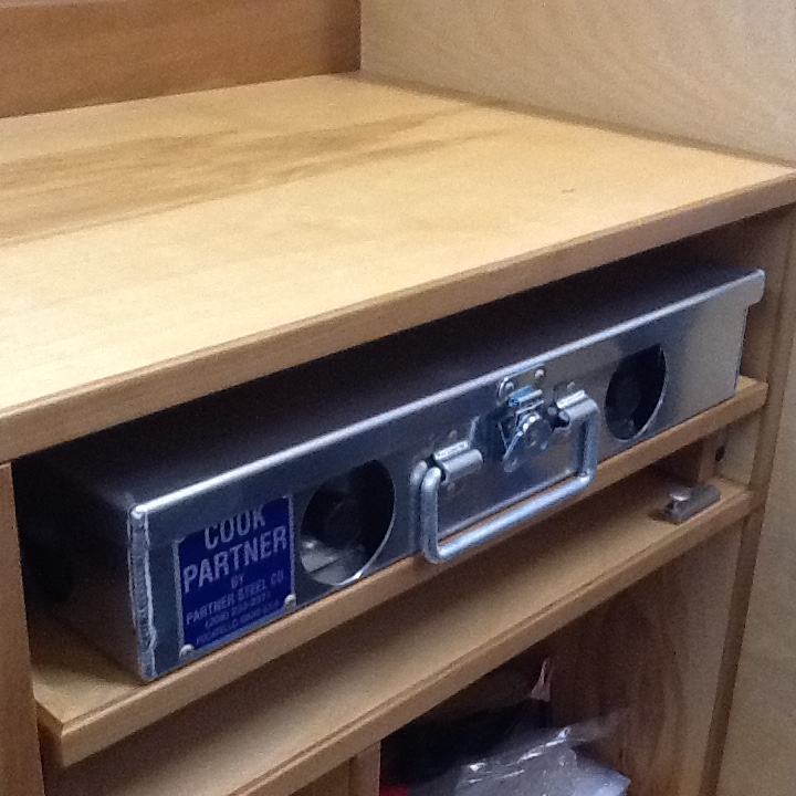

Received the new stove today. I am very pleased with the high quality.

Postby Vedette » Tue Apr 05, 2016 10:38 am
How did you ever resource that stove. :thinking:
Most just get a Coleman or a Camp Chef. ;)

Postby TheOtherSean » Tue Apr 05, 2016 4:14 pm
That stove's pretty cool looking. Is it commercially available, a one-off, or some sort of antique?

Postby ratrod71 » Tue Apr 05, 2016 9:38 pm
I found these stoves by accident in my pursuit of wanting a durable stove that was made well. Partner Steel makes them in Idaho. They have many styles to choose from. They sold me one over the phone and I had it very quickly.
http://partnersteel.com/index.htm
