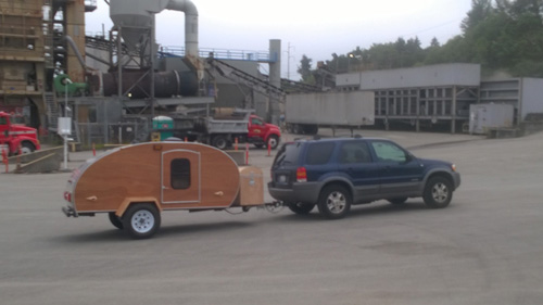

On the final stretch. I have everything operational as legally required by the DOT IMHO. I took I out for its first ride yesterday to get it weighed at the local asphalt company. It towed nicely but I was surprises when my little girl came back at 1900 pounds. I am hoping that somebody had their thumb on the scale because my Escape is only rated at 2000. I took it to the scale empty too.
The little road trip did shake things loose in the galley. I had a feeling that the design was going to put too much stress on the stove door and I did. The road bumps pulled apart some I'd the door face seams on the stove door. So I am redesigning/rebuilding that today.
My little fatty at the weigh in station

I took the girl to get her weighed which was also her first time on the hitch. Towed pretty smoothly especially when I the weight station had her at 1900 pounds. I am concerned about that since my Escape's tow capacity is 2000 pounds. Earlier responses here to that scale result have me less concerned though. The scales probably weigh on the heavy side. I am going to see if I cant stop in at a weigh station somewhere to see if I can get a more accurate read.
The Weigh in and First tow

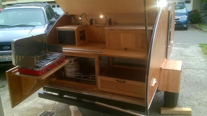

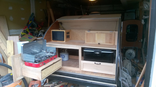

The other concern I had was the galley design and the bumpy ride proved those correct. The physics of how the stove table was built pretty much pulled all the joints loose. So I rebuilt it all day Friday and it is now much simpler and cleaner looking. Plus I think I have more storage with the sliding drawers I bought at Lowes. All in all a better solution is in place.
The original and too heavy design
teardrop galley - img009.jpg (61.38 KiB) Viewed 1145 times
The New Galley
