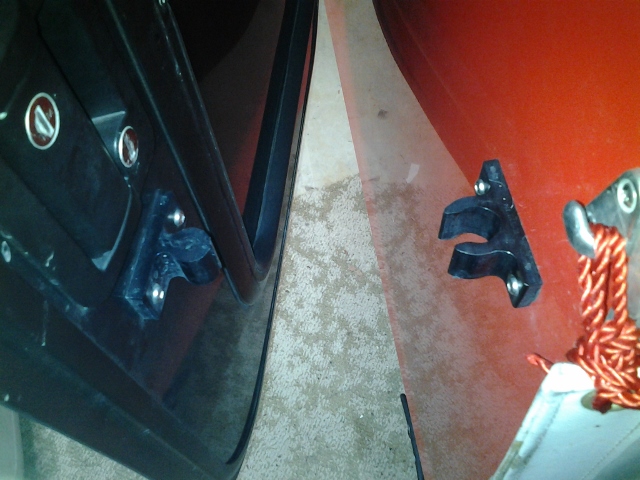

Picture for DaleS.
Door stop on Sleepin Around NZ.
2015-06-03 09.09.51 (640x480).jpg (190.41 KiB) Viewed 1881 times

Nice thanks mate.what is it called if I go looking for one?

Postby Sheddie » Wed Jun 03, 2015 2:42 pm
I have just had a look on google, typed in "rv door retainer nz" and found this one. It is the same thing in white.
http://www.whiteheather.co.nz/rv-parts-accessories/vents-windows-doors/feature.php?id=CT555
Try google and replace the "nz" with "aus" "usa" or whatever is appropriate. Probably come under truck body parts as well.

Postby trailtroll » Mon Jun 08, 2015 7:31 pm
You can find them here @ $6.26 + GST & Freight

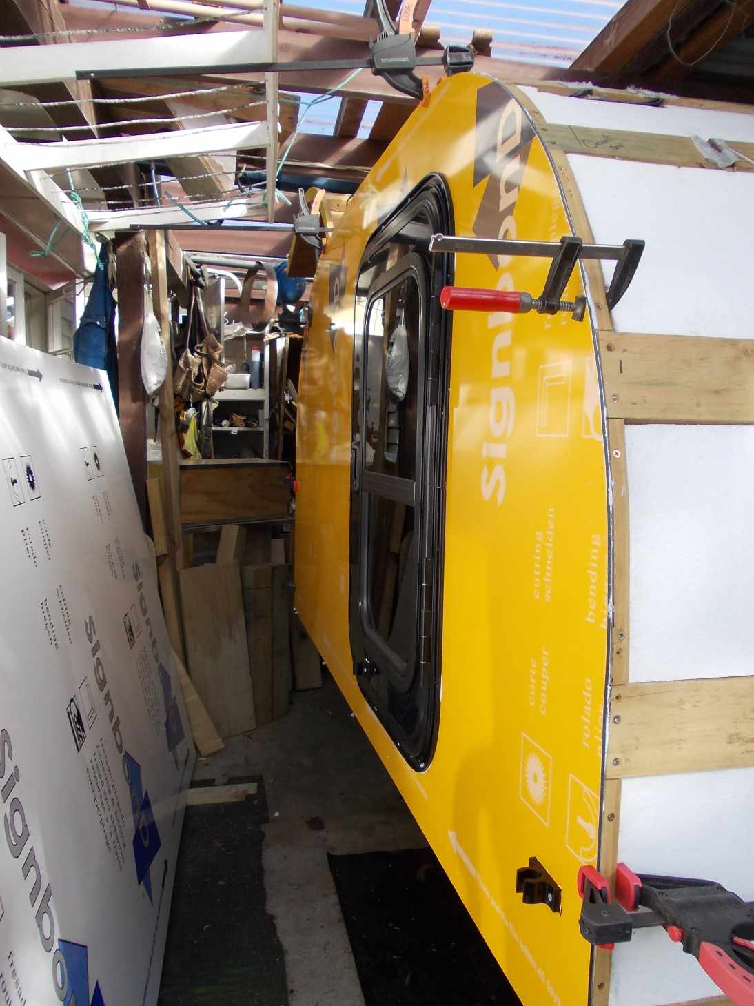

Postby trailtroll » Wed Jul 01, 2015 3:59 pm

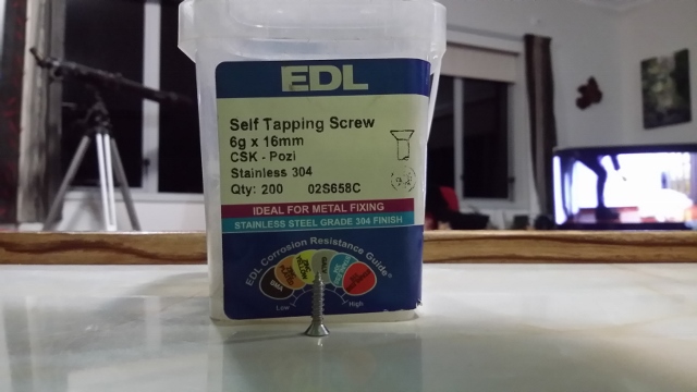

Frank, can you let me know what type of screws you used to fix your exterior panels on with please, cheers :vroom:

Postby Sheddie » Thu Jul 02, 2015 5:27 am
Hi Wayne, on the sides the only screws are the ones holding the door frames, awning lights and galley vents. The sides were glued on with this stuff. It was the one that Ullrich recommended. It works as a glue and sealant.
2014-12-28 10.56.28 (560x315).jpg (71.88 KiB) Viewed 1684 times
The roof panel was glued on all the cross beams and along the edges with screws all around the edges where they would be covered by the right angle alloy trim. The screws are (I think from memory) spaced at six inches. Same screws in the alloy trim spaced between the others.

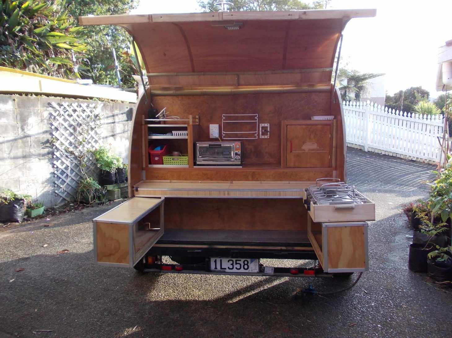

Postby JeffofCT » Thu Jul 02, 2015 6:17 am
trailtroll wrote:Nearly there, the galley is well on the way, just starting the wiring, then the cladding.
:vroom:
Looks like your toster oven is a little off level. :)

Postby trailtroll » Thu Jul 02, 2015 4:31 pm
I have an odd tyre on one side at moment, the other started going flat. The swing-outs are built to slope inwards.
Nearly done, just wiring and cladding.
Interior, with under-mattress support
The Galley

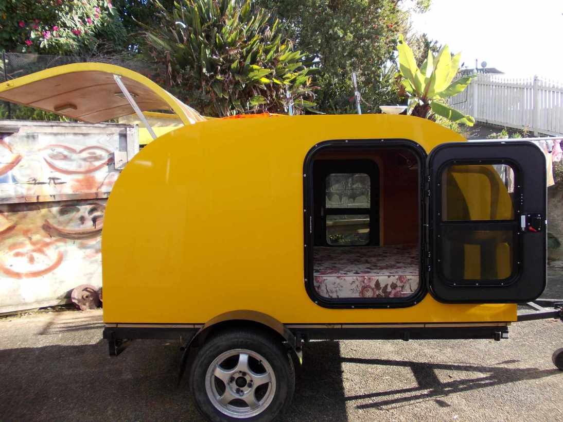

Postby trailtroll » Fri Jul 10, 2015 9:28 pm
The first panel has gone on, yeah! :vroom:
First panel go's on

Postby trailtroll » Sat Jul 11, 2015 11:08 pm
I have had real serious issues with Fix All HG, as we had a couple of real cold mornings after I had glued the sides on and it didn't set, so have had to do some of the edges again.
Got the mattress, it will go in tomorrow, then finish the wiring on top, then the roof panel. Yipee. :vroom:

Postby Sheddie » Sun Jul 12, 2015 5:05 am
Have to keep the clamps on longer. Not long now and you will be finished.

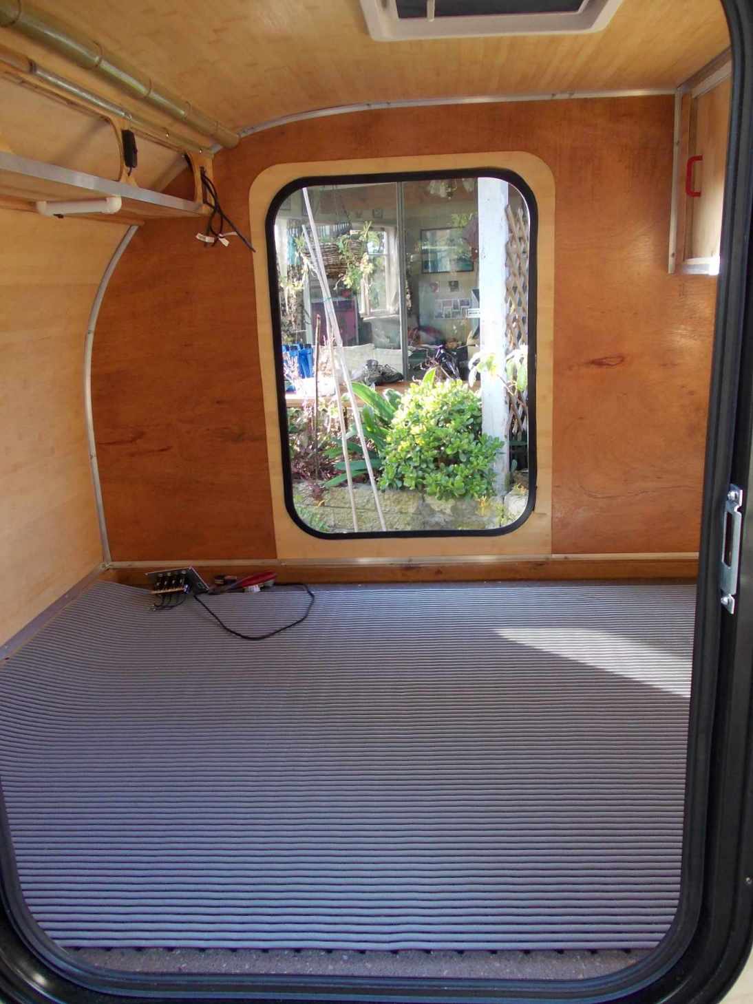

Postby trailtroll » Sun Jul 12, 2015 5:42 pm
The side panel in the sun, and mattress in.
We may change mattress as this one is about 50mm to thick. :vroom:

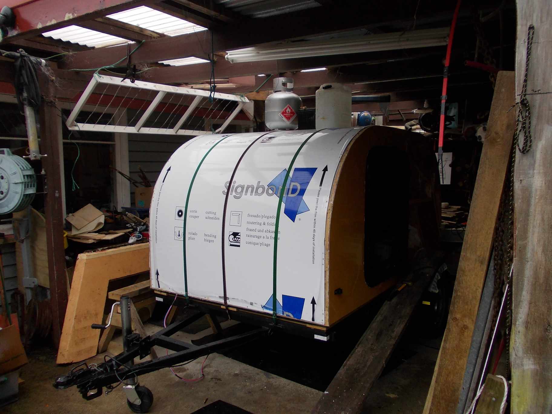

Postby trailtroll » Tue Jul 14, 2015 7:49 pm
The outside is going on, need the weight on top to compress the signboard onto the rafters, and the straps to spread the compression over the other rafters. :vroom:
