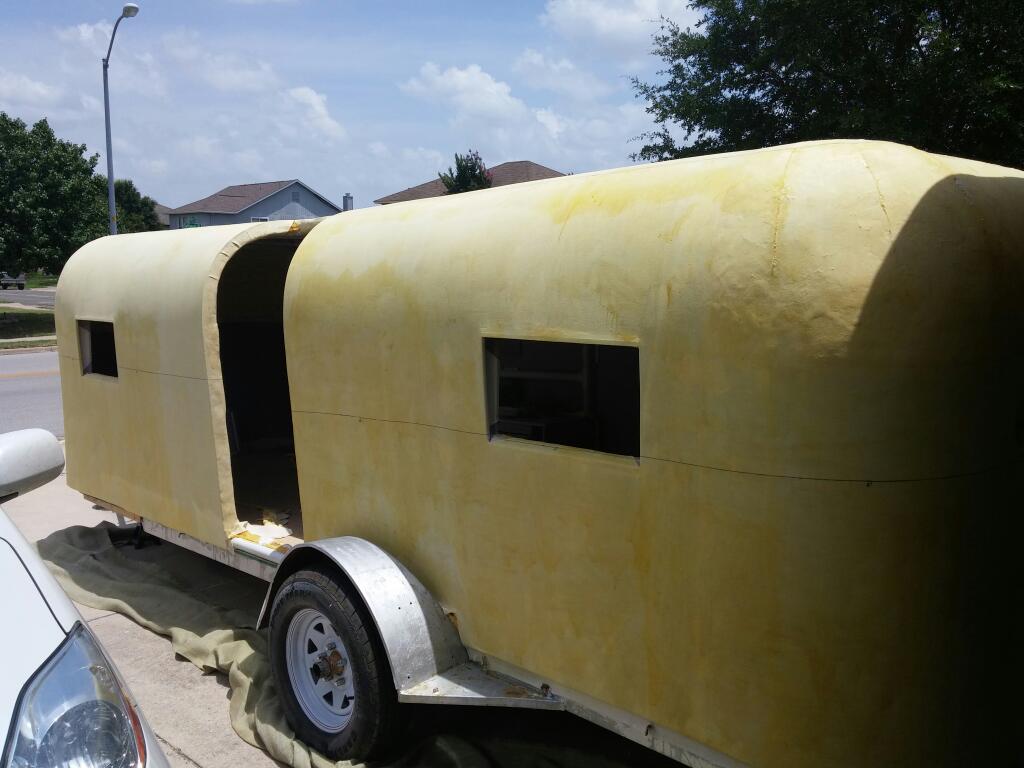

Very impressive canvas job. :applause: Shows every little ding & bump doesn't it ?
Did you join two pieces of canvas to make that 'seam-thing' running about halfway up all the way along both sides or did it come from supplier like that ?

I assumed that that was some sort of tracer thread or pencil mark indicating the center of the fabric.

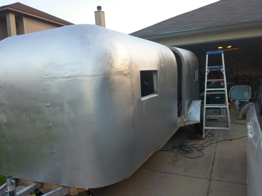

Yea that's a guide line I drew on both the trailer and the canvas to try to keep it straight as I went. It was mostly successful, there were definitely some spots where I got off track a little, but nothing disastrous. Definitely shows every bump! Hopefully the silver paint will hide them a little. If not that's fine. From reading the other foamie threads I knew I would have a handcrafted organic structure full of small flaws. I'm ok with that. I just want to be done setting up the giant family tent!

Fred, I initially used your pva primer & drywall mud combo but found it difficult to sand. I ended up doing the majority of the fairing with straight drywall mud. "Setting type joint compound".
However, for my base coat to fill in the weave I plan to mix some joint compound into the pva primer, since you said it worked so well filling in the weave on the burlap. I'm using 7oz canvas, so the weave is not deep. I figure pva primer should be very compatible with pva glue. I already have the rustolium aluminum paint. I know the rustolium oil based paints take a long time to dry. (I did a rustolium roller paint job on my car 7 years ago) I might be hitting the road with wet paint & have the first camper with horizontal paint drips.

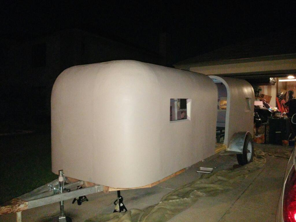

I yet again changed plans based on what I had available and my sense of panic over my looming deadline. The city recycling center announced a big re-blended paint giveaway, so I went down and picked up a 5 gallon bucket to help fill the weave. While I tried mixing some joint compound into one tray of paint, it just made it lumpy and didn't roll on well. So after the glue saturation coat, I went with 5 coats of reblend grey and then put on the first coat of aluminum

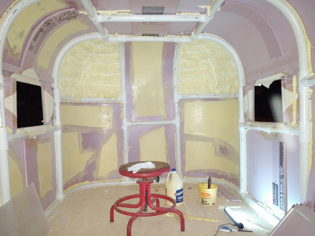

I also glued all my scrap canvas to the panels on the inside. There will be an interior wall of coroplast so this area wont be seen, but I'm hoping it will add some strength to the walls.

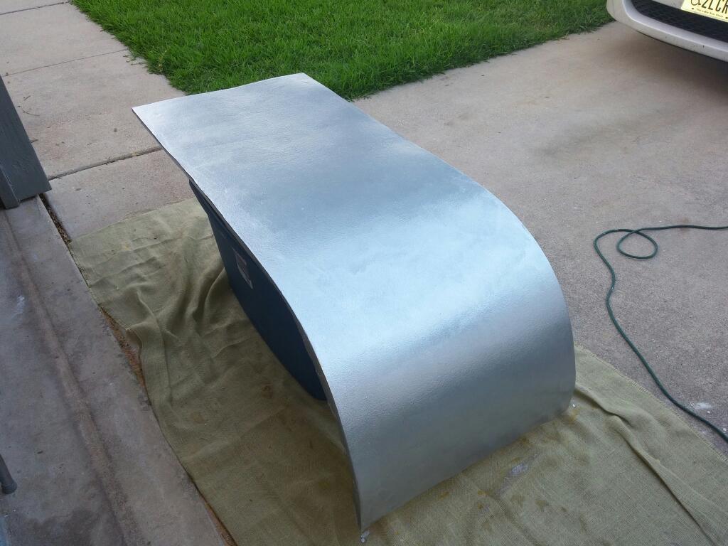

I'm painting the door on a stand so it gets the same coats of paint at the same time at the trailer.
