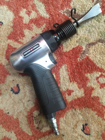

home depot is making way for new products. porter cable has discontinued some items and a result i picked up this air hammer/chisel for 7 dollars ;) no box, as is---
i gave it a test drive and the trigger is good-----not exactly feather control but i can ease gently into the rivet without blasting it....

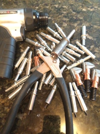

also went to KMS tools and found a suitable rivet head attachment for the air hammer, and a bag of 3/32 rivet place holders (?)

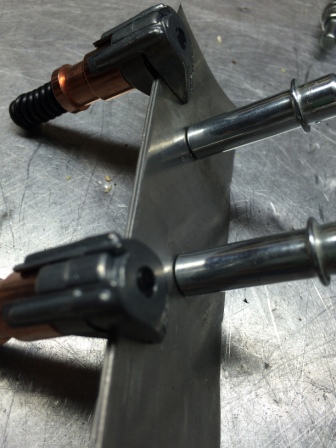

nothing new to report today. pouring rain. spent some time getting reaquainted with where the tools ACTUALLY go and played around --- getting used to the rivetting stuff. re-adjusted the spring on the air hammer to accept the rivet bit and made sure i have my drill bit size down for the holes.

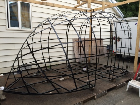

you've all seen it before, but here she is with a fresh coat of tremclad gloss black rust inhibitor. the wife and i used 1" brushes and did the whole thing in a couple of goes today, after i hit the whole structure with a wire wheel. talk about reverberation !!
there are a few more bits to weld around the wheel wells and doors but with the weather the way it is and my upcoming schedule--- today was the day to get her sealed up. i'll grind the paint off when needed.

i THINK i will be doing the wells next, then a few floor tabs here and there for perimeter support. after that it's time for a layer of 1/4" ply. the floor i can get in the door later. once the plywood is up and sealed , then i don't need to worry so much about the floor getting thrashed on by the sun and rain :beer:

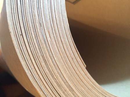

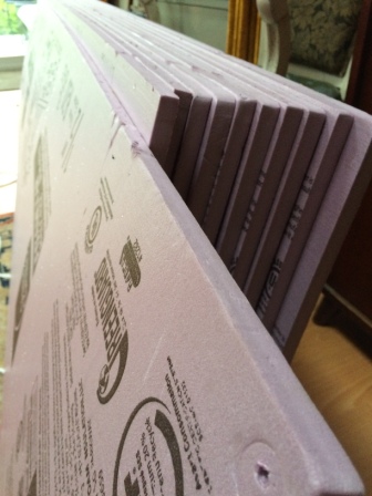

after some poking around the forum, and playing with some 1/2 " foam i had at home, i think i shall take a leap and abandon the plywood underskin concept, and use foamular. the foam has incredible bending properties, and takes a screw and washer quite nicely---allowing me to countersink easily. also very easy to cut and weighs virtually nothing. and is 12 dollars cheaper per 32 sq.ft !! after comparing the two, i know the plywood will hold a screw better, but at only 1/4" it will be harder to get all the screws flush, so they don't ghost through the aluminum. the larger sheet size of plywood is a plus but 28 dollars per 32 sq.ft vs. $16 per 32 is substantial. the foamular has a superior bendability, and is easy to cut.

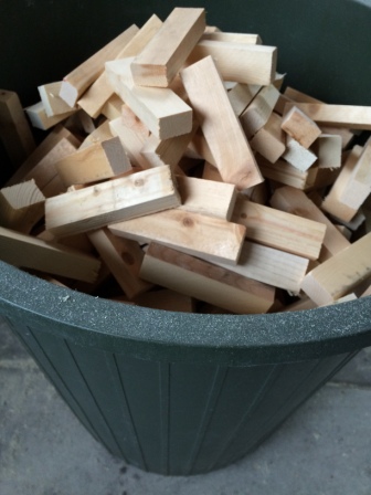

it rained all day today so i spent time in the shop and cut about 200 feet of 4" chunks of 3/4 x 1, from the 'dry-dock' 2x4's. the plan is to glue them all over the inside edge of the ribs before i attach the foam to the outside. 4" is the lowest common denominator in length that will get me through the curves, so i just made'em all the same

Postby OP827 » Tue Sep 01, 2015 12:19 am
Do you have a little sketch or drawing to show how your wall structure sandwich is going to look like with the steel frame, aluminum skin, rivets and then the foam?
OP827
Posts: 1596
Images: 414
Re: go ahead, call me crazy !
Postby WoodSmith » Tue Sep 01, 2015 7:15 am
+1 on the above, I'm now a little confused. I like the look of what you have so far, but I'm having a hard time figuring out what the wall structure will be. And I am completely in the dark what your bucket o sticks are for.
