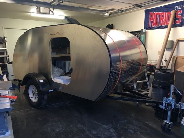

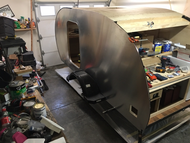

Well now it's time to finish things up the outer skin is completely done and sealed. All the trim is in place I'm still waiting on a few parts from the powder coated but for the most part everything is done. I still need to order the door Windows before I move on to those but hopefully that will be next week.

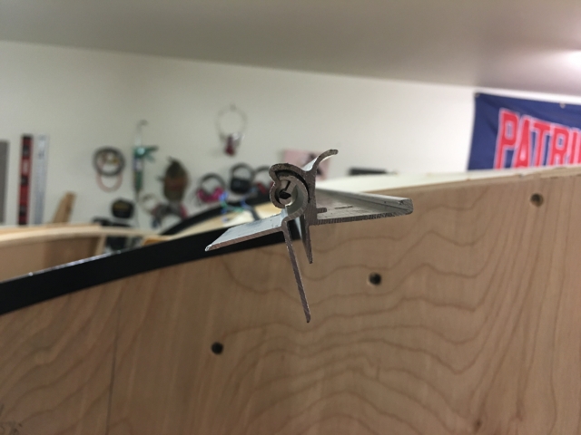

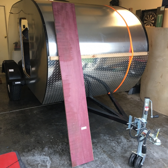

I got the Purple Heart molding made up and I'm pleased with how it came out. I bought some quarter sawn wood from Woodcraft, it felt good to do some wood milling work again I haven't done that in years so I think when I go to do the cherry interior I will do the same thing.

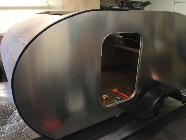

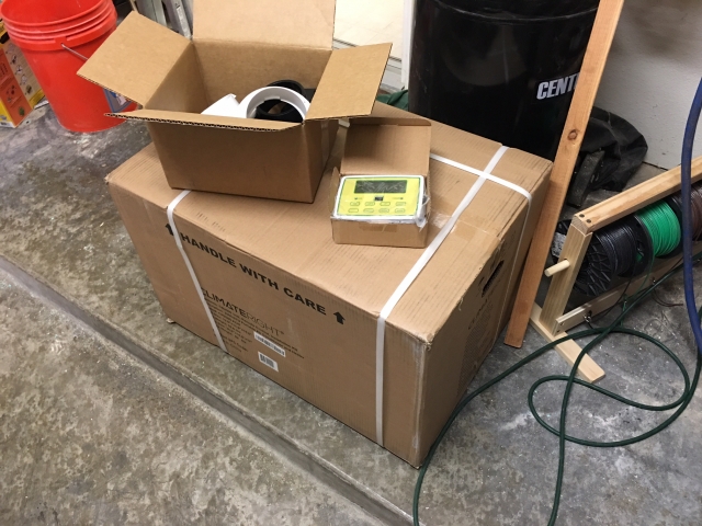

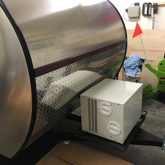

I mounted the climate right upfront for good also I just need to build the box that will cover it and house all the accessories inside. But that will be in the coming weeks as things start to wrap up.

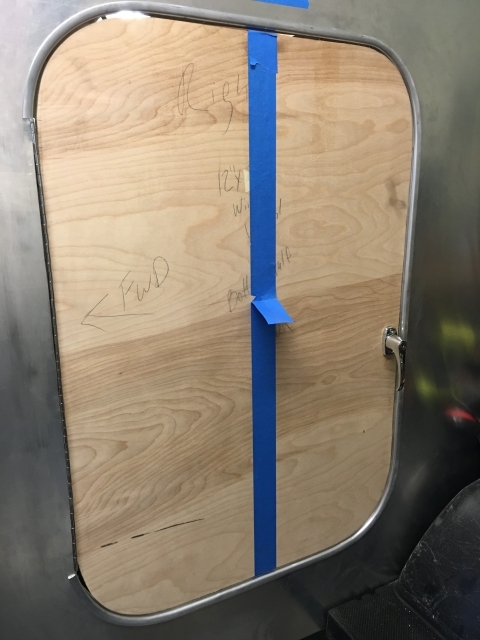

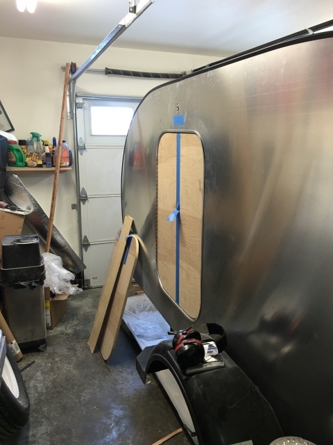

I also have thoughts about adding Windows just aft of my doors to add a bit of light inside but that's still up in the air.
I am having some real doubts about installing the stargazer widow, I don't have the 9" of space need for a flat surface to mount the window. And I really don't want to cut into the aluminum and find that it isn't going to work out so maybe I will just leave it out for now till I can find some way to to make it work.

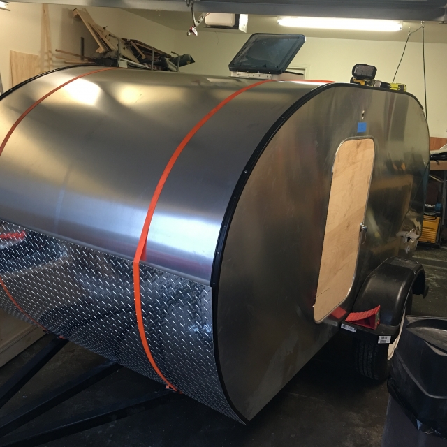

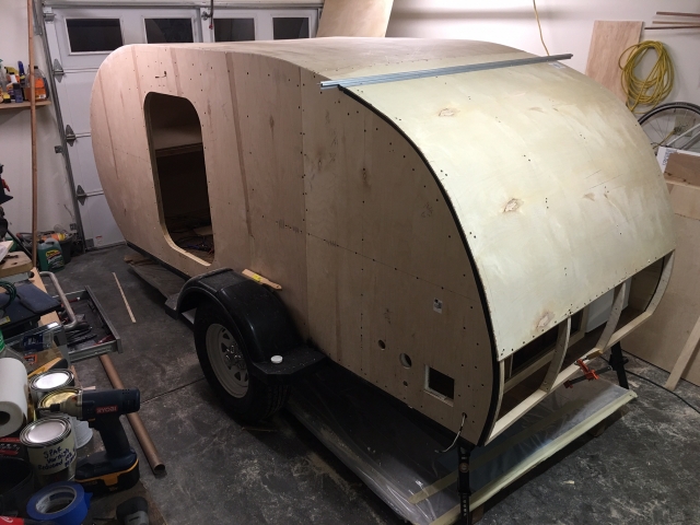

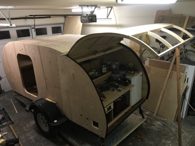

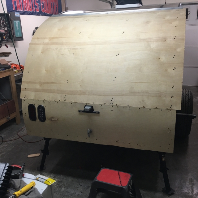

I started the work on the hatch I had some issues with the first one that I wasn't to happy with mostly due to my own accord and some of the unknowns, but in a nut shell I have to discard the old one, becasue it wasn't square when I put it on the hinge also I didn't know that the plywood would spring out so when the plywood was screwed in it was trying to pull the hatch framing flat. Which then caused my curves to not sit right so I called it and just started fresh. I'll post some pics of what I did later on.
But the second time around I made the skeleton a little thicker and also put some braces inside while I was forming the plywood skin, basically I over pulled it so that when the plywood would pull back it would have the correct curve to match the galley.

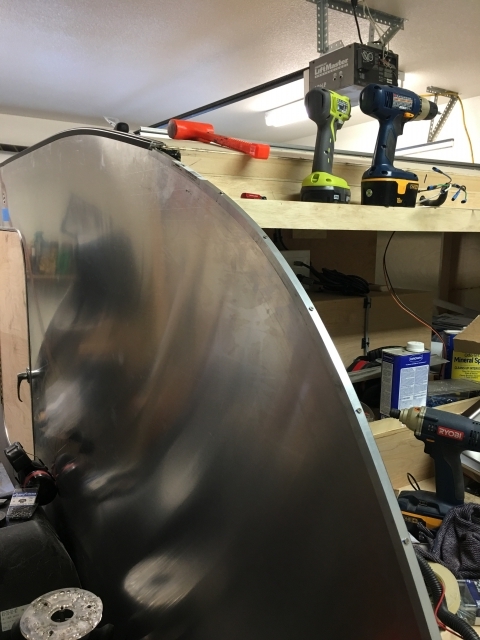

As you can see I have begun to mount the tail lights I just need to make the patterns and match it for the other side.
