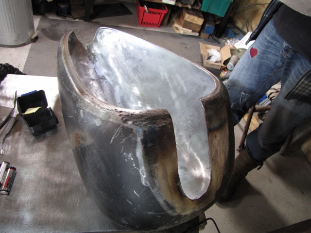

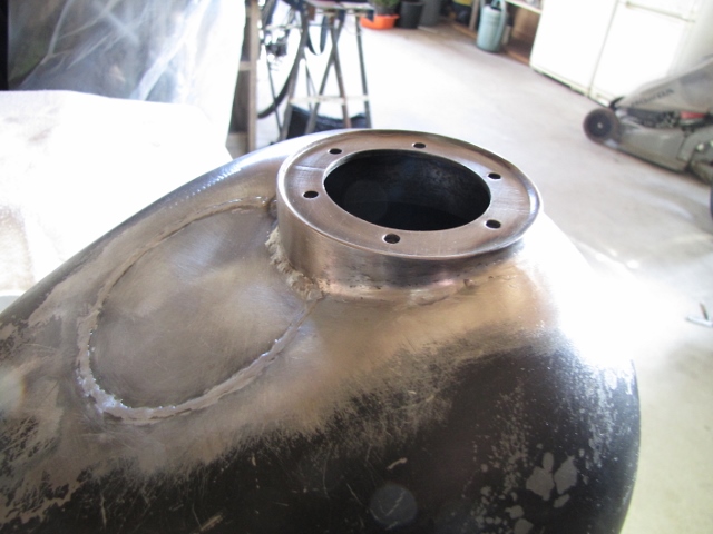

Thats what you get when friends know you are able to Tig weld stuff....
One of them asked me if i was able to do a rebuild of the gastank of a Harley Davidson.
Uhh, sure...
However those biker boys have no idea how much time and effort it takes to completly rebuild, retunnel, and buttweld a new bottemplate in an existing gastank, re-arrange the complete fillercap part, re-arange the petcock and make and weld in new mounting brackets....
So it took some sweeeeet time, sweat, effort and @#$%%&*@@ language to get it all done,
and i have to say i learned a lot, particularly about buttwelding stretched steel plate , material thickness, and weldersettings.
In the end it worked pretty well.
Oh yeah, and NO GAS LEAKS!
(Oh, and that is NOT my Jeans in the picture, but probably "biker boy's" girlfriend "marking her territory" with that patched little red hart on his Jeans.) :lol:
To give you an idea of the result, here are some foto's, if you want to know more, just ask.
However since this site is about teardroptrailers, i will continue.

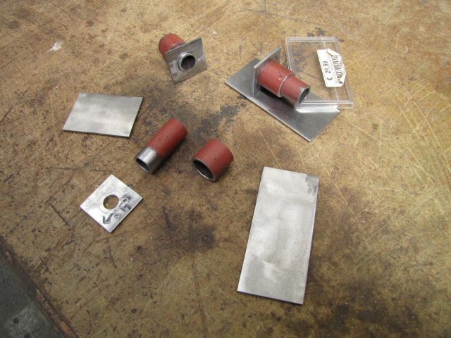

Not that easy, but the challenge was if i could design and create them myself.

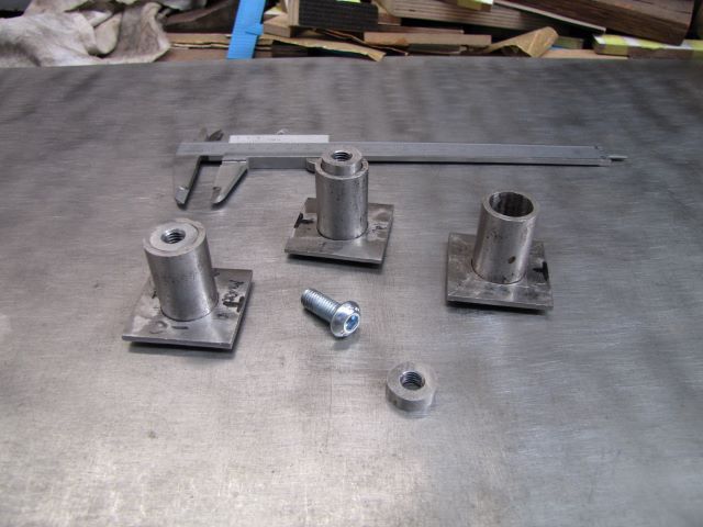

Therefore i used 2 sizes of scrap gaspipe witch fitted pretty well into eachother, and some about 3mm thick strips of scrap plate.
From there i created the pivotpoints for the hinges.
IMG_2252 verkleind voor tnttt 4.jpg (60.96 KiB) Viewed 1754 times

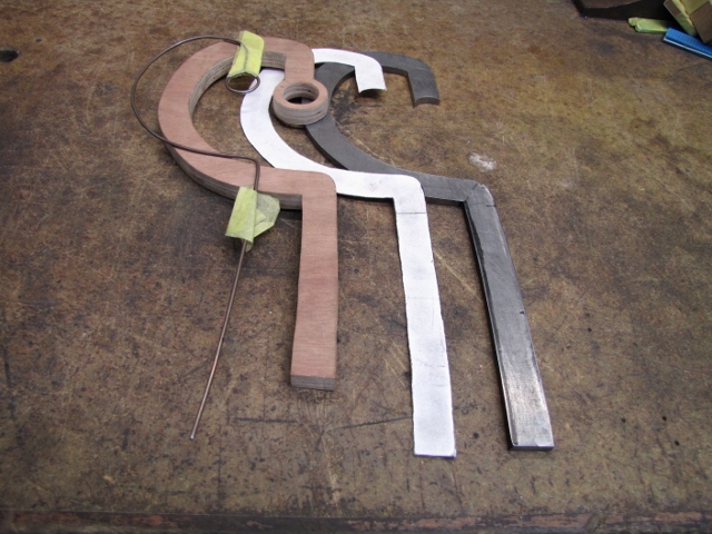

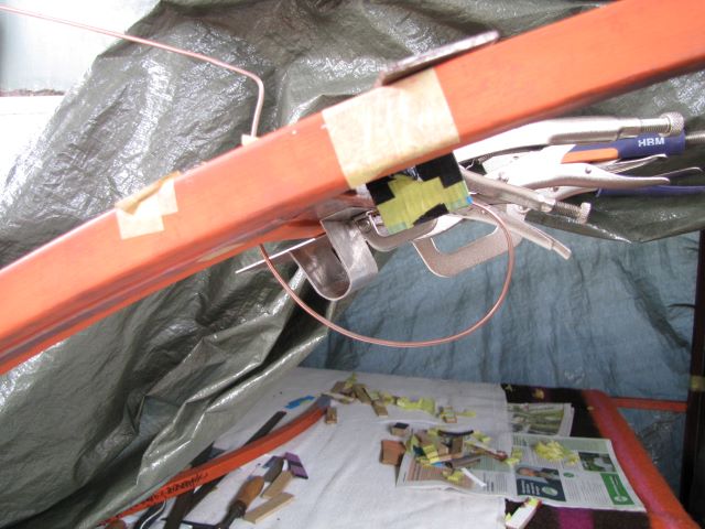

Postby smeerkees » Wed Oct 25, 2023 3:27 pm

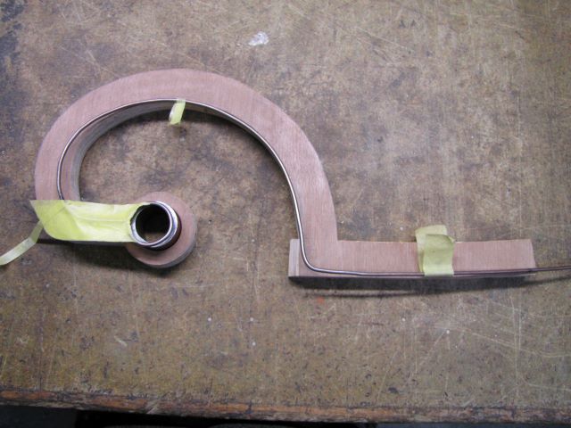

From there i took a piece of Tig welding rod to "shape" the bracket like i wanted it.
Remember i had to go around the "water gutter" witch is also not yet designed.
However i think i am pretty close here.
It took some sweet time, and you have to keep in mind a lot of things when "designing".
Like for instance how deep and wide make i the "watergutter" system,
How can i disassemble the complete hatch easy if nessecary.
You want to weld as little as possible on the bended frame tubes because of heat distortion.
You can "design" something but it must be buildable too.
And I wanted it to look a little bit nice too.
From the beginning to the end i changed several (mainly small) things in the "design".
Oh yeah prefably problably 3 hinges. This is easyer when disassembling the complete hatch, however only possible when nearly 0 (zero) distortion and play.

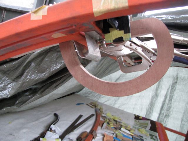

Postby smeerkees » Wed Oct 25, 2023 3:39 pm

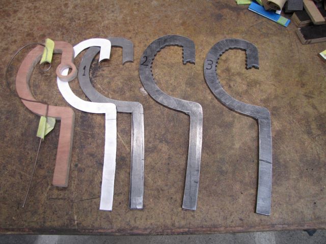

From there i made the complete bracket in wood on the real size.
Some of the dimentions are critical, others a little less
On the foto the actual pivot tube is used.

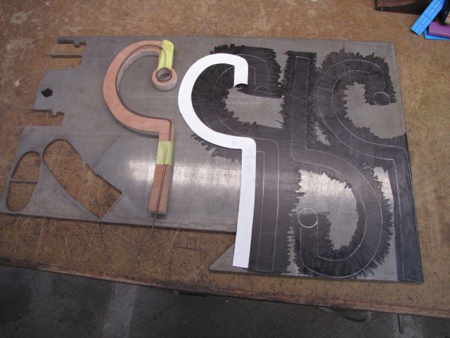

Postby smeerkees » Wed Oct 25, 2023 3:58 pm
From there i copied the wooden testbracket on a 6 mm thick steel plate, and even here i made some small design modifications.
Oh Yeah times 3.
IMG_2544 resized for tnttt 8.jpg (49.51 KiB) Viewed 1741 times

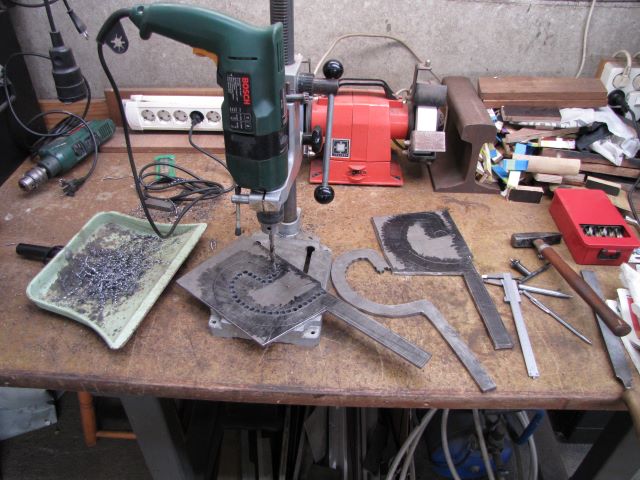

Postby smeerkees » Wed Oct 25, 2023 4:04 pm

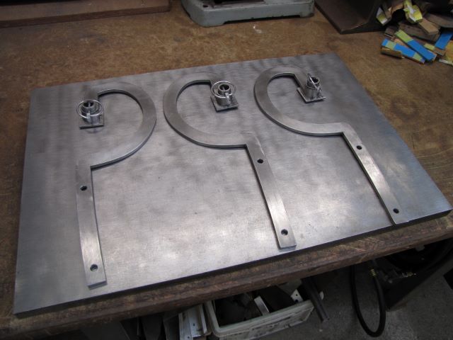

Since i dont have a cnc machine, a plasma cutter, nor a acetyleen cutter,
from there a lot of grinding, drilling, fyling, and shaping.... uh yeah........ :fb
IMG_2589 resized for tnttt 9.jpg (66.74 KiB) Viewed 1748 times

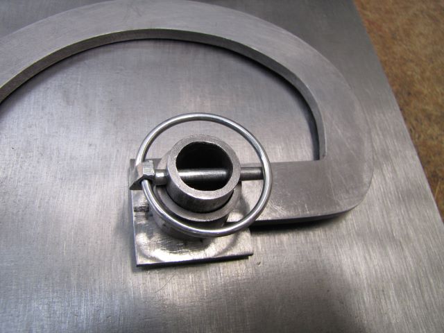

Postby smeerkees » Wed Oct 25, 2023 4:32 pm
Close up of the safety pin system.
