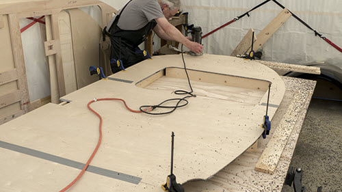

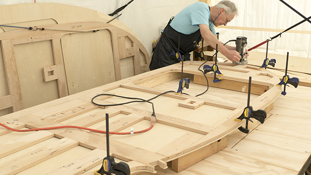

This is trimming the plywood with a router trim bit.
route wal 2.jpg (205.51 KiB) Viewed 3674 times

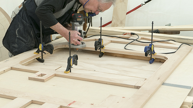

Trimming out the door opening.
Route Wall 1.jpg (184.6 KiB) Viewed 3674 times
And finally a fit test of the walls! This is a big milestone and I'm really excited with how well they fit :D
Wall Test.jpg (190.13 KiB) Viewed 3674 times

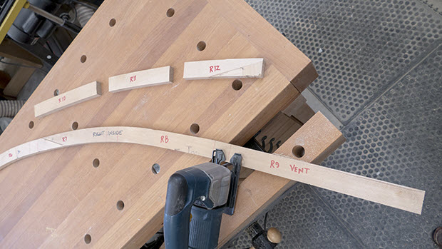

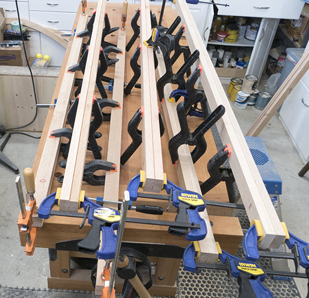

It's been a couple more days and I've been working on the roof trusses. I've got the roof trusses all glued up. They are 1 1/2" X 1 1/2" made up of 3/4" thick mahogany.
I'm just glad that I've got lots of clamps!
I cut down the piece I trimmed from the top of the core to make truss spacers.

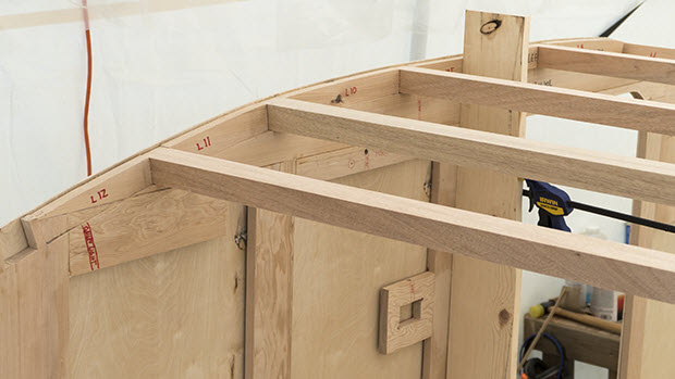

Here's a shot of the truss spacers and trusses being test fit. I think they are going to work great! They will go on top of the 1/8" plywood ceiling.
trusses 2.jpg (40.42 KiB) Viewed 3607 times

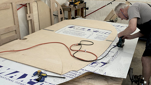

Day 23 consists of two days. The first day I dove off island to pick up the Dibond that I'll use for the outside wall covering. Then I picked up four sheets of 1/2" Baltic Birch plywood for the inner wall and some of the cabinet structure.
The next day I rough cut one of the sheets of Dibond with my scroll saw. It took a few tries with different blades to find one that cut fairly smooth. I traced around the pattern with a Sharpie and then moved it aside to make my cuts.
Once I had the rough cut done I put the pattern back in place and routed around it with a flush cut router bit. What a mess it made. The cut was perfect buy my shop was a mess. The black plastic inner core of the Dibond just came off in tiny pieces you can see on the plywood and floor.
As soon as I get the second side cut out I should be ready to start laminating up the walls. It sure is getting exciting now :D

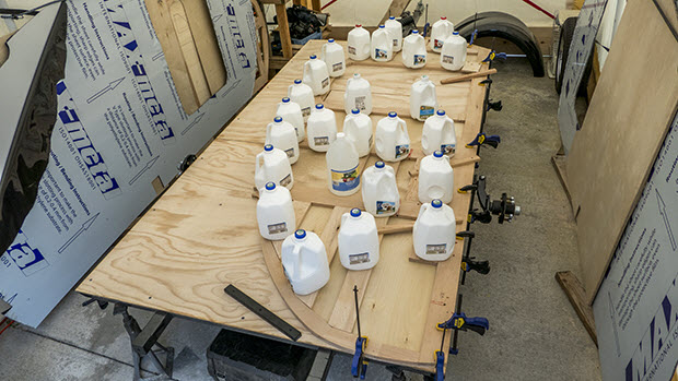

I finally started putting the walls together. I started with the inside skin first. I spread PL glue all over the core with a notched trowel and then put it on the birch plywood.
Since I drink a lot of milk and saved up a bunch of milk cartons that I use as weight clamps. I do believe they will do the trick.
wall skin.jpg (77.58 KiB) Viewed 3456 times
The adhesive has a 24 hour clamp time so won't know until I check it out this morning.

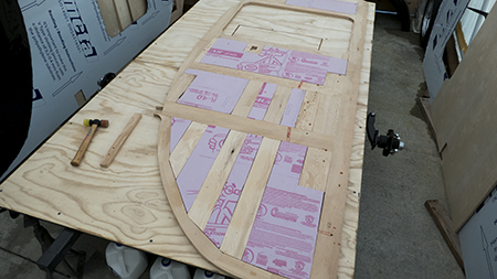

Today I glued in the rigid foam insulation and I think it turned out great.
I cut groves in the foam to run my electrical wires to my light switches and tail lights. I laid in some heavy string and tied a labeled washer to each end. That will identify each string and prevent it from pulling back through any holes. Hopes are high that it will work as planned.
Next up, glue the outer plywood on and then glue the outside "Dibond" skin on.
