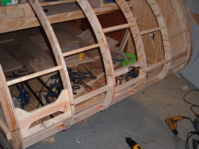

Seems I've finding my way out of the woods with fitting these hatch ribs.
Finally got the hatch ribs 95% dry fit and ready to install. I say 95% because there is a high spot or two. Going to run the straight edge over it a few more times when frame is glued up and completed, then touch it up with the belt sander where needed.
So I have all the hatch frame apart again today to hit most of the galley frame work edges with the router and a 1/8 round over bit. Plus doing much of the final sanding of all those parts too. I won't be skinning the inside of hatch so I want it to look decent when open. So I spent some time to detail it up a bit with the router.
Got the left side inner galley rib glued, clamped and stapled to the outer rib and weather strip channel. Ran out of clamps and had to wait a bit to do other side. Cut the piano hinge for the hatch and rounded the corners off the hinge overhang. Headed back out to the shop again to take the clamps off that rib and assemble the rib on the other side.

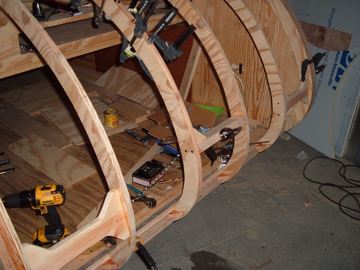

I'm still sloggin it out on the hatch frame. The rib with the clamps on it was still a tad low. So I have a thin strip glued in place. Final fit on that rib when I get home from work today. I've got the rest of the ribs on the money. I've straight edge checked these suckers every 4" all the way down the curve. Right on target. So I've got it handled but it sure was a long road to get here.
Otherwise it's been going pretty good. I went corner glue block crazy with the frame and ribs. It really stiffened and solidified things. It's a big hatch. 5' wide and just short of 5' long. So I want it as rigid as I can get it.
Have had a bit of fun though. I got my hatch spring bolts and locking T handle dry fit. Works like a champ. I was so happy with it I must have turned the handle and locked an unlocked it a zillion times. Probably need new parts already. May have worn these out. :lol:
So after I fit that last rib today, it's on to the rest of the cross bracing. That should go pretty smoothly.

Couldn't cut all the ribs at once. Don't have a saw to take six pieces of 3/4" material in a stack. However I did stack them all together when cut and shaped them on the skin surface to match as a set. The rib shape was not the trouble.
For me the problem came when attaching the ribs at top and bottom of frame. Even though I clamped them in place, and trued them up, they shifted slightly when glued and screwed to the frame. You could see them draw up a bit when the screws hit home. That's all it takes and you are off the straight edge somewhere in the curve. Plus the drew up a bit at the top and bottom when screwed in place.
It's not like its way out of whack. The one rib was off just a tad less than an 1/8. So I glued the strip and will sneak up on it with the belt sander. Just took some additional TLC to get it right again. I don't see where I may have operational or twist trouble at all.
I think once I get all the cross braces in and it's all framed, I'm going to attach the hinge and free it from the sidewalls, and open it up. I think I'm going to start working with the gas lift supports before the hatch is skinned. Need to measure open lengths and look at attach points etc. Because of the sharp curve at the tail of the hatch going to have to lift it high, to get 6+ feet of headroom under the low point of hatch.

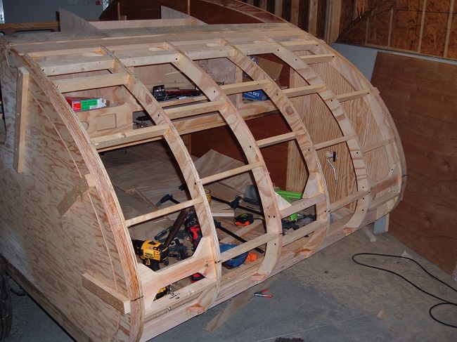

Well it seems I caught a lucky break with fitting that last rib. Took off the clamps and checked it with the straight edge. It was spot on in all but 2 places. I lightly hit those 2 spots with the belt sander. Bam! It was right on the money with its neighbors. All the way through the curve. Don't think I spent 3 minutes total on that final rib fit.
So that gave me time to work on cross braces. Got 2 rows in all the way across. Doing a staggered box pattern. It's coming out real rigid. Getting real strong with each brace I add.
Not bad progress for a hot and muggy session after work.

Without a skin you will probably find that your hatch frame is quite flexible in a twisting direction (bottom corners lifting unevenly relative to hinge line). My advice would be to only lift and prop directly in the middle and to do it carefully. It might also be a good idea to take a couple of narrow strips of thin plywood (dropped scrap pieces would do fine) and temporarily screw those on a diagonal 'X' to the profile (from top left to bottom right, and vice versa).
My hatch is fairly large with larger radius than yours; I have 4 deep ribs with minimal x-bracing, an exposed "inner" skin of 5mm ply on top of that (similar to your outer skin), 1-1/2 thk foam, and 2 plies of 6oz epoxy/FG outer skin. Before I added the foam and outer glass it was fairly flexible to twist; afterward not so much.
Re: Kenskill style build in Delavan, WI (Now Cub Modern)
Postby Mr. Lahey » Fri Jun 29, 2018 4:29 pm
Thanks for the heads up KC. I think I'll just leave it in place. I can still wire it where it is. Since I still don't have the ceiling in place I can still see into the galley through the upper cabinets. So I can watch the hatch struts from there once the hatch is skinned.

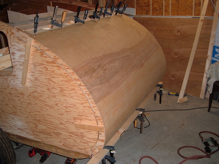

Got the big part of the hatch skinned today. Was very glad my girlfriend was here to help. The job just takes more hands than one person has.
It's skinned with 3mm birch plywood, PL adhesive, and stapled to ribs. The whole bottom edge I ended up screwing to the rail with 1" construction screws. The curve is a tight one. Plus it's a short distance from the high spot of curve to the bottom rail. A lot of leverage there from that short distance. The force wanted to rip the staples through the plywood. Screws did a much better job.
So after all the fuss fitting the ribs I'm happy with the results. You can sight across the hatch and it's not wavy, or shows any low spots. Just a nice smooth curve.

The ply skin looks like it took to the curved shape. I can concur with the wishing for more hands when you need them. Specially when I have to line something up and the glue is setting . I had something similar when i put in the interior walls and some of the 1/4" crown staples wanted to bury to deep, :thumbsup: almost going through ply in spots. I used PL 300 and it did allow for some time to line up but it also was skinning over in a short period of time. I actually picked up a wide crown stapler for doing the roof and hatch skin. I'm not a 100% sure I will use it in that process yet , i'll have to do some more testing. I spent a full day on the teardrop . I finished putting in the double roller catches in the interior cabinets and then moved to the galley cutting some more pc's for the cabinets and milling some hickory for the upper face frame. You must be ready to attach your hinge.
