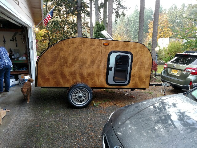

Mounted!

Fenders mocked up.

So I planned for my 10ft long cabin to rest on a 9.5 foot long trailer frame. The intent was to place the axle where I would have 3 inches front and back overhang. The thought process was that I could always adjust forward or back up to 3 inches either way to create the perfect tongue weight.
I ended up sliding the cabin forward 2 inches from centered. Adding to the tongue weight. With some weight loaded in the galley and the mattress in the front I have 125 lbs on the tongue. That will go down a bit as i add about another 50-100 lbs in the galley. I should be right at about 100-110 on the tongue when loaded for camp.
Also, 6x 3/8 inch carrier bolts with 2 inch washers are holding everything together. Just about ready for the road!

I sealed all the trim with a light bead of silicone. I did the soapy water trick and left just a tiny bit as an extra precaution against leaking.
Next on the agenda is working up the trailer lights so toucan take it to a tire shop this weekend and get new rubber. The tires I currently have from my old used home built cargo trailer are from 2001! They are 215/70x15 on 6.5 inch wide Lincoln alloy wheels. I plan to out on narrower tires at 195 but am not sure on the sidewall height. If I go 195/65 the tires will be nearly two inches shorter in total, lowering my trailer almost an inch. I like this idea because the trailer is just a touch high right now. However the downside is that I will loose an inch of ground clearance and I don't want the tires to get so small that they look funny inside my Fenders or on the trailer.
Thoughts? Current tires are 26.9 inches tall, these smaller ones are 25 inches tall. Seems big enough for a tear still?

New tires are on. 195/65x15. They are the perfect width for the wheels and look good. They lowered the trailer just shy if an inch. Making the door entry easier to sit at.
Spent this last weekend working up 12v and 120v. 12v is complete. Well campable anyways . One more 12v plug to add I galley later. 4 circuits total. And a noco genius to keep the grp 24 battery topped off.
I am one gfci away from having 120v wired up in the galley and cabin. 15amp breaker in from a shore power.
input.
Fenders are painted and installed. I used some rust conversion primer because the original paint job allowed some rust to form on the root edges of the Fenders when the trailer was driven across the state. I sanded as much off as possible the used the conversion primer before a few coats of glossy black to match all the trim.
I snapped two lag screws trying to mount the fenders. Ended up missing with 5x 2.5in kreg screws. I will predrill and add two lag screws to the mix once I get some new ones. The Fenders are solid in the meantime.
Exterior is completely sealed. I need to put some vinyl insert on the driver side trim still.
Oh, I also need to install the tongue jack. I ahve a weld one one that I can't do myself. I have a clamp on style one that is on my cargo trailer. I plan to do a shakedown cruise this weekend so I will toss on the clamp style tongue jack for now...
That's all for now. Camping soon!
