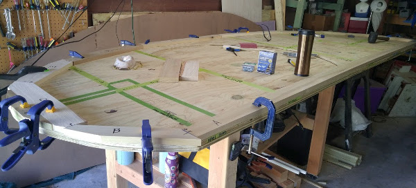

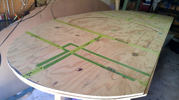

Today I worked on framing the wall. I used light green tape to mark where all the studs were to go. Then I cut all the pieces for the frame for one wall and Kreg-jigged the outside pieces. I still need to drill and screw the inner pieces, but they're all cut and in place.
Once I've got them all screwed in, I'll use my bottom-bearing router bit to trim the edges to match the profile. Then I'll remove all the tape from the wall, unscrew each frame piece one by one and glue + screw them together and to the wall. Then I'll apply The Mix to the wall/frame combo.
..and then repeat with the other wall.
The mitre saw really earned its keep today, as I cut all kinds of crazy-doodle angles to fit rectangular pieces of wood to a curvy profile. I'm also rather proud of some funky cuts I made with the jigsaw where some of the vertical studs met blocky, irregular joints at the top. They're not perfect, but they're pretty darn snug.
The other thing I did that I'm proud of, as I thought it up myself, was to draw little lines that perpendicularly crossed from one piece of wood to its neighbor. This way, even when I unclamp, unscrew, or move a piece of wood, I can line it back up in its original relationship with adjacent pieces.
Here are the taping, half laid out, and final products:

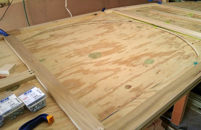

I got a little more work in last weekend--finished screwing together all the crosspieces on the frame of the one wall, and I did something I've been meaning to do forever, which is adjust the shape of the door a little.
It's always looked like it curves a little too steeply at the top right corner, so I used a piece of flexy plastic trim to outline a more natural curve and then cut it with the jigsaw. It's better, though if I were starting from scratch I'd probably change it more radically yet. However, at a certain point you have to stop fiddling around and just move forward.
In the end, I pared off about 1-1/2" from the top right curve--not sure how visible that is in the pic below.
I also used a bottom-bearing bit to route the excess parts of the frame where it overhung the edge of the wall. (Side note--I'm continuing to love my router--it's old and secondhand and it doesn't have a lot of fancy features, but lordy has it been handy. The way a router can trace the shape of one piece of wood onto another is like some form of magic. Props to the Kreg jig, as well, for making all of these joints possible, sturdy, and fairly easy.)

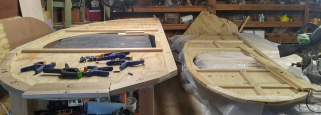

We went camping (teardroplessly) in Big Bend last week, and that and the preparations for it consumed a lot of October. But this weekend, I got back in the saddle, working in Wall 2.
I followed basically the same process as before, except that last time, I screwed the frame together laterally before screwing it perpendicularly to the plywood (if that makes sense). In the interim, it had been held in place with my complete (now expanded) collection of clamps.
This time, I screwed each piece to the plywood as it was cut, and will add the lateral screws later. We'll see if one method turns out to be better than the other, or if it's six of one, half dozen of the other.
Still have to install the crosspieces and then smooth out the edges with a router, but pretty good progress for a Saturday, especially since I also had to cut out the door.

Well, I just had an unpleasant realization, which any of you who read my last post has probably already spotted: I put the frame on the WRONG SIDE OF THE WALL.
OMG.
I mean, it's not a huge deal--I can unscrew all the pieces, flip the wall over, and reassemble them on the correct side, but still.
Bloody hell.
I had the two walls stacked on top of each other from when I used the one as a template for the other, and I just never thought to flip the blasted thing over.

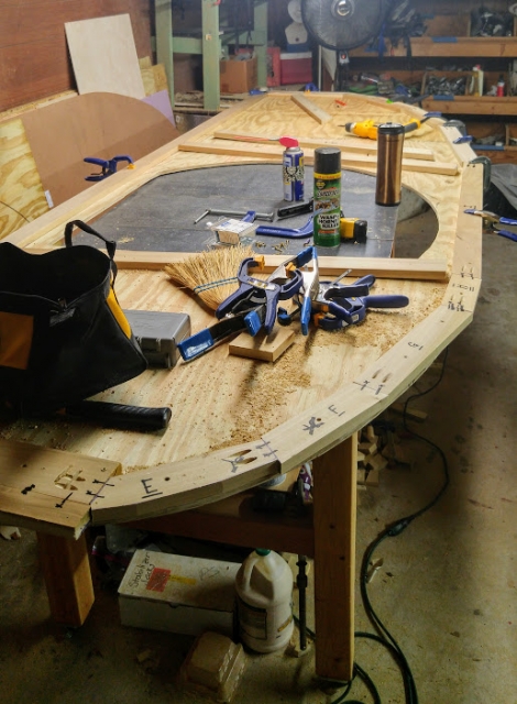

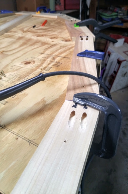

PIX:

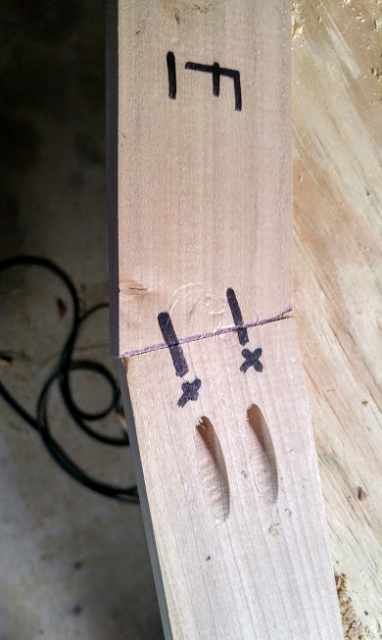

Marks across joins help me line the pieces back up after I take them out to drill the Kreg holes. They also help me know where to put the Kreg holes.

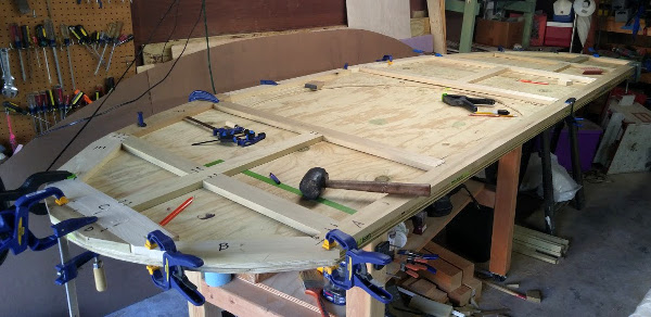

I used C-clamps to hold the joins flat as I screwed the pieces to the wall. Otherwise, some pieces will be higher or lower than the surrounding pieces, making an uneven join.
In progress. By the end of the day, all of the perimeter was screwed down, and all the inside pieces were cut and placed. Of course my phone ran out of juice before I could take a picture of the final thing.
Thanksgiving, here we come!
