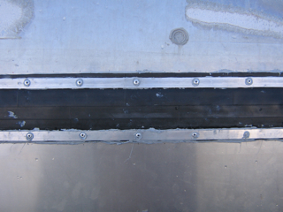

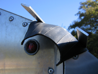

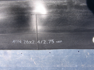

Session 2 on the hinge sealing completed today. Its all riveted in, and sealed at the corners. Tomorrow the excess tubing and squishout will be removed, and a masked line of sealant will be added to the top line and bottom lines as both will get gravity water exposure. Top one when door is shut, bottom one when door is opened past 65 degrees or so.
After completing that task, I moved back to the trailer, tested all the lighting with my car battery - had to remove it because car has to be idling for the trailer pin to work, after realizing I needed to delve into the test setup, I removed my car battery and attached the male 4 pin connector to it on the white and the brown. Tested the led's and all works as it should. Added 8 more clips to tie in the wiring all nice 'n neat using 1/8" rivets. Then I moved on to making the wiring harness that ties those 8 18ga wires into 2 to mate up (somehow) with the two from the cabin for the 16 led marker and clearance lights. I bought these special 3 way crimp connectors that look like a butt connector but different size holes on either side. Its got goo and heat shrink wrap built into the connector its awesome, makes really great streamlined 3 way connections, as I didn't want to use t-taps.

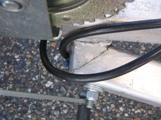

So I took three pics from todays work. The astute observer will notice the red marker led missing in the second picture - I ran out of these red ones and legally must have one on the rear of the fender, so it was moved to the fender. A 4 1/2 foot wide trailer doesn't need middle marker lights at the rear legally, but when I get a round tuit that red led will be added back in. Here are the pics:
this is the writing on the tube
view of the mountain bike tube sealed hinge with all the rivets done, stretching the tube as best i could
if anyone has a suggestion what to do with the edges it would be appreciated

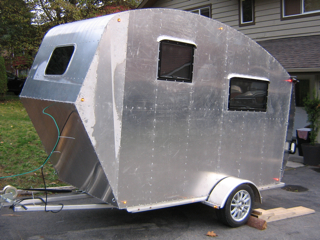

Today it rained just about all day - I noticed upon inspection that there are still leaks. Without the finishing beads on the top and bottom edges, water is finding its way in around the shaved rivets, getting into the heads and then dripping into the cabin. When I installed the tube I decided not to use sealant because I thought it could get messy fast, and that perhaps it wasn't needed. Well although the finish beads could fix this leakage, the best approach is to re-work the re-work. Meaning drill out the top layer of rivets, remove the aluminum flatbar, drill out the shaved rivets, back butter the tire with sikkaseal, slather up all the rivet heads and then tack it back in and shave the rivet heads. Then butter the top side of the tube covering the shaved rivets and sandwich the thing back together and re-rivet. Basically an entire re-install, but adding sealant every step of the way. Then the finish bead will be applied to the top and bottom of the seal/bar, and the protruding rivets from the inside. After that another leak test will be done.. hoping it dries up tomorrow. So another lesson learned, even the rubber seal needs to be sealed, now at least I know what can happen. [Edit: for clarity the days rain left about 1/3 cup of water in the pool, dripping all the rain time] This re-work is teaching me about humbleness - once its done properly no further re-work will be needed, and thats life. Probably a day of re-work, no worries my road trip has a flexible start date to some extent.

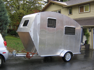

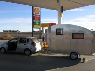

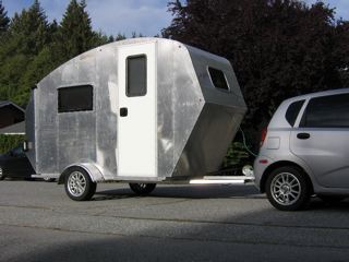

So after the leak inspection and observations, I decided to load the cabin onto the trailer frame same way as before. It took a lot more setup because the cabin wasn't offloaded strategically to align it with the trailer, all it took was some stumps, and some wood here and there and my neighbors hydraulic jack. Jacked up the rear to about 16" and blocked, then jacked up the front and blocked, backed the trailer up tucking it underneath the cabin but not into the frame rails. Then I setup the rope and caribiner on the winch and winched away. It worked but I really had to crank on the winch because the cabin wasn't exactly blocked at the right height, and more importantly I was pulling it uphill! Also forgot to mention the passenger side fender needed 4 bolts removed and 4 of the remaining 6 loosened off to give the fender about another inch of clearance allowing the RV door to pass through. Once loading was completed, I got under the trailer and reinstalled the 4 bolts and tightened all 10 back up again to secure the fender.
So it worked as planned! There was enough clearance for the RV door to get by - had the neighbor watching that fender while I just kept cranking the cabin forward to get a good tongue weight which felt like about 75-80lbs. On the car I noticed for the first time the rear suspension compress a small amount. Car has really, really stiff rear suspension for handling reasons, and keep in mind I haven't touched the airbags yet, they were still only at 5psi. Cranking them up to 10 or 15psi should do the trick to raise the car back up. Still the setup was very close to level, and man I just love the look this combo is turning out to have!
I couldn't help but take it for a rip around the block twice (only 1st and 2nd gear). The beefy rear suspension setup I have is going to work just fine. Clutch was ok too even starting uphill off the driveway but it did take some pre-loading. Still all in all I am very impressed with the small test run. Bigger test run up as soon as I get those 4 u-bolts in on the frame and wire up the brake/signal lights. Hopefully tomorrow afternoon. Here are todays pics:
car/cabin setup on the sloped driveway after the successful winching session
boy she's lookin' pretty nice.. the fenders really complete the look
looks like a flat backed from this angle, overall a nice looking piece of functional art

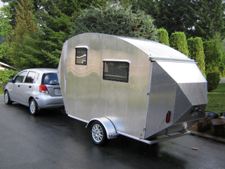

Today the cabin was secured to the frame via a gasket of rubber matting, and 8 class 8 bolts and lock nuts. That hydraulic jack had to come into play again, its just the best tool to borrow when all you have is a car jack. Get this, I jacked the 3/8" flange of the frame rail just in front of the tire and the whole cabin tipped up as one piece. This allowed me to lay the rubber gasketting in place and then set the side down, repeat other side. Then bolts were installed horizontally through the frame rail and the 2" tube adjacent to it at the ends. [Edit: this is how the cabin slides to get the tongue weight right if its wrong, simply move the cabin, drill 8 more holes and re-install the bolts]
The day lights were wired up, had to rush to meet a deadline, so in the final connections I used 2 yellow mar connectors until I figure out the layout, there was barely enough room to connect all the ground and running light wires without pulling some other wires apart, I had to redo a bunch of crimp connectors, getting better with that tool but still learning it.
So did the tail lights and the fender leds for test run #2. Those mini led lights are bright, you can see them in the daylight. [Edit: have to take some pictures of the leds in the day] The trailer was taken on an extended run with a hill climb, head and tail winds. The trailer handles really well, so much so I had to take it up to 70mph for a stint to see what things are like in that range. It was like a semi truck in many ways, more challenging to steer, but nothing out of the ordinary or un-expected. No sway or speed wobble issues were detected. Forgot to pump up the airbags on the rear suspension, that will help out the ride, but the required psi will need to be dialed in, as well as the best tongue weight. All and all it was a great run, I can't believe the lights worked on the first try, only mistake was had the left and right signals backwards so had to switch the connectors which is easy. The cars motor has to work for this job, its not a fun experience for the motor, it is working with the trailer on it, but it is used to being pushed, for over ten years. I floored it a couple times and could easily keep up with traffic, but it sounds funny because I have to rev the motor up a fair bit and all the mods to up the power and torque are showing for sure with towing. The rear suspension is actually getting a workout now - thats why I know to up the psi in the air bags a bit, it will settle the bump reverb up.
Was not able to change the coolant temperature from its typical range of 86 to 91 degrees celsius, still I have a scan gauge that will give me a digital readout on that and mpg estimates.
After the test run the trailer went to the scale, I didn't get a readout but it was free maybe I'll go back again for a re-weigh. Also occurred to me that I can take off the l-track and the insulation one day and go weigh just the shell on frame setup.
Sooooo the trailer missing 25lbs of insulation and 10lbs of l-track weighed in at..... 720lbs. I wasn't disappointed, because I knew the acoustic insulation and l-track was going to add around at least 75lbs. The trailer has impressed me, although it still needs flooring and the clamshell insulation and cover, thats going to add about 100lbs. I can work with that weight with a few modifications here and there, in order to up the allowed cargo weight. Still in its current form its got the potential to do the road trip required of it, (that being a light cargo hauler), pending a structural investigation to happen in a couple days.
Until then, here are todays pics:
side view, test run 2
angular view, test run 2

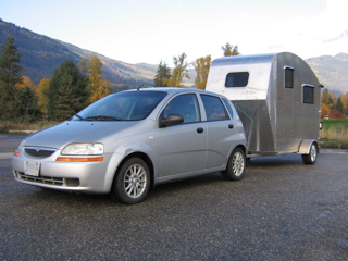

Some observations, results and recommendations about test run 2:
-from the pictures its obvious that 'if that cabin could snug up to the hatch another two feet' the drag would greatly be reduced
-cabin cannot go two feet, but the tongue can be shortened at least 6" without major frame re-work
-if cabin gets heavier perhaps the axles can take it, perhaps they can't
-~660 lbs of sprung weight on that test run 2 version is only on the frame rails, all at the edges, closest to the hubs, say around 330 lbs a side

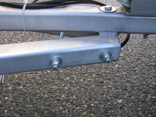

-frame rails are only bolted to frame at the ends so the whole middle part of the trailer can flex including the fenders but only if the cabin will flex too, which it won't hehe [Edit: i know where the weakest spot is its right at the tongue, easy to beef up]
-the tail lights looks terrible, they are standard and bright, but geez how about some aerodynamic tail lights
-the fender clearance looks smaller (today with even more load on the trailer, there looks to be 2" of clearance, i think this is typical)
-tongue weight of guesstimated 75lbs would have been just over 10% on the 720lb test 2 version
-airbags were at 5psi, should try 7.5, and 10
-what about the air pressure in the trailer tires, is it at 35, unknown it wasn't checked (oops) [Edit: all 6 tires were under inflated by about 2-3psi]
-are the tires winter tires (yes all 6 are the same tire on the same rim)
-looking at the empty setup to get a good tongue weight the cabin had to be moved forward it looks like 6 inches
-with a good 'dry' tongue weight its easy to load the cargo just over the axle area which reduces the moment of inertia on the tongue
-the tongue can be beefed up, the axles can be tied into the tongue leads
-this is not a typical 720lb trailer setup
-need to continue to learn how to make it waterproof
-sway control kit should be installed for safety

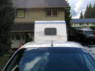

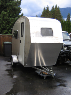

Heres a pic from the other day to show the air from the front:
sized off the trailing edge height, width of car frame, and angle of the hatch, thats how an un-corked 1.6L can do 70mph

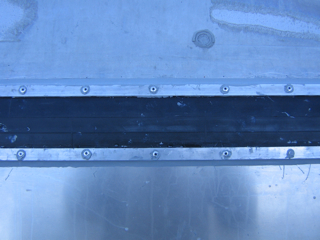

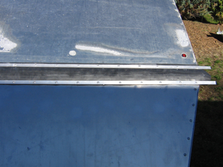

Today the re-work on the re-work on the piano hinge was done. When I drilled out all the top side rivets I was in for a pleasant surprise - the rubber was pretty much staying where it needed to be without the shaved down tack rivets, and I had put sikkaseal down at the ends, so the sealant there was acting enough like a glue to hold the stretched tube in place! So all I had to do was lay down a bunch of fat beads by carefully pulling back the tube and getting in there especially in the sides where the sealant meets up with the old sealant. Then buttered up the piece of aluminum, squished it all back together this time omitting the tack rivets so the aluminum flat bar gets to evenly compress all the way along the seal! I may have to chalk this up to lady luck again. In other words I no longer consider this step re-work, as the first part with the shaved down rivets was sortof necessary to stretch and set the tube layout.
Had to work with some light rain today and had to mask the finished work after the bottom side was done with the green tape, which goes on pretty well in the wet.. when the rain lightened up I dried up the moisture with cloths and hit the whole area with the heat gun for several minutes. A few hours later the sky has cleared so I removed the tape and again hit the whole area with the heat gun on low setting to dry out the majority of moisture and heat the whole area back up. I'm hoping it will dry well enough such that tomorrow I can put the finish beads on the top and bottom. Gonna use the trailer tomorrow for a dump run as I am getting really close to moving soon aka the road trip. I'll take some pics using the trailer as a 'dump runner'.
I dare water to get under that tube now! I know at the ends some might still sneak in but that should be really minimal. Here are todays pics:
view to the port - its messy looking but should be able to clean all that up
used a bit too much on the bottom seal, it just all squished out making for more finishing work
starboard side of tube covered hinge all gooped up good, still needs top and bottom shaving/prep and finish beads

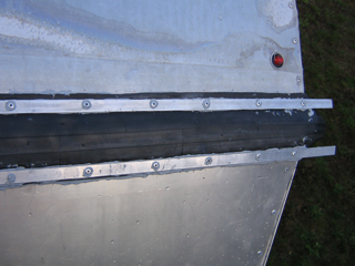

Today it warmed up and dried up a bit - did the top and bottom beads on the piano hinge and tube - top one went really well, the bottom one, for some reason it doesn't look as good. I think its the 'angle' the tape was pulled (being new to masking but doing a pretty decent go at it), and that maybe was done too soon. What happened is the tape kindof lifted up the seal just a tad right at the edge, but enough that I squished it back down after. In hindsight I should have layed down another masking line and then fixed. No biggie at some point I'll probably do another bead on the top and the bottom anyway to further clean up the lines and edges, but 'nice lines aside', the more important point is that both beads are concave and smooth. Again this doesn't look pretty but at this point in the build its more about function, especially the toughest seal in the whole thing.
I moved on to wiring up the cabin after this... sooo many mistakes, alls I'm doing is prepping all the wire ends with crimp connectors and heat shrink tubing. I think beginners luck came into play on my test run wiring setup, because this time, I think I made just about every mistake one could make. But alas once all those mistakes are mapped out, if I remain patient, the rest of the wiring session will go along faster, and more importantly, more accurate and precise. On each crimped heat shrunk connector I am still learning more about the tools and the method and whatnot, as I've done about fifteen of them. Slow start on this one as usual.
So here are todays pics:
top and bottom beads completed

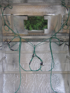

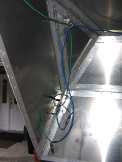

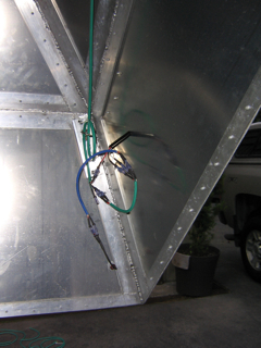

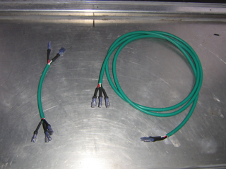

Today was a wiring harness day. I decided to do the whole harness in pieces so essentially its a daisy chain of 3 way dongles that split the 12V signal and then some 'patch' cords that connect some of the dongles together or for the end of the lines. I'm putting in some redundant leads too just because one probably should I figure. So just some pics of the raw wiring without dressing it up. I tested all the leds after adding connectors to make sure they worked and were labelled properly. Forgot to test the license plate light, oops.
So I got most of the wire sections completed today, tomorrow I hope to have it all connected up to the car. I am now in full understanding how to do good standardized heat shrink crimp connections. It does take quite a bit of practice to learn that wire stripping tool, and now I can do the process 'gently' whereas at the start I felt like I was fighting the tool and the wire all the time, tiring out my hands and my fingers.
The green wire is 16-4 jacketed threaded speaker wire, and the blue wire is 16-2 jacketed threaded speaker wire (used at the end of the lines).

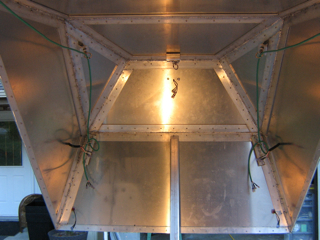

starboard side tail light, led and license plate light wiring
port side tail light and led wiring
heres what the 6 inch and 6 foot splitter dongles look like (6' one has 4 connectors just doesn't look like it)

Its been awhile since I posted, no pictures to post today but figure some sort of update is necessary. So the road trip was a complete success! 2750 miles by Streets and Trips which I consider to be really accurate. Been decompressing for the last four days. I did the road trip in six days - left North Vancouver last Wednesday morning, slept in the trailer Thursday, stayed at a friends in Winnipeg on Friday, slept on the road in Ontario for Saturday and Sunday, and made the final trek from Northern Ontario to Toronto on Monday.
Weather was cold at night, temperatures were around freezing most nights in the trailer, but I am used to sleeping with no heat and had two mummy sleeping bags, so no biggie. Each night had to repack some stuff in the trailer by hanging it from ratchet straps 'hammock' style, so as to sleep on the mattress which was on top of two layers of the insulation. I was snug as a bug in a rug.
I was waay heavy for this trip. Reluctant to admit this, but facts are facts. Waaay overweight. About 550lbs of cargo stuffed into the car, and about 600lbs of cargo in the trailer. The trailer weighed about 1376lbs. Sooo, the car was pulling around 2000lbs more than normal (shh don't tell anyone a 5spd 1.6L can do such madness). She made it through the Coquihalla pass, Rogers pass, and Kicking Horse pass with no problems, except having to push the motor to its limits - like I said the motor had to work for this job. Only a few times did I have to drop to third gear, most grades were doable in 4th gear, and the coolant temps didn't budge a bit! I honestly can't believe it - the car was pulling a ton of extra weight after all. Even this heavy it brakes way better/faster than a fully loaded semi (80,000lbs), can easily smoke them on the hill climbs and off the line, and only gives them the lead on the straights, where they can do 65-70. Wonderful.
Cruising speeds were 55mph to 65mph, with no wind or tail winds 5th gear could get up to 65 miles an hour, but with any cross winds or head winds it could only do 55 in 5th gear. On two days strong head/cross winds of 20-25mph were encountered and I had to drop to 4th gear to maintain 55, but this only lasted several hours total on the whole trip.
I saved all my fill-up receipts, and did a spreadsheet to get the mileage for each leg of the journey, by correcting the odometer by the amount Streets and Trips calculated. Using this 'realistic method' the car averaged 20 USMpg for the entire trip. I was hoping for 23-25, but given the fact that the combo was so heavy I think I need to do another realistic road trip with an appropriate amount of cargo to see if the mileage improves a bit. My gut says it would improve a bit but who knows, maybe the drag force out-competes pulling all that weight up the hills. In any case 20mpg is reasonable I just don't know what other folks are getting with their setups. My trailer is really tall, I'm sure if I towed a conventional tear drop I could get 25mpg maybe even 28-30, so there's a sacrifice in mileage deciding to go with the 'standi' or 'standrop' as I see some call it.
Ok, on to the setup - remember when I joked about watching aluminum welds fail? Well, still have to do a deep inspection of the trailer once I unload the cabin but the only thing I saw was the welds right at the front of the tongue where the A frame beams were tied together. Because I was soooo heavy, the tongue had a lot of repetitive strain put on it and all those bumps caused the top parts of the welds to crack right at the start of the journey. Fortunately I was heading to a shop to show off my setup and my friend there introduced me to a trailer guru who had a shop next door. He inspected my whole setup over a period of half an hour, gave it a clean bill of health, and he showed me how to temporarily brace those tongue welds using two sections of threaded rod, and how to 'box the whole tongue in' after the road trip to properly fix that weak area. Boxing in the tongue means welding a plate across the bottom and top (two plates on top in my case) of the A beams, so that's on the to do list. When he didn't tell me to abandon the road trip but rather do a quick fix, that was re-assuring as I also felt that those cracking welds weren't a deal breaker just something to monitor. The threaded rod fix ensured that even if all 8 welds failed in that area, the threaded rod would still hold everything together allowing one to limp to a shop and weld it up (couldn't weld it then because the wiring inside the tubes would melt).
Another note - when I got close to Winnipeg I noticed that the fender clearance was getting smaller and smaller, probably because the torsion rubber gets worked in a bit, but also because the half axles were overloaded by 200lbs. Now thankfully, these axles had adjustable splines, so in Winnipeg I pulled off the trailing arms and rotated them two teeth on the splines and re-attached. This provided over 2" of fender clearance with the load, and only took an hour to do the first time, its really easy I could do it in half an hour now with a hydraulic jack.
All in all the trailer handled really well, it truly is a solid setup, even with the stripped down frame.. it was my first build after all, a prototype. Not a single speed wobble, in fact the faster you go, the more stable it feels. On the last day on the hwy 400 I drove it at 65mph most of the way because I felt so confident in its handling.
It must be mentioned that without beefier h&r lowering springs, beefier munroe shocks, and firestone coil-rite air bags, there is no way this tow setup could be attempted. With the airbags, I was able to fine tune the psi to 17psi which caused the rear suspension to bounce in phase and at the same frequency as the trailer suspension. Then the tongue weight was dialed in by moving cargo back and forth to fine tune the setup. What this means is that when hitting those hundreds, thousands of frost cracks in the highway, the car and trailer bounced 'in sync' with each other and this is very important to mention because it smooths out the ride hugely and minimized the stress put on the tongue. To all who tow without airbags - get some they only cost like 150 bucks, and they are easy to install, especially the coil-rite ones. One can't dial in the bouncing frequency of the car and trailer without adjustable pre-load on the rear suspension. Its also important to mention that each cruising speed has its own unique setting for the airbags. The faster you go, the faster the interval between the bump hitting the rear suspension and then the trailer, so you have to up the psi, the faster you go. I tuned my setup for 55mph, because the airbags aren't hooked up to a compressor and a bleed valve (yet).
Sooo its a long post but I'm sure many following my thread have been wondering how things were going. I'm visiting relatives now, so when I get back home I'll do a followup to this post with some pictures of the road trip, the failing welds on the tongue and the 'just for now' fix on the tongue using threaded rod.
So, friends of the Teardrop, I describe year two as a great success! Its so rewarding to finally sleep in the trailer and be on a truly fantastic adventure/road trip. I look forward to learning more on this forum about the finishing of a trailer and please don't be afraid to comment - remember waay back at the start of this build thread, I did admit that I was the guinea pig foolish, er audacious enough to tackle this concept, and I am pleased to report back to you all that the dog will hunt. 8)

Now that the trailer has proven its legitimacy with the road trip, I will start a photo album with high res pictures ... when I get a round tuit :)
Until then, here are some pictures from the road trip:
this is where the weld cracked, only the top part guess thats where the most stress is.. to be boxed in

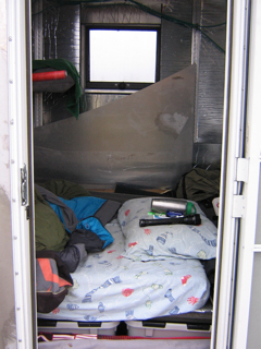

foam bed on insulation on plastic bins, nothin' fancy but it worked just fine
hadn't cleared the rockies yet

3 more pics:
threaded rod 'just for now' fix on the tongue (front rod goes right through that tube as a safety backup)
