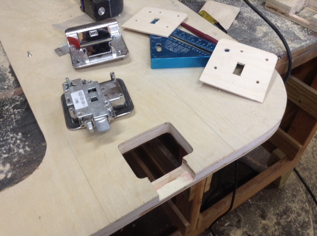

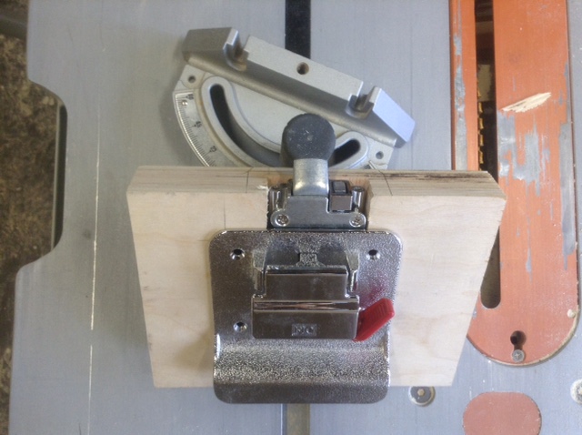

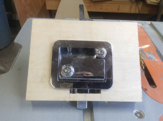

Built a jig to figure out the door latch mounting before I try to mount it in the door. Very glad I did. :)
Latch mockup 3
Latch mockup 1
Latch mockup 2
Clearly I have to design this better before installing in the door :thinking:

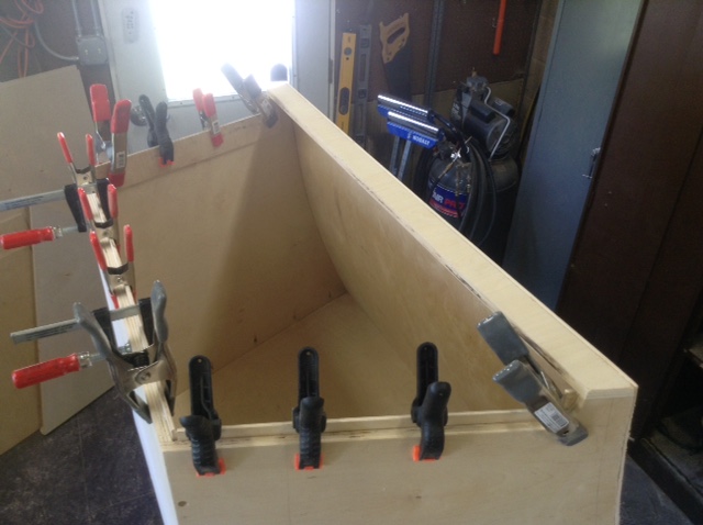

I've learned the hard way that lots of weights on a glue up is not a bad thing. No more gaps!

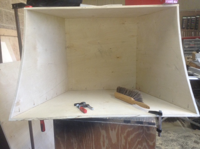

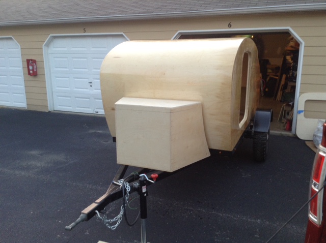

Also made some progress on the tongue box.
Tongue box 1
Tongue box 2

Postby KCStudly » Sun May 21, 2017 9:06 pm
I was able to fit my door latches w/o cutting everything away in way of the bolt. Had to file a couple of small spots for it to slip in, but they all still got covered up by the flange, so I figure it is that much more sturdy.
I can dig back through my build and post links/pics if you like.

Postby kokomoto » Mon May 22, 2017 6:34 am
KCStudly wrote:I was able to fit my door latches w/o cutting everything away in way of the bolt. Had to file a couple of small spots for it to slip in, but they all still got covered up by the flange, so I figure it is that much more sturdy.
I think I understand what your're describing. A pic/link would be helpful if it's not too much trouble. Thanks! :beer:

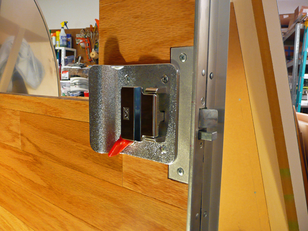

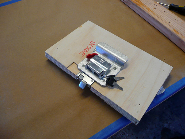

Postby aggie79 » Mon May 22, 2017 8:22 am
I used a similar lockset. It was easier for me to cut away all of the material on one side of the lockset so that I could fit the backset portion into the recess. I used a piece of 1/8" aluminum strap to bridge the gap and capture the backset.
I made a jig similar to yours. If you look closely at the jig with the lockset "mocked-up" you can see the recess for the strap.
This is the finished installation.
The strap doesn't look too bad - at least I don't think it looks bad - and really strengthens the lock.

aggie79 wrote:I used a similar lockset. It was easier for me to cut away all of the material on one side of the lockset so that I could fit the backset portion into the recess. I used a piece of 1/8" aluminum strap to bridge the gap and capture the backset.
I like that idea. It looks good, and makes the whole assembly easier. Thanks! :beer:

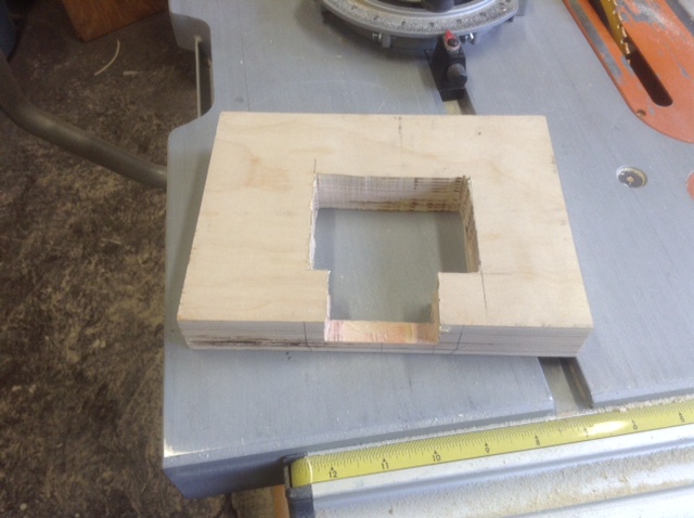

Postby kokomoto » Wed Jun 07, 2017 3:27 pm
Almost finished with the first door. Starting on the second, which should go a lot faster using some jigs created on the first one.
Latch cut-out 1

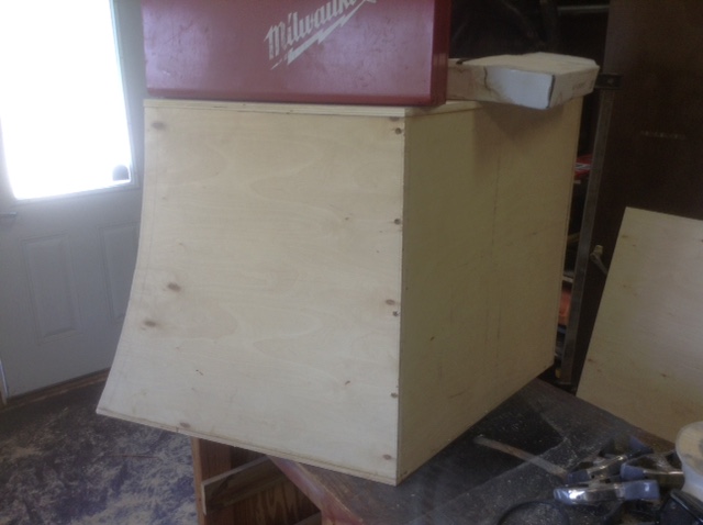

Also made some progress on the tongue box. It should be ready for epoxy tomorrow.
Tongue box 1
Tongue box 2

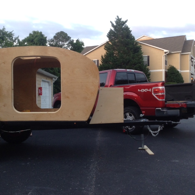

Postby kokomoto » Thu Jun 08, 2017 7:55 pm

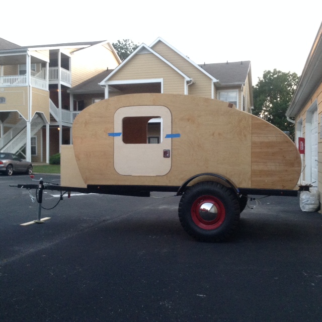

Got a start on the 2nd door tonight after checking the fit of the first door, installing the fenders, and putting the tongue box on.
Door check - port side
Tongue box 1
Tongue box 2

Postby KCStudly » Fri Jun 09, 2017 7:37 am
Good work. Nice door shape. :thumbsup:

Postby kokomoto » Fri Jun 09, 2017 8:20 pm
KCStudly wrote:Good work. Nice door shape. :thumbsup:
:D Thanks! I chose DIY doors because I wanted to use a specific window, but it's a ton of work.
