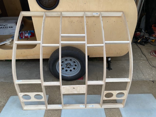

Slow going lately, but making progress...

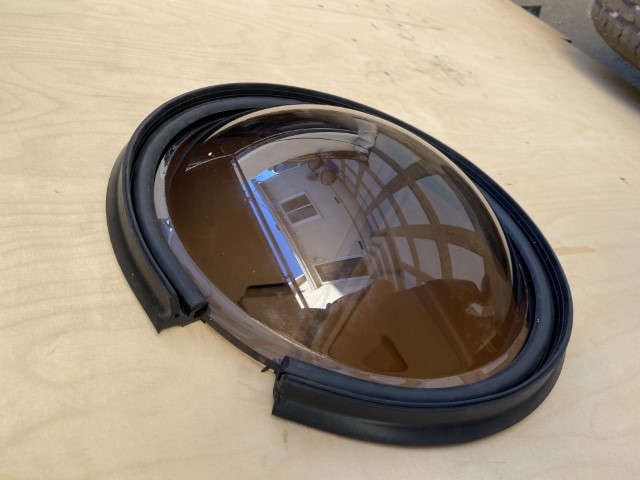

Test fitting the bubble window with a scrap piece of Trimlok. I think it's gonna work out!

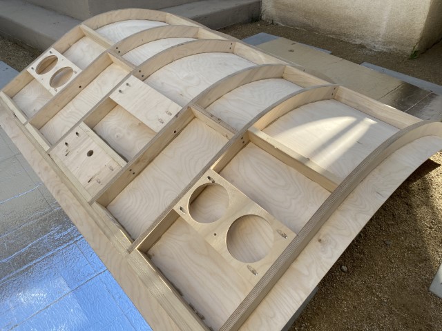

Started building the hatch!

Postby lfhoward » Sun Feb 28, 2021 9:17 pm
That hatch skeleton looks good! Nice progress.

Looking great! Please provide more info/photos on the bubble windows. Are they similar to the plastic things they make for dogs to look thru fences? I thought about those for my boys, but was chicken to try it fearing water intrusion!
Bezoar
Posts: 156
Images: 39
Joined: Mon Mar 10, 2008 9:01 pm
Location: Southern Wisconsin
Re: The Coddiwompler
Postby eLink » Mon Mar 22, 2021 10:20 am
Bezoar wrote:Looking great! Please provide more info/photos on the bubble windows. Are they similar to the plastic things they make for dogs to look thru fences?
Yes, they are similar. But I found a company that will make custom sizes, materials, tints and shapes.
https://www.eztopsworldwide.com/smalldomes.htm
On my non-insulated, 3/4" thick walls, the window openings are routed so that there is a 1/8" thick lip all around to receive the Trim-Lok gasket. The gasket I chose provides a double-seal against water intrusion. It's too early to tell whether they will be completely weatherproof. But I'm feeling confident about it.

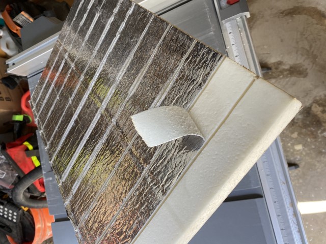

I opted to insulated the hatch as added defense from the sun for my ice chest.
My hatch framing is 2" deep so I used two layers of 1" thick polyiso boards, which I managed to acquire for FREE!

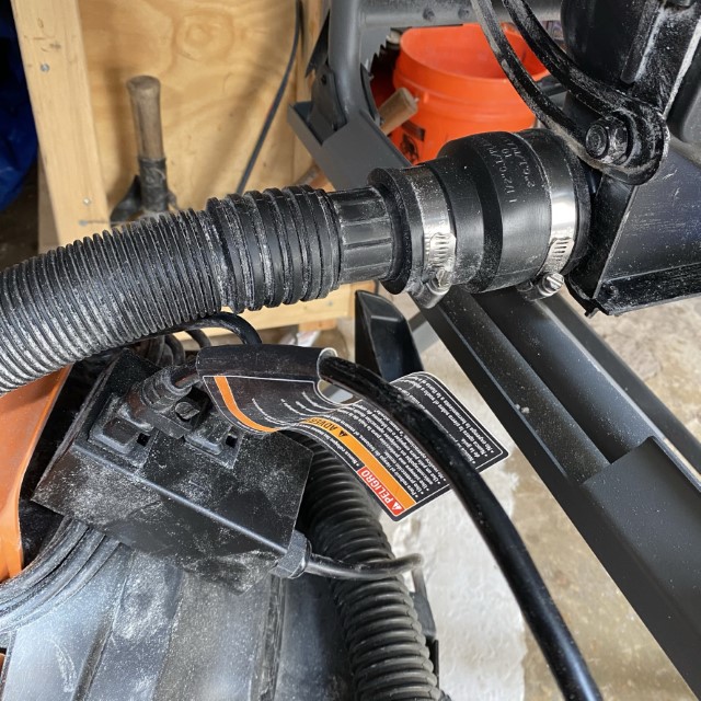

Cutting and kerfing would have been a huge mess if not for my new cheapo automatic dust-collection system!
Peeling the foil off of the second layer allowed it to fit more snugly into the cavities.
It was a lot more work than anticipated, but still a good learning experience.

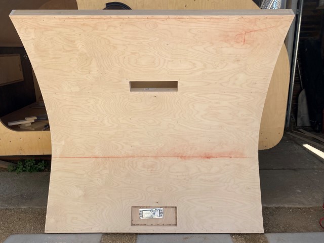

Postby eLink » Mon Apr 12, 2021 4:22 pm
Skin on, and the hatch keeps getting heavier!

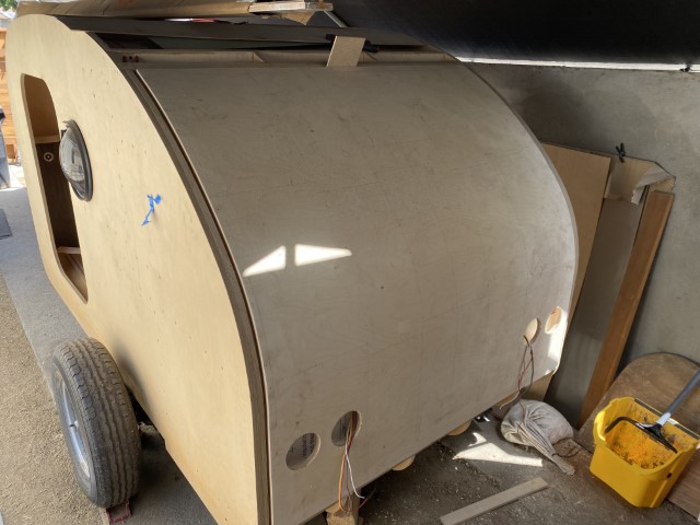

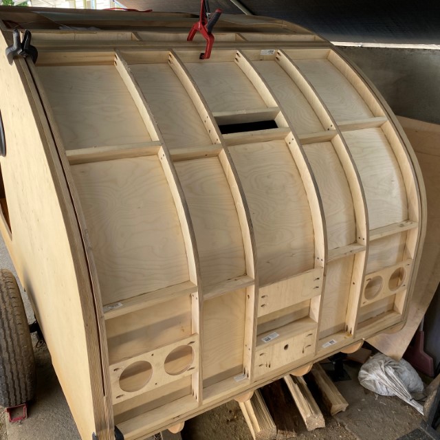

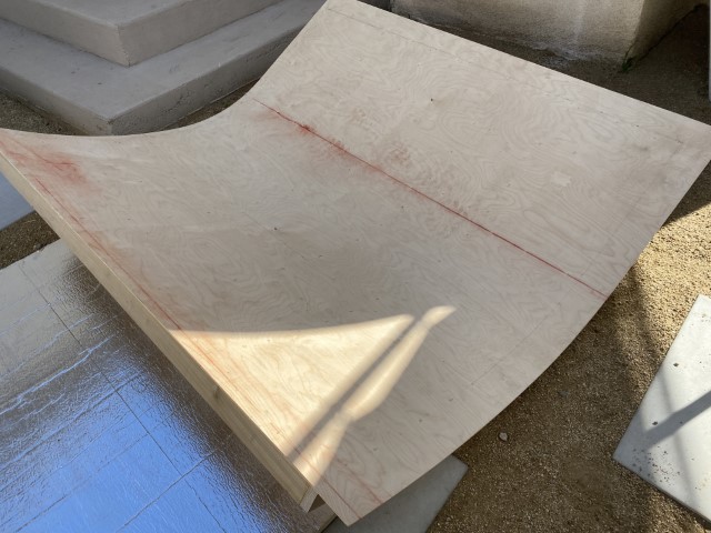

Got the bottom rear panel installed today. For a 6" radius bend, it definitely helped to pre-bend the plywood. I made use of an old picnic table to hold it in place while soaking and bending it for a couple of days.
164892 164891
Glued with PL Premium and stapled.
164893 164894

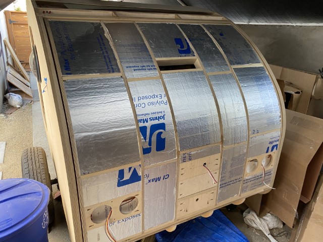

Postby eLink » Sat May 08, 2021 3:03 pm

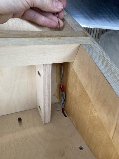

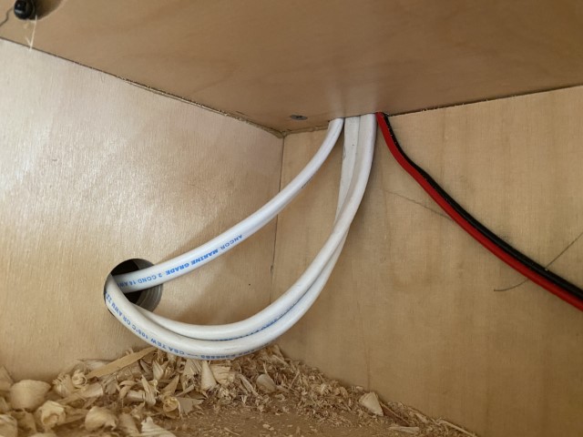

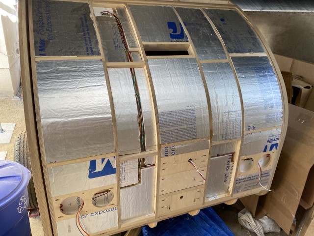

There is a 1/4" gap on the sides of my cabinets which is meant as a wire chase. Turned out to be a real pain when it came to pulling the wire! I realized that it would be nearly impossible to fish wire once the roof is complete, so now is the time!
Really tight squeeze! Hopefully I won't need to add any more.
