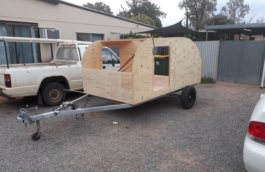

The day saw advances - none miraculous.

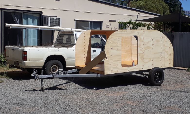

Postby MickinOz » Mon Mar 09, 2020 4:02 am
The day saw advances Trixie, one miraculous.

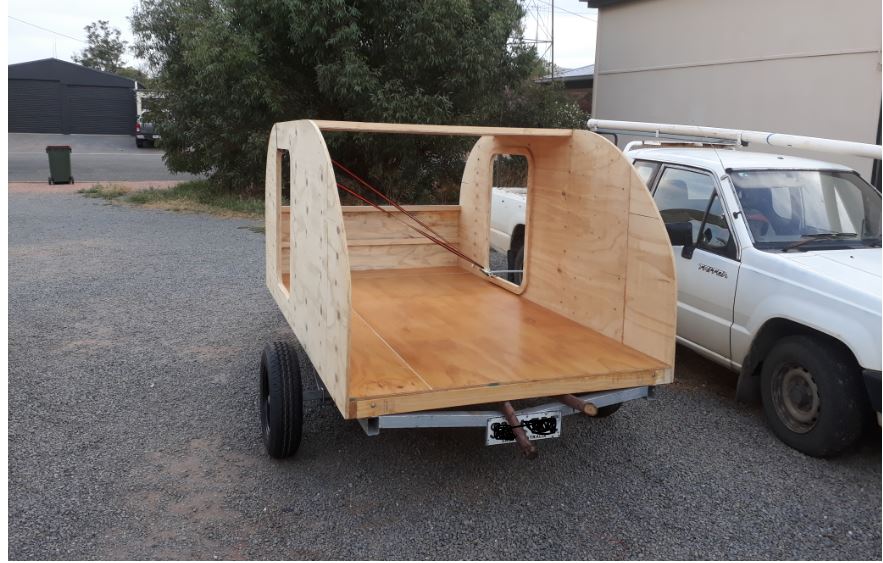

I installed the lower front panel.
Front panel on 9.3.2020.JPG (105.58 KiB) Viewed 4303 times
Rear view 9.3.2020.JPG (100.58 KiB) Viewed 4303 times
Went on easy with glue and 28mm galvanised narrow crown staples. I've never used a pneumatic stapler before. The one I'm using was loaned to me by a mate at work who bought it for ten bucks at a garage sale.
When I mentioned I was considering buying one, he insisted I borrow his.
I don't think it is a very expensive one, looks like an unbranded cheapy, but it sure sinks a staple in. I have a regulator on the compressor so I can dial it just right for whatever length I'm using.

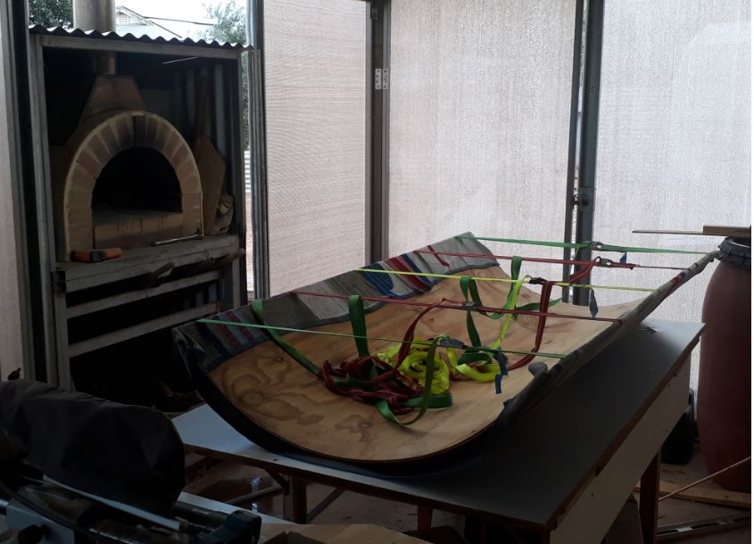

I measured up the front curve and cut a piece of 7mm structural plywood 3 mm over size.
I layed an old beach towel on it which happened to cover the approximately 5 by 3 sheet just nice.
Started pouring on kettles of boiling water.
By the time I was up to the 4th kettle, that thing was curving on its own as the outer veneer swelled.
I grabbed the tie downs out of the back of the old spot lighting ute and flipped that baby over and started cinching her up.
Blew me away how easy it curved, I actually overshot the chord length I'd measured.
Positively miraculous.
I needed 880 across the curve.
I settled on 850mm.
I reckon I'm going to leave this all to dry until next weekend, and I'm guessing it'll spring when I let the straps off.
I'm delighted I was able to bend the ply without a creak or crack to be heard.
I expect to have to fill cracks, the ones in the surface that were there before I started are unlikely too have gone away. :)
