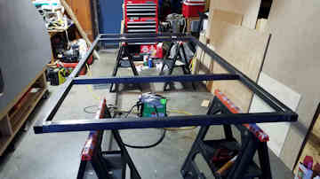

I don't have as much to report as I had hoped. I did start welding my frame Friday. From best I can tell, it is reasonably flat and square. I welded the outside square Friday with the intention of dropping in and securing the mid-supports on Saturday with the possibility of getting the tongue. Finish up with the rest of it on Sunday. that was the plan at least. When I went to drop in the two supports, they wouldn't go in. It turns out the final shape of the frame was hour glass shaped. I spent the better part of my available time Saturday figuring out how to spread the two sides out to get the middle beams in. I ended up stacking several 4x4s then placing my bottle jack on the stack and a final 4x4 long way to push up on the opposite side of the frame. I was able to spread it out enough to get each piece in. After the pieces were in place, I let the frame spring back and hold them in place to weld them. Here is a picture of the frame
20210529_205746 small.jpg (36.28 KiB) Viewed 1352 times
You will notice that both cross members are 2x2 square tubes instead of one of those being an angle. It turns out there is a first step to measure twice and cut once. The first step is check your dimensions three times. Measuring two or three times doesn't help if the dimension in your head is wrong. Fortunately, I had some of the 20 ft length of tube left over. Also fortunate I had forgotten about it. I had intended to cut pieces off for welding practice. It is just about ready for the tongue to be put on. I still have the fillet welds on the interior supports to put on. I ran out of time so they are up next when I get the welder out. You wonder why it stopped on Saturday with this wonderful 4 day weekend to work with? RAIN! or at least the threat of heavy rain and severe weather. It doesn't rain much in the Texas Panhandle so to have two days, all day, of strong storms forecast really threw off my plans. The sad thing is it didn't rain Sunday until late. Just threatened. That little space where the frame is in the picture above is where my wife's little Miata goes at night and when the weather is threatening to do it damage. I did manage to get out last night for an hour or so and continue to work on my drawer boxes.

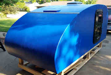

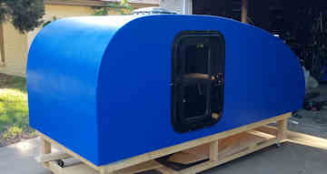

IT'S BLUE!!! :P
20210613_190155 small.jpg (30.25 KiB) Viewed 1266 times
20210613_190313 small.jpg (35.38 KiB) Viewed 1266 times

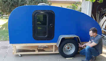

My son wanted to see how the finished product might look
20210613_190701 small.jpg (33 KiB) Viewed 1266 times
The plan was not to finish the cabin for a couple weeks. I was going to make progress on the chassis. Here is how I got to finishing the cabin instead of working on the frame.

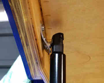

Last night I found a problem that I'm not sure how to solve. My upper mount plates have deformed. Here is the worst one of the pair
20210622_182905 small.jpg (32.68 KiB) Viewed 1172 times
I'm not sure how I should solve this problem. There are three things that I can think of that would cause this. One - The strut is too long and instead of stopping when the hatch opens fully, it pushes past the ball and lifting it off. Two - The strut is too strong and again pushes past the ball lifting it off. Three - The plate is not strong enough to restrain the strut.
The strut is a 20 inch strut with a 100 pound force. I can buy a weaker strut. I can get a 20 inch 80 lb strut. I'm not sure, without doing some math, if that will keep it from deforming. Unfortunately, I would need to get some help to figure out the right math to do. I do pipe flow and heat transfer. I have coworkers that deal with plates and fasteners.
I could get a shorter strut. I would have to see what lengths are available but maybe I can find one that is a little shorter and maybe won't try to push past the ball.
Another option would be to change the stud mounting. I found a round base that secures around the stud instead of above the stud. I also received a threaded stud with the strut. I could thread that into a t-nut like the screws holding the existing plates and place some washers to distribute the load and keep from damaging the wood.
My best guess is a shorter strut and/or not as strong. To the best of my knowledge the dimensions are as specified. That may be something else I need to check. I can't see how 10 pounds alone would make that much difference. :thinking:
Any other ideas would be appreciated

Postby GarthB » Tue Jun 22, 2021 8:57 pm
I can't speak from experience to say that they're any better since I have yet to install mine, but I purchased 90# struts, linked below. If I had to bet, I'd bet that your theory about yours being too strong is correct.

Postby Minics04 » Wed Jun 23, 2021 5:39 am
My gas Strut brackets bend occasionally, too. I think the brackets are made of too cheap of metal. I keep a couple of spares on hand and change them out when they bend.
Not a great solution, but it works. I was thinking about running bolts through the brackets to stiffen up, but have not completed that yet.

Postby Graniterich » Wed Jun 23, 2021 9:42 am
One reason I use these
https://www.allegiscorp.com/LARGE-DOOR-PROP?page=1

Postby Tom&Shelly » Thu Jun 24, 2021 9:41 am
JoeGrz wrote:Last night I found a problem that I'm not sure how to solve. My upper mount plates have deformed. Here is the worst one of the pair
I'm an electrical engineer, not a mechanical engineer, so keep that in mind when reading this! Looks to me like the plate deformed while the hatch was closed (or else it would just push the hatch higher). So you might look at the compressed end of the struts' stroke. So you may want to look for struts with a smaller maximum compression length. I don't think you want to compress them to their maximum. Struts with a lower force are also a good idea, as long as they support the hatch weight.
Just my thoughts.
