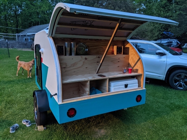

Beginning to trick out the galley. It's pretty basic for now. They wanted to use it a few times to get a feel for a final layout. Ice chest worked out. And the bluetooth speakers look great in there. I've stressed that the first task should be a safe prop rod. When they get home I hope he follows my advice before someone bumps that stick and knocks the bejesus out of them.

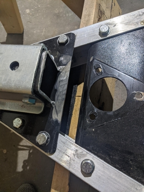

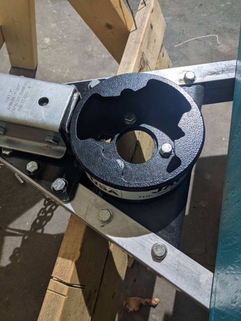

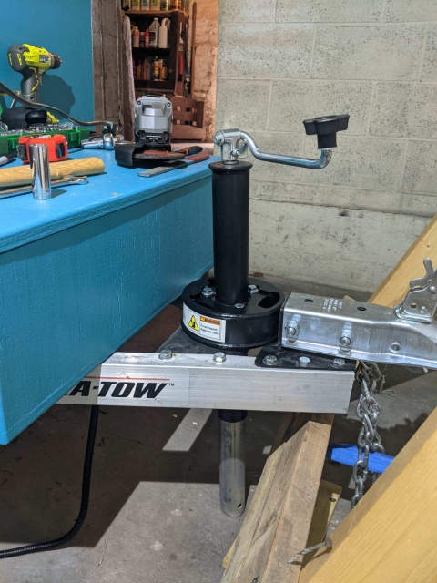

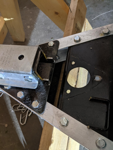

Just before leaving last Saturday Andy took the TD for a trial tow. On his way out of my driveway the A-frame jack scraped the concrete. We discussed adding pipe spacers to raise the jack up a bit to avoid most scrapes. After thinking about it I remembered the Jack-E-Up adapter that someone posted a couple weeks ago. After some research we found that Northern Tool has them for under $60. So Andy picked one up in Milwuakee the other day. One complication is the plate I had fabricated to mount the a-frame jack is too close to the NT trailer coupler frame member. Three options I am thinking about right now. Maybe someone else can suggest more.
- Add the pipe spacers to raise the Jack-E-Up a couple inches.
- Cut the coupling frame member (the black U shaped steel the coupler mounts on). I don't think cutting a small radius out of the back will compromise the strength.
- Have my local steel plate supplier make a new, larger a-frame mounting plate. They only charged me $18 (I gave him $25) to cut the shape, drill the jack hole and put strengthening bends on the front and back edges.

Looks like he is going to go the modify the black coupler mount route.

Continuing the work on the triangle jack mount. Andy has quite a bit of fab work to make it work. I suspect most folks would just be able to bolt it on. Will report after his first camping trip this weekend his thoughts on its use.
Dry fit

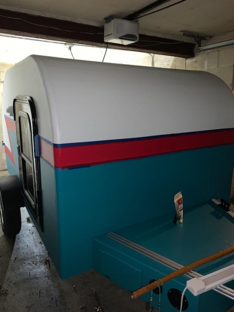

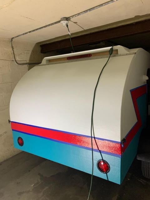

Postby TimC » Tue Jun 08, 2021 8:35 am
The artist has been at work. Blue painter's tape still on in these pics. And it looks like some sort of track device for bike fork mounts being dry fit on the tongue box.

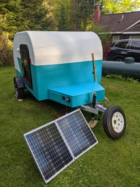

The rear facing vent with four 120mm 12v case fans work great. Though in an effort to get the TD on the road I hacked together a "plug" sort of thing to keep water and other things from entering when on the road and not in use. In the one photo of the rear exterior the blacked out area inside that vent is actually the solid section and the brown is the "temp" plugs. I think the vents should have been bigger but they serve the purpose.
The one trip I was on with them they went to bed late in the evening the first night and forgot to unplug the vents. During the night Katie turned on the fans but they weren't providing any fresh air since they were blocked off and they didn't open the windows. I witnessed them rolling out of the cabin in the morning and both looked very ill. It turned out they spent about 9+ hours in the cabin with no ventilation. Very big lesson learned. We'll have to come up with a better plugging system but after that experience I don't think they'll ever forget to open her up again.
I once calculated the interior cubic feet in my cabin which is slightly bigger. It's around 135 cubic feet if I remember. Two adults can use up a lot of the oxygen overnight in that space. I and others on tnttt have cautioned folks many times to make sure they provide fresh air so matter how cold the night is.
