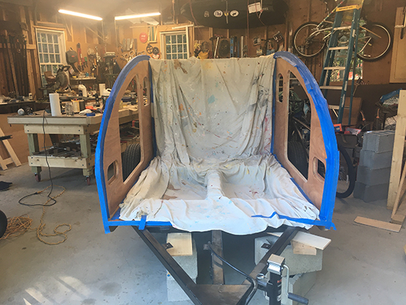

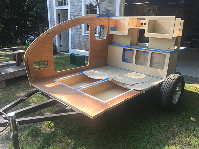

Yesterday masked off the laminate and some other areas and started spraying the cabinetry with urethane clear satin. Probably a few more coats tomorrow.
Next up is to install all the electrical components I've been gathering, as it will be easier to install that setup prior to installing the other sidewall.

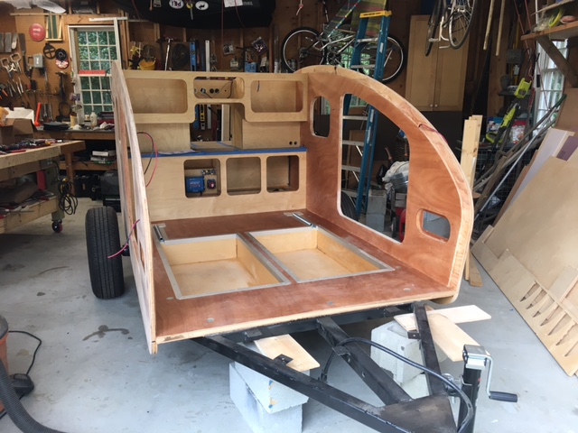

Yesterday installed the other side wall assembly. This side went a bit smoother than the first side.

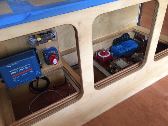

Also started to install the electronics and wiring. This area is not my "strong point" but after ruminating about it for, what seems like, a couple of months.... I think I have it figured correctly, hopefully. I probably could have done it a simpler way, but this is what it is. Still waiting for some 10AGW to finish wiring up the solar controller back to the bus bar. Also just ordered the battery. At least I'll be able to check all the fixtures as I get the wiring to them.

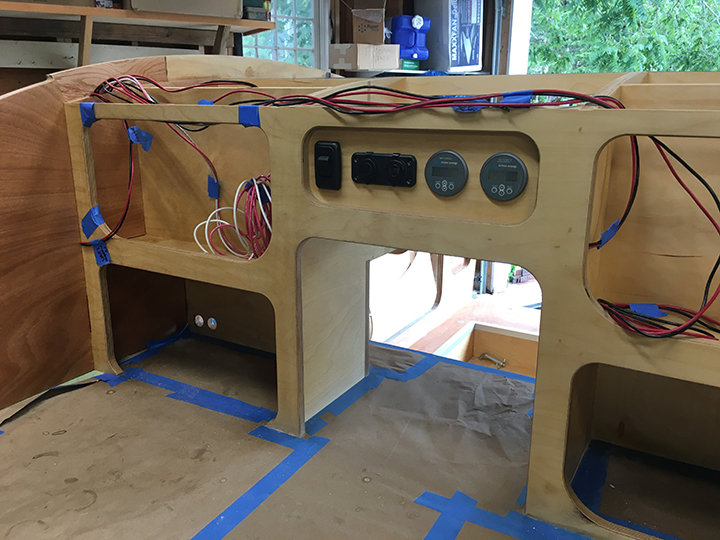

Here's one additional pict of the galley area. Installed the battery and solar monitors, a 12V/USB plug and the light switch which will control the hatch door lighting.
All the wiring was inserted within the wall sections when the side wall assembly was constructed and connects to the BlueSeas fuse box/distribution panel.....
waiting to get connected to the individual appliances.

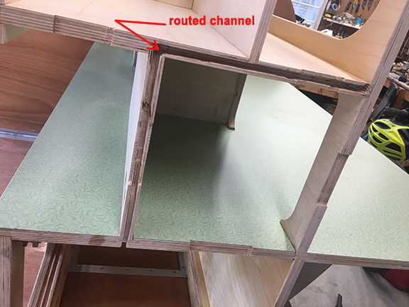

Two wires I forgot to include in the wall assembly were the wires that go to the monitors. :x I had to gingerly route out a channel
through the ends of the plywood cabinetry and snake the wires through the channel before installing the side wall.
routed channel.jpg (196.61 KiB) Viewed 1098 times

Good recovery John. We've all had similar problems. Fortunately the meter wires are very small. If they are like mine (from the shunt) I used a 2 pair 22awg telecom bundle.

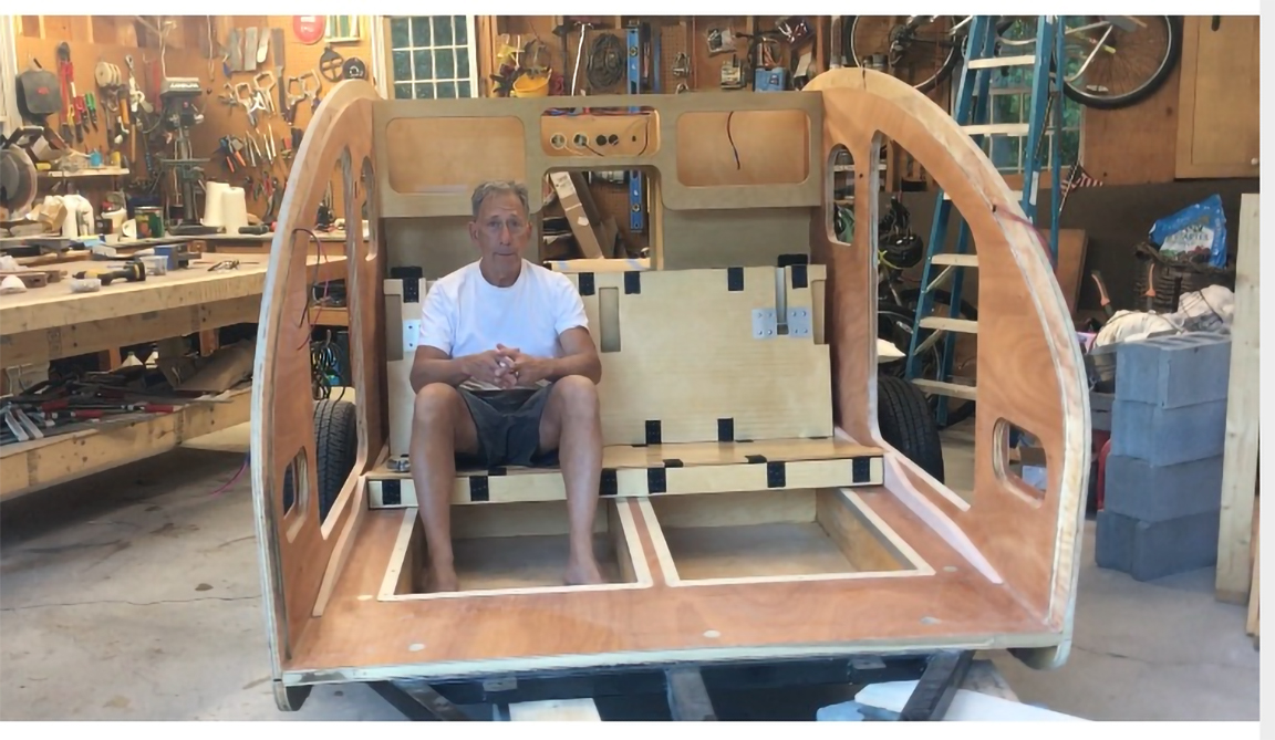

Got the oak tracks cut out which the couch/bed will ride on and kind of lock in place when converted to couch position. Tomorrow will install delrin plastic strips to floor which platform will ride on (to reduce friction). My wife and I laid down on the platform to get a feel for how much room there is.... seems plenty roomy. Now that the sides are on and the platform placed we can figure the size mattress we can use.

Today sprayed, what I'm hoping is, the final urethane coat on the two interior side walls.

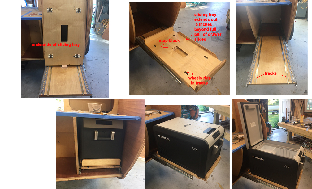

Also installed the drawer slide setup for the fridge. There was enough room in the space for a 28 inch slide but I needed the fridge to pull out 33 inches in order to get the cover to open at least 90°. Wound up adding a 2nd platform with 4 rubber wheels mounted to it's bottom that mated with 2 tracks recessed into the platform attached to the draw slides. A block acts as a stop to allow the sliding tray (2nd platform) to extend that extra 5 inches.

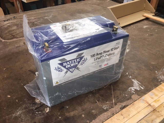

Received my battery today.... so as I move on to installing the elex stuff I can test everything prior to it's final install.

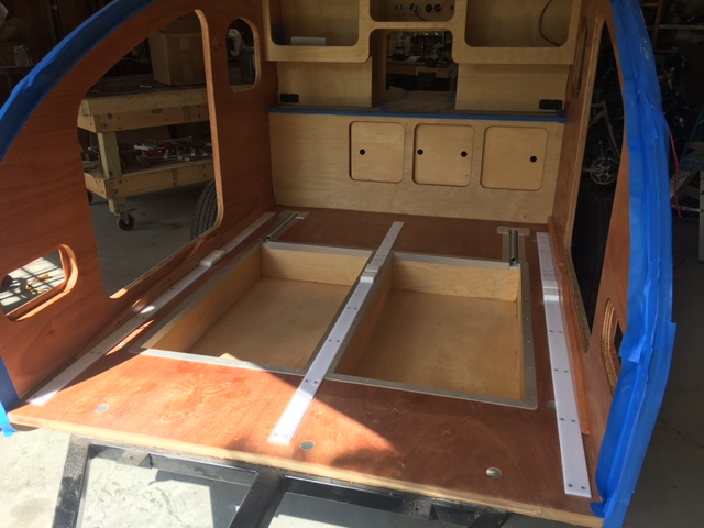

Also completed installing the delrin strips which the bed/couch platform will slide on.

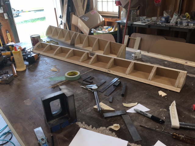

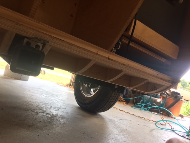

I had started working on the roll pan for the rear. Boy, did that turn into a fiasco. At some point it pays to work off the model and depart from the CAD. In this case I was following what I had developed in the CAD for the roll pans, built the thing and right away I could see it just wasn't right. For one thing I neglected to take into account there would be a .250 layer of ply bent across the framework of the pan (not to mention the aluminum sheet siding). I also made the opening where it was to fit over the rear hitch receiver too small and wound up butchering away a lot of wood on the pan I had just made to get it to pass over the top of the support ring on the receiver. The curves were too big and did not follow the curves of the side assembly. I thought I could scab on some extra meat on the sides to follow the roll pan curves (which would butcher the whole thing up a bit more). Ggggrrrrrrrr... what a mess. I slept on it and decided to just think it through a little more and rebuild the whole roll (pan). Second time is a charm. Anyway happy with it now. Lesson learned (one among many).
In the photo the pan in the foreground is the new one, background.... the problem child, headed for the dump.
This photo shows the pan in place (temporarily)... but you can see the .250 space between curve of pan and the outside of the trailer's side where the bent ply will butt up against.
