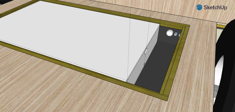

A little progress note and picture. I am getting ready to order the water tank from Plastic-Mart. I had been holding off being that it was a fairly expensive item. Oops, it's $20 more than when I first decided on this tank. It was special because I had little space for it, only 5" deep. I found a 35" x 19 1/2" x 4 3/4" fresh water tank. That is 11 gallons. Since we will not be doing much boondocking this will be enough. We also have a little Berkey that will filter any additional water we need. I finally got the plans looking good and have the pipes routed and protected.

BLTillson wrote:A little progress note and picture. I am getting ready to order the water tank from Plastic-Mart. I had been holding off being that it was a fairly expensive item. Oops, it's $20 more than when I first decided on this tank. It was special because I had little space for it, only 5" deep. I found a 35" x 19 1/2" x 4 3/4" fresh water tank. That is 11 gallons. Since we will not be doing much boondocking this will be enough. We also have a little Berkey that will filter any additional water we need. I finally got the plans looking good and have the pipes routed and protected.

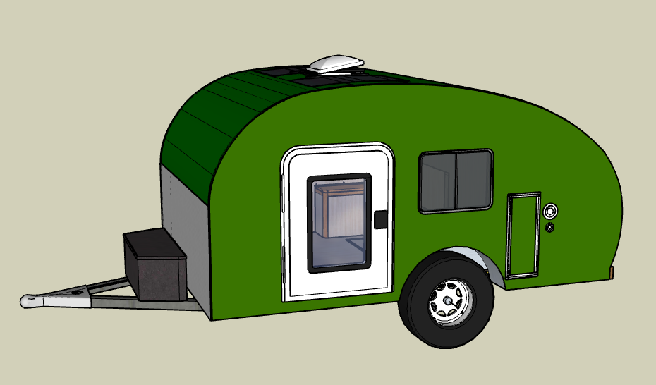

Little update. I finally made models for the new doors. At first, I was going to make my own doors but as time went on and the complexity of the project grew I decided to buy factory doors. Here is what it looks like with the new doors:
New Drawing with Doors.png (70.09 KiB) Viewed 2499 times
Once I have reworked and finalized the galley hatch I will post the new pics of that.
