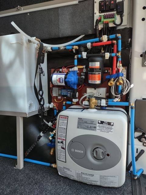

Yesterday was a big day, I started up the water system! Hot and cold running water is now available. Only one leak and it was easily fixed by tightening the filter cover.

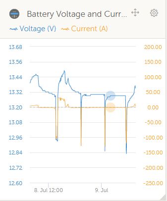

The electric water heater uses 1600W and takes about 20 minutes to go from cold tap water to hot. That's about 10% of my battery capacity (400 a-hr) and will take the PV panels about an hour to replace in good sun. I left the heater on overnight and that used 13% of the battery capacity. It looks like the heater came on three times during the night after the initial heating:

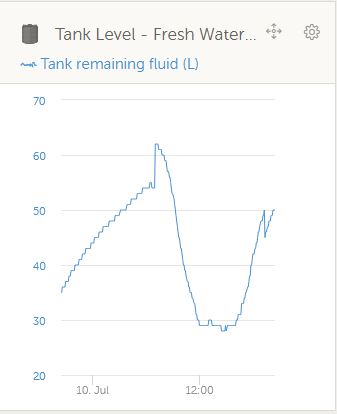

The water sensor also worked, I can now see the tank level in my Victron Cerbo screen. It's not that accurate yet, I need to tweak some of the sensor values once I fill the tank up all the way:
I left the pump on overnight too and no leaks; Pex is great stuff. :thumbsup: I'm waiting on a fitting for the tank vent and then the system will be ready to use. Now I just need to build the kitchen and shower. :D

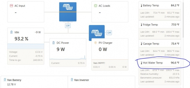

Thanks! I just found a use for the Ruuvi wireless temperature sensor that I wasn't quite sure what to do with. I strapped it to the pressure relief valve of the water heater and insulated it with thinsulate. Now I can monitor the hot water temperature; it holds decent temperature overnight without having the heater being on.

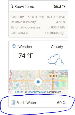

I'm not impressed with the tank sensor, it varies wildly with temperature (50% over the day). I might need to insulate the sensor or something. I guess just being able to see some kind of level is nice. I didn't add or use any water today and you can see how the level varies:
