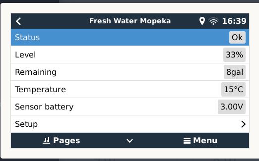

BYW, the Mopeka Water Sensor shipped so I should have it in a week. I'll let you know how it works.

bdosborn wrote:BYW, the Mopeka Water Sensor shipped so I should have it in a week. I'll let you know how it works.
The VRM treats it exactly the same as the RuuviTags. Setup will be similar.

I got the Mopeka water sensor installed, easy peasy and it looks like its much more accurate than the pressure sensor I'm using.
