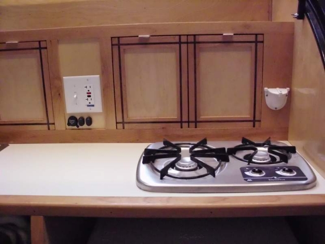

Hi Michael I've been watching your build for a while now and it's AWESOME. I'm the quiet one and don't usually don't say much but I'm thinking of you. When I saw your counter top and the stove you are using is the same one I used in my Teardrop build and after using it I found that I put it to close to my side wall because when I have pan on that burner it deflects to much heat on the side wall. :( I don't know if your counter end with the stove is next to a wall or not but here's a picture of mine.
Just something to check out before you get paint on it. Hang in there I'll be thinking of you. :thumbsup:

Thank you Elm and feel free to speak up more often! I was reading the instructions that came with the cooktop and it specified three and a half inches from the sidewall. Luckily in my case there is no sidewall only a fold-down Leaf which should not make any difference. The back wall will be a tile backsplash so I believe no worries there. Nice observation and thank you for your input! And again, feel free to speak up more. Thank you.
