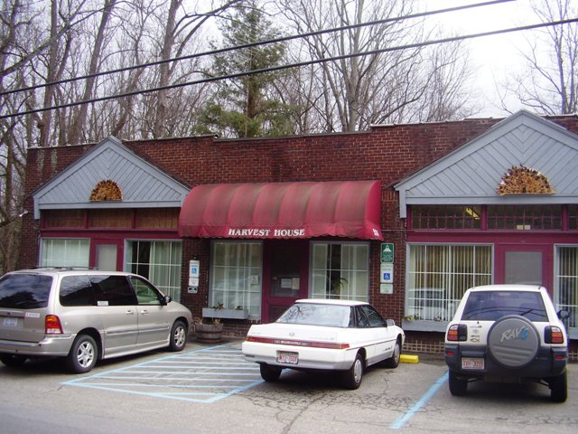

This is the Harvest House, the community center in Asheville where they have a woodshop you can use for $2.00/day.

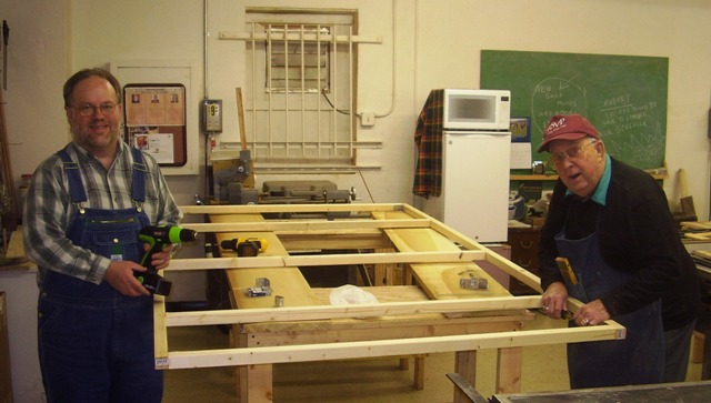

This is me and Jim. Jim is a volunteer at the woodshop, who helped me a lot today. Among other things, he taught me how to use the Miter Power Saw, to cut all the wood the same length.

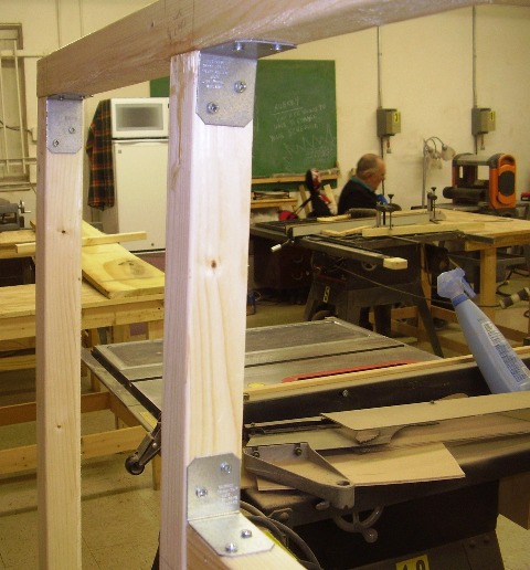

Here is a close-up of the framing...

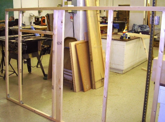

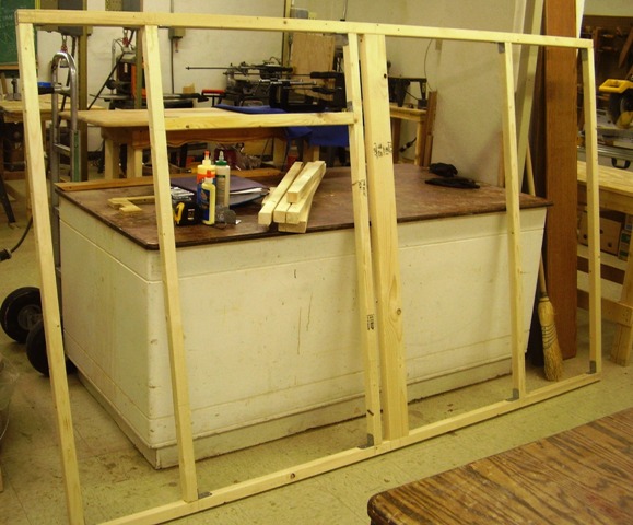

Here are two separate views of where we are, so far...
Had a lot of fun today. Got there about 1:00pm and stayed 'til about 6:30pm. Had to go to Home Depot once. Going to try to return tomorrow for a few hours before work to get the rest of the framing done and get the floor board on.
