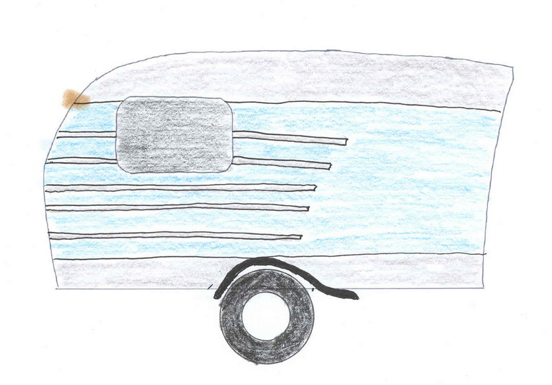

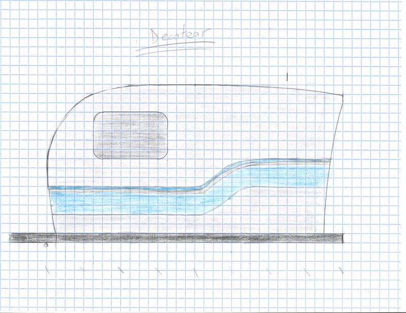

Based on a free pop-up frame received from a generous Craigslist poster, and built with 1/2" ply sides and floor, the Decotear will have no galley, no electricity, and no side doors. Basically it's going to be a toy hauler for my recumbent bikes, that I'll sleep in at night. I'll skin the sides with aluminum, and am thinking of doing a vinyl top. Here's the concept drawing:

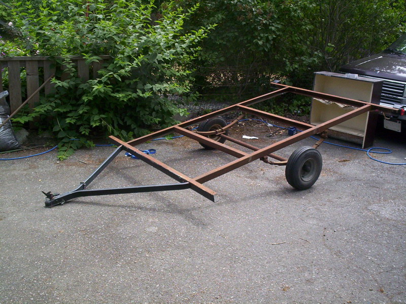

So far I've started trimming off some of the excess crossbars from the donor frame. It was about six feet wide to start off, but the main rails are only fifty inches outside to outside. The length is a perfect eight feet, so that's good. This is what the frame looks like right now:

that's a very nice profile. i especially like the vertical curve of the rear.
how will you lead your bikes? will it have a hatch in the rear?

Green Eyed Diablito: Yes, the door's going to be at the back. You'll see I have a small landing at the back, I figure that should make things easy as far as loading goes, and it'll give me someplace to sit and put on my shoes in the morning :)

Greg M wrote:Green Eyed Diablito: Yes, the door's going to be at the back. You'll see I have a small landing at the back, I figure that should make things easy as far as loading goes, and it'll give me someplace to sit and put on my shoes in the morning :)
i didn't even notice the landing. that's really good forethought.
this is going to be a cool build.

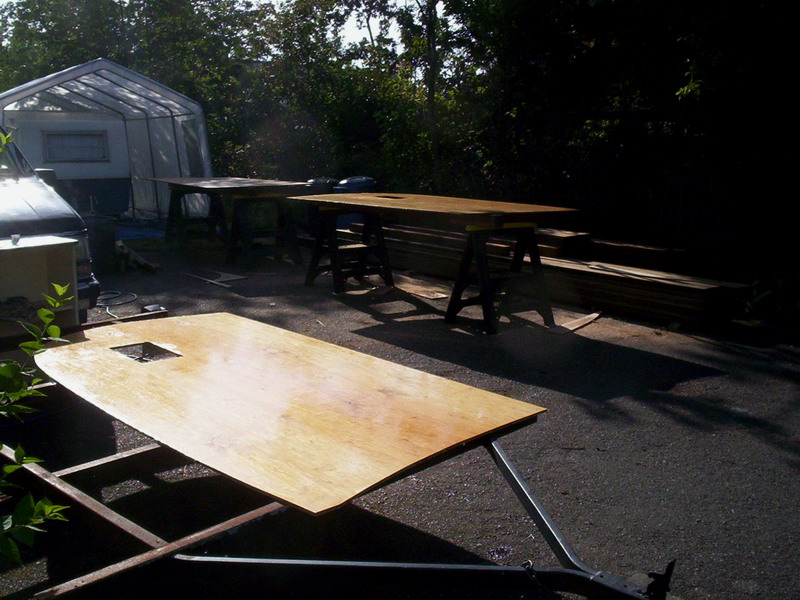

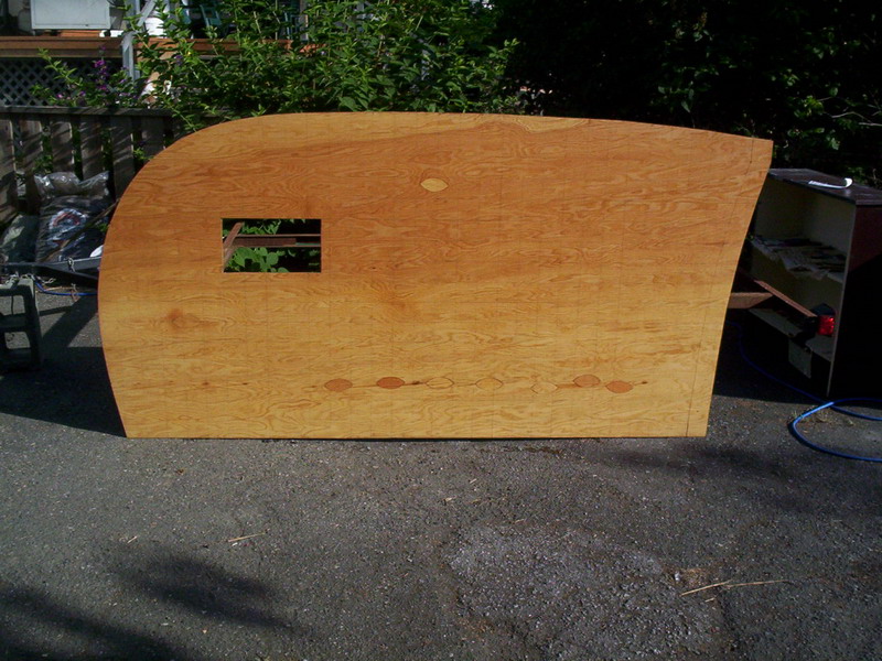

Today I got both sides cut out and two coats of epoxy on the insides. I did a second coat on the inside floor, and a first coat on the outside of the floor. I also tracked down 4x8 .032" aluminum for $63 Canadian, and talked to the auto upholstery guy about materials for the roof. Still not completely happy with the choices he had on offer, so I'll make some more stops later.
Next up: more epoxy. Then a trip to the metal supermarket (yes, that's the company's actual name) and it'll be time to get the sides up. With luck I'll have the sides on, spars in, and maybe the inner roof skin done by the end of the weekend.
Here's today's pics so MJ and Auntie M won't beat me up:
My driveway after work. The only thing missing is me madly running around epoxying one panel the tipping off another, but someone had to hold the camera :?
And here's the first side with two coats of epoxy
Now, It's time for a beer.

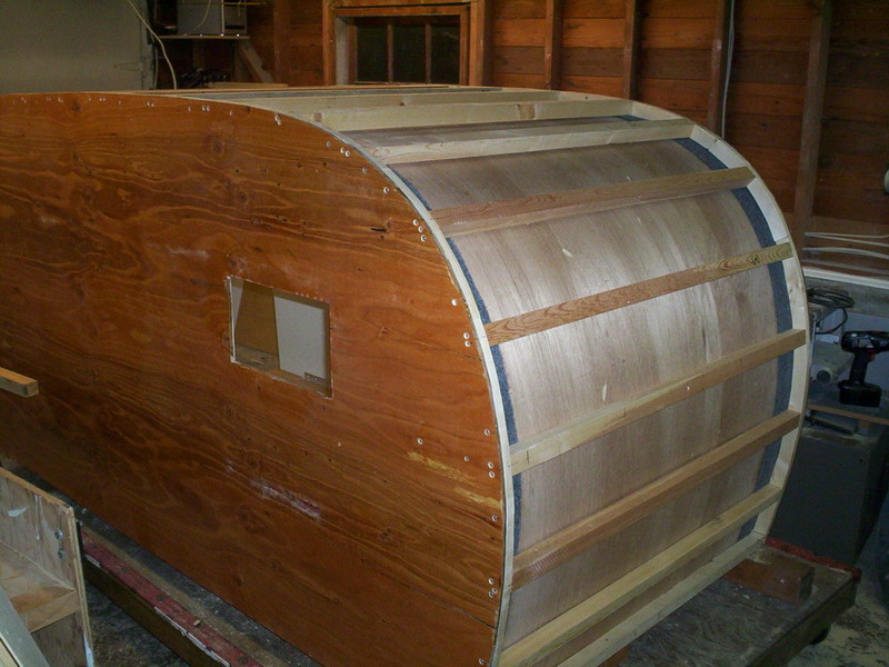

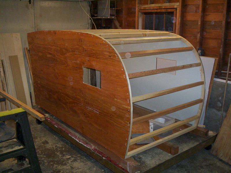

Not quite the progress I'd hoped for (gotta win the lottery and quit working 10 hour days) but, most of the really boring bits are done now. You know: epoxy, sand, epoxy, sand, paint, sand, paint... So, visible progress is being made again. I now have the sides up, and the spars in. The inner roof is ready to go in (I just need to go borrow the air stapler) and the rear door frame's epoxy is drying. Here's how things are looking:
I've also been playing around with the graphics a bit more. I'm liking this more, only without the ketchup stain :lol:

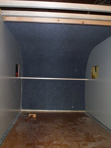

Now things are starting to move along again. I've got the first section of ceiling carpeted and installed. Even with the air conditioning running that was a hot job :? I also popped in a simple shelf just to have someplace to put my glasses etc. at night.
Once I've got the next bit of ceiling done, I'll be ready to build the framing for the rear door. Then it's time for the roof skin, and maybe even aluminum by the weekend :twisted:
today's pics:
The inside looking noticeably darker:
and the outside showing the carpet wrapped around the ceiling:
