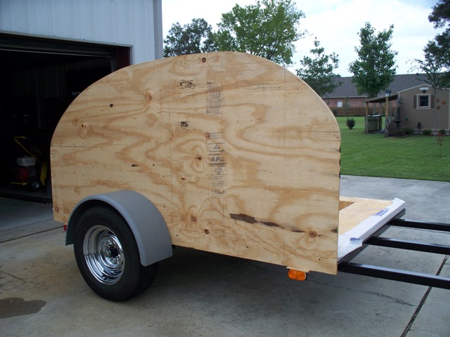

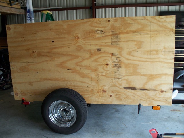

Postby Mike_La » Sat Sep 19, 2009 10:55 am

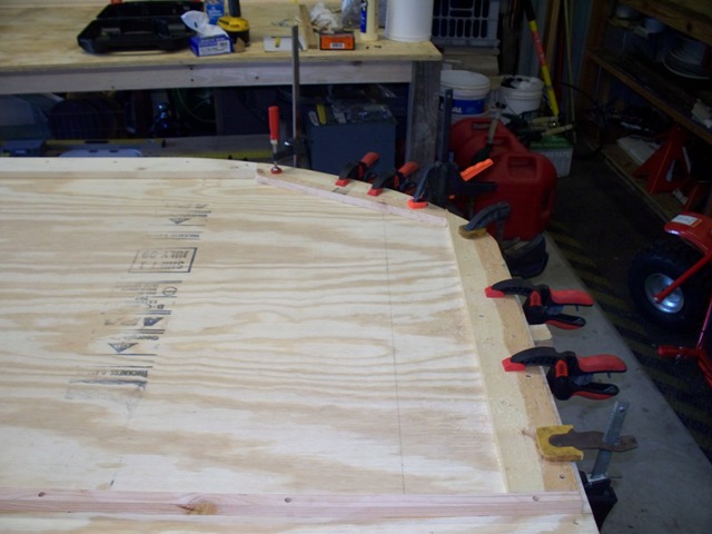

Temporarily placed a 1/2" sheet of plywood to use as a sidewall template.
Now to transfer my measurements to the template. :thinking:
Knowing that mistakes ARE very possible, I've got a few of these 1/2" boards left over from last years Hurricane preparedness.
Mike

Postby Mike_La » Sat Sep 19, 2009 4:14 pm
After much figuring, I managed to shape the profile I was looking for.:D
Now to transfer this to the permanent sidewalls, but not today.

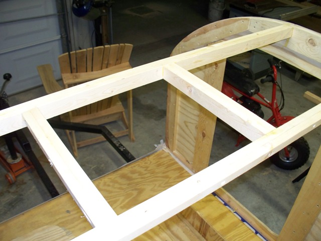

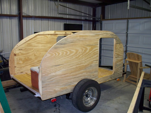

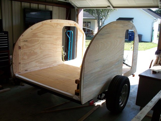

Postby Mike_La » Sat Nov 07, 2009 7:51 pm
The weather finally straightened up and I got a chance to work on the TD during this past week, and today.
Cut out the two sidewalls using the template. Framed the outer edges.
Installed the two sideswalls.
Framed up for the ceiling vent.
3/4" X 1-1/2" spars, doubled-up in this area.

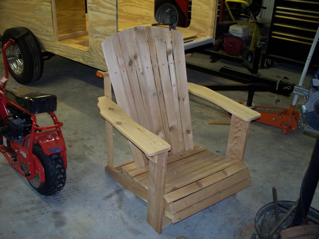

In other news, Oct 25th was Pat's birthday. She's been wanting an Adirondack Chair for some time. While time off from work, I built one for her using 3/4" Cedar.
She likes the natural look, so I'll just use a clear sealer on it. I've still got to build another chair and a small table to set in-between.
Hopefully, the weather will hold out for a while tomorrow, so I can get a bit more done.

Postby 2bits » Sat Nov 07, 2009 9:56 pm
You made some good progress and what a beautiful chair too! Good man taking care of the little lady! :thumbsup:
