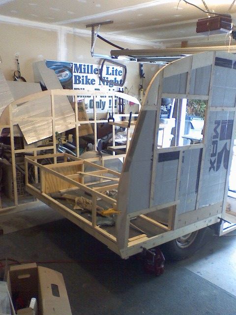

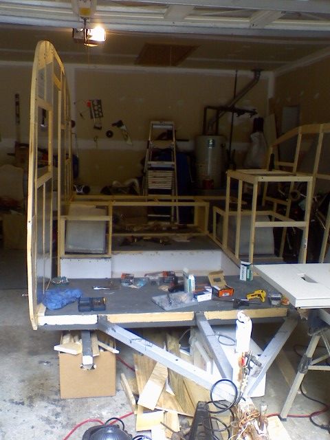

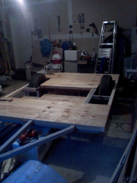

dad gum it, I finally got a few pics downloaded so here they are,,, its of a 1773 Scotty Serro sportsman,,, the box is 10' long, and 6'3" wide and is being shortened to 5'11" inside,,, I lucked out and have all the original metal for the sides and 5 windows,,, so they will be recycled on new trailer,,, the top is gonna be TPO (good stuff) fully adhered to 1/8" plywood,,, a 4' piece of 032 aluminum from the frame up 4' on the front and back,,,In the back will be a 4'6" wide x 6'3" futon bed dat folds up into a couch,,, front will have a small table and seating for two,,, 12v lights thruout and 120 for coffee and ac,,,, no sink and no propane,,,, ,,, well so much for da verbage,, here is the start,,,, more to come,, I swear

Just one 'hmmmmm' . . .with that 2x outside of the tire; got enuf clearance to change it? Looks kinnda tight

yeah it would Ageless,,,, they are temporary and will be cut out to match the wheel opening when its finalized along with the section of 1x4 in front of the tire,,,, just dont want to cut off too much and for me dats the first thing I would do,, measure 15 times and cut once,,,, :lol: hope for the best,,,
