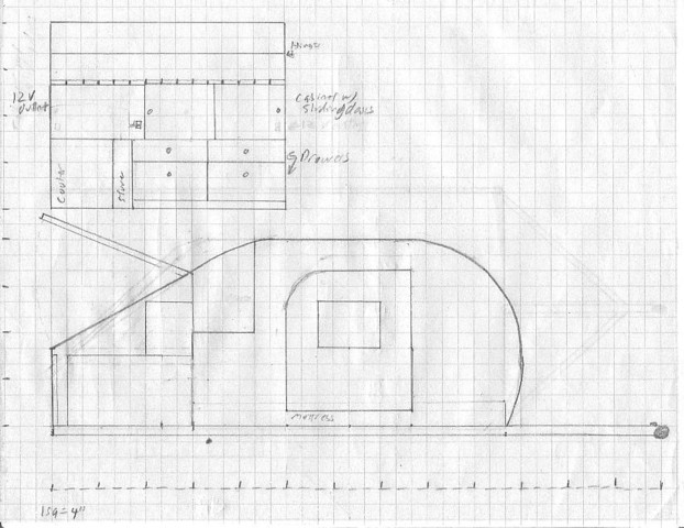

Postby MoparCzy » Sat Oct 17, 2009 12:17 am
Okay, I was able to scan my first draft of the profile. I do not have a good drawing of the upper/lower hatch area yet. You can find the profile in my personal album.

Postby TimJones » Sat Oct 17, 2009 4:49 am
Looks like maybe three feet to the back of your cabinets, than with the fiip up shelf over 4 feet. tryed to reach across a piece of plywood and get to the back of it for something?

Postby MoparCzy » Sat Oct 17, 2009 10:13 am
The upper cabinets in the back would just be for food storage. I am near 6' tall and do the cooking so I don't see a problem getting in there. Plus this is just a rough idea for the galley so still subject to much change during constrution.

Postby MoparCzy » Sat Oct 17, 2009 10:16 am
Sort of, except that the hatch will swing open to the curb side and have a counter that swings up attached to the inside. That is where I plan on setting up the stove when cooking and the dish pans when washing dishes. I am working on getting the designed height so that the counter is no higher than one in your kitchen at home. Going to use a torsion axle with 23" diameter tires so it should end up in the low 30" range for counter height.

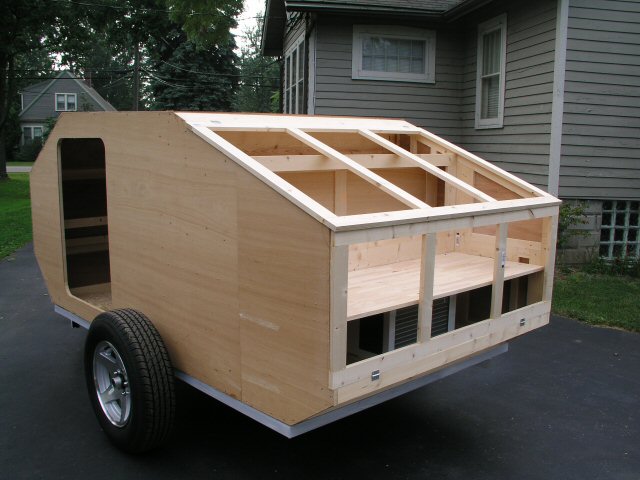

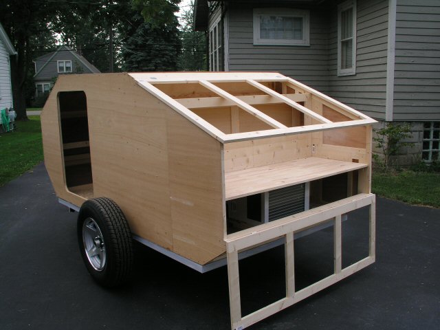

Postby tinksdad » Sat Oct 17, 2009 2:11 pm
I think I saw it addressed in another thread; but my concern with a 5 foot wide door would be sagging. Have you considered splitting it and going with two doors for a U-shaped kitchen?
It's cold and raining here today and I don't want to jeopardize my health before next weekends major teardrop gathering and party in the south central, so I opted to mess around on the computer. I hope you don't mind; but I took your sketch and tried a little 3-D magic on it. Left one wall off and drew it with both a 5 foot swing door and a 30" swing door for comparison. (The lady in the pics is roughly 5' 3" tall.) I also didn't add the trailer frame or a lot of your cabinet details.

Postby MoparCzy » Mon Oct 19, 2009 11:46 am
I am not worried about sag, When the door is open, I will have the outer end supported on adjustable length legs at both the front and back of that end. And thanks for the 3-D view, very nice.
tinksdad wrote:I think I saw it addressed in another thread; but my concern with a 5 foot wide door would be sagging. Have you considered splitting it and going with two doors for a U-shaped kitchen?
