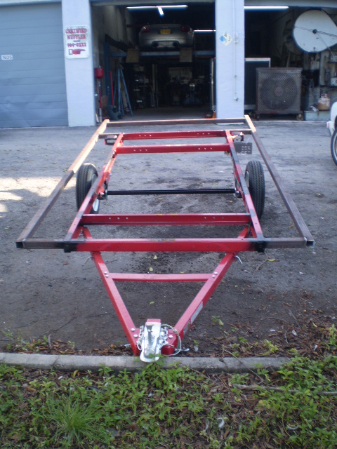

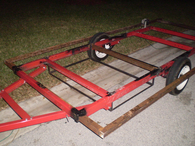

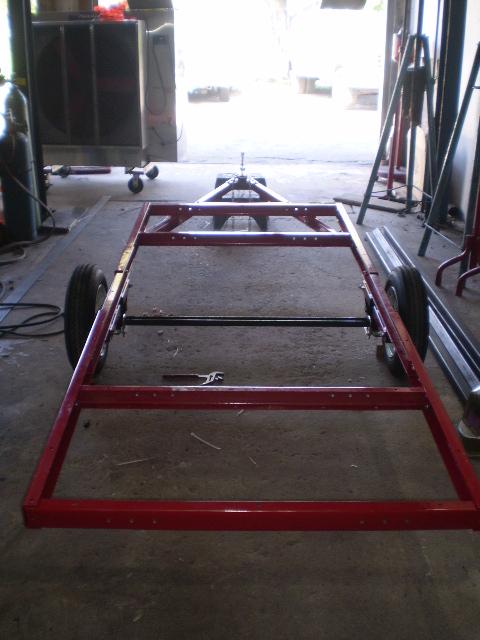

Stretched
Stretched more and widened

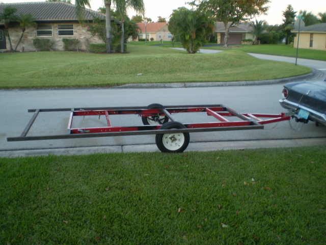

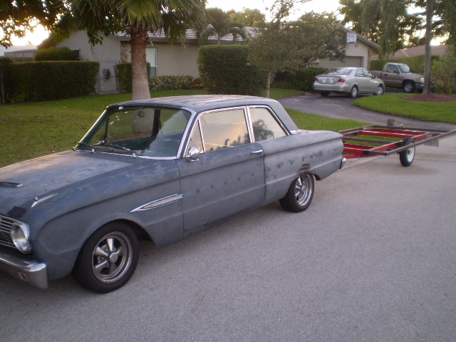

What a match (I had to build my own trailer hitch)
Profile ( the axle was moved rearwards after this)

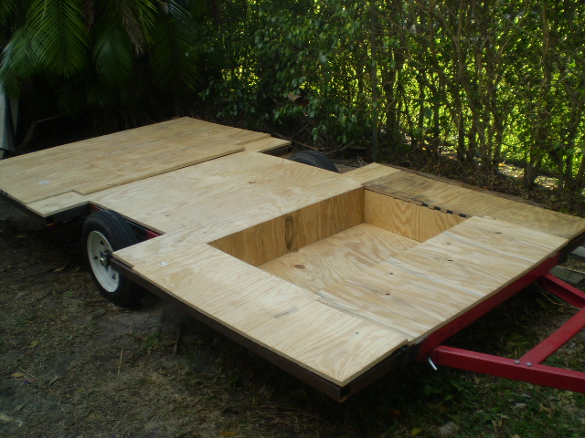

Dropped floor ( I'm 6' and my GF 5'11")

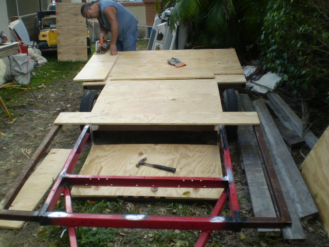

Dad helping me out

Postby Ageless » Fri Nov 06, 2009 9:21 pm
I see 5 lugs on that Falcon; so what else is it running? I've had quite a few Falcon's thru the years and the little six is a good motor but not made for towing

Postby pbrunicorn » Fri Nov 06, 2009 10:42 pm
What size and wall thickness is the square tube you used for your extensions?

Postby xzerokidx » Fri Nov 06, 2009 11:30 pm
Ageless wrote:I see 5 lugs on that Falcon; so what else is it running? I've had quite a few Falcon's thru the years and the little six is a good motor but not made for towing
I rebuilt the entire front end and put in granada disc brakes, the rear end is from a 65 mustang V8 car. The drivetrain from a 68 stang, C4 automatic.
The motor is a 6, but not the 144 that came in the falcon. A 200 cube with supposedly 120hp and 190tq. Aluminum radiator, trans cooler, New 5 leaf springs in the rear etc. Doing what I can to bump towing capabilities.
The square tubing is 2x2 11ga
