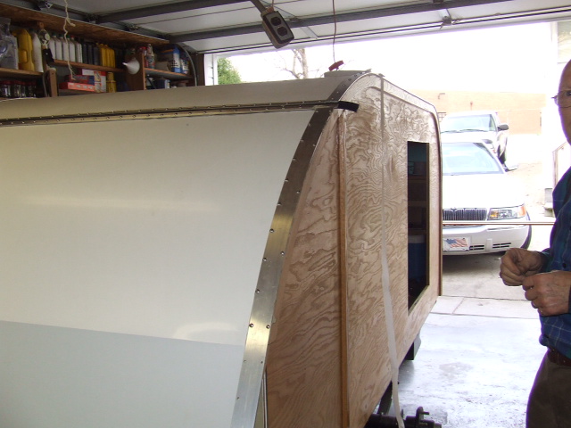

Ceiling and roof are not installed. Used 1.5 inch aluminum flat stock with screws every three inches. Sealed with butyl tape. Looks pretty good. It has been slow moving since I started back to work, but I have three days off this week and hope to make a dent in it. I have posted a few new pics of the build. Thanks Greg :thumbsup:

shortgmanp, did you lay the roofing material right onto the spars and insulation? Is that painted aluminum? Just curious.

I layed the roof directly on the spars and insulation. And yes the aluminum is painted with a semismooth pearl white paint. My dad's good freind has an aluminum siding company. I was set on just bare aluminum until talking to him. He had a roll of this painted aluminum and told me that he would sale it to me for 20 bucks for what I needed and have his men help us put z strips in the joints and seal it for us. Hey I could not say no to that, so it is white. Beats the heck out of 150 bucks for bare aluminum. I am so grateful to find a deal like that. We tipped the guy who helped me, so the total cost was 40 dollars. Not bad :awesome:
