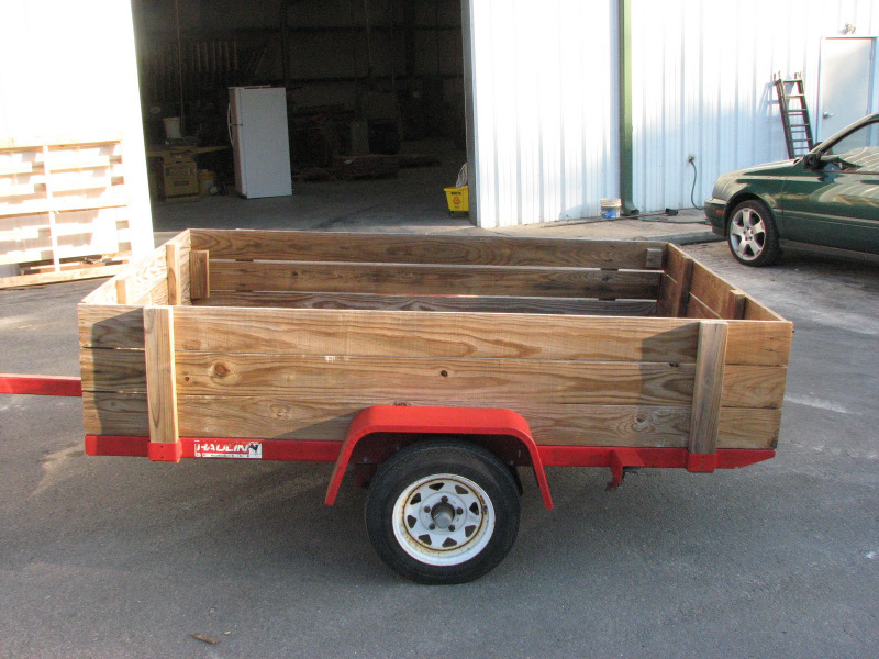

Last Friday, I drove down to Columbia South Carolina where I met a really cool guy that was selling his project. He had gotten into Teardrops a while ago, and this was his first one to build. He bought a 5x8 trailer from his buddy for $100. That was a pretty good deal!

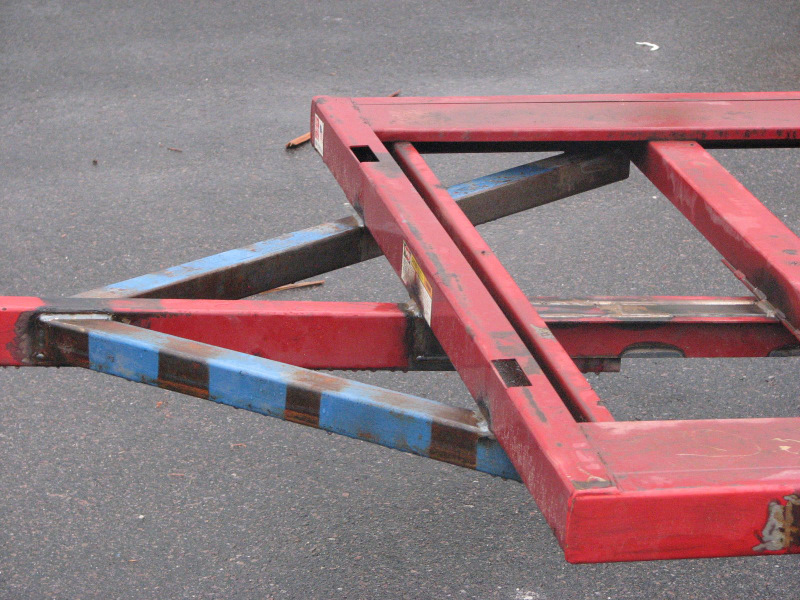

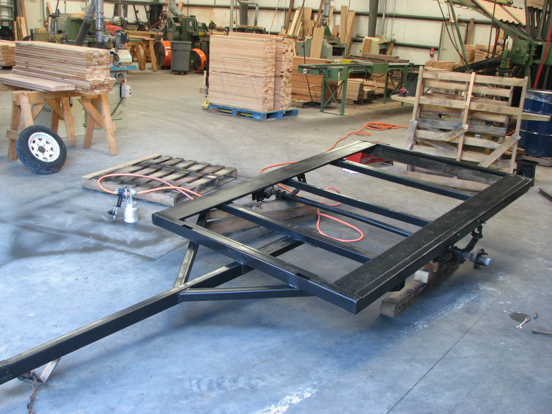

Then, he strengthened the tongue.

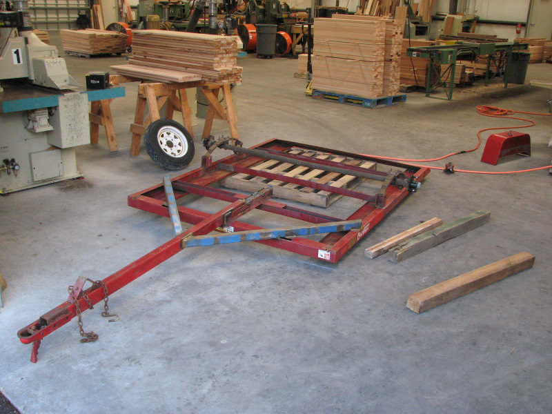

Then he disassembled it to paint it.
He also added 2' to it to make it 5x10.

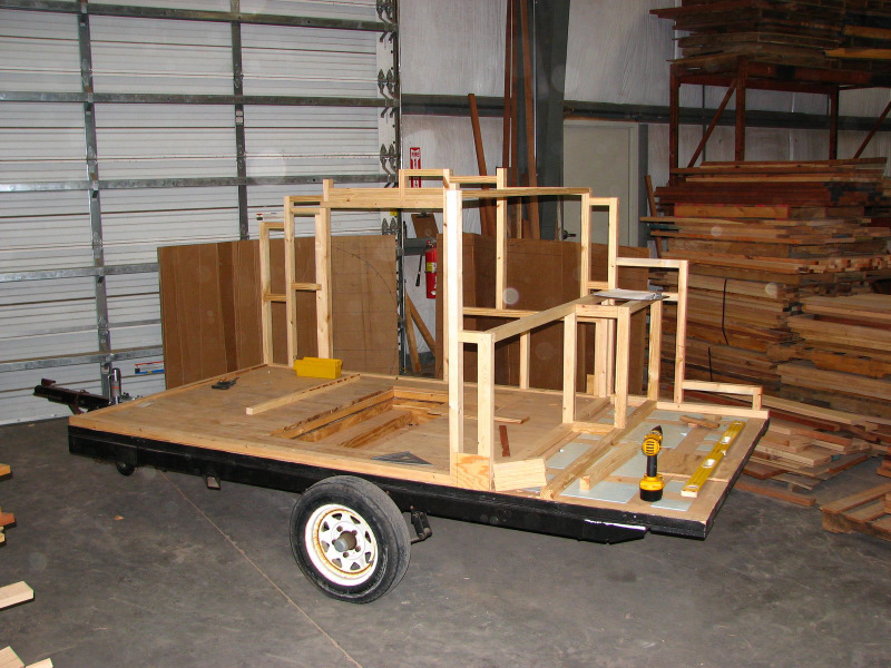

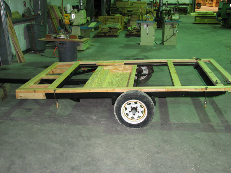

Then, he started framing it.

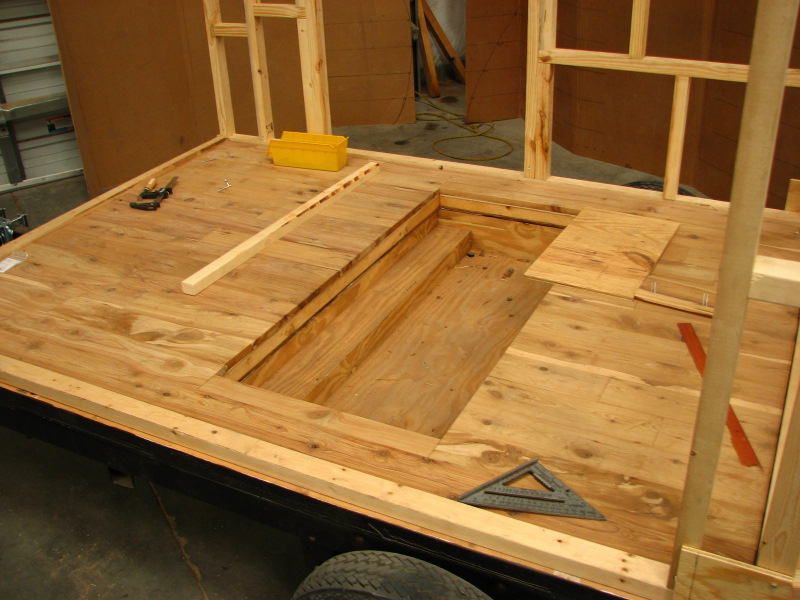

He put Australian Cypress hardwood flooring in it. He works at a hardwood flooring place, so that was a sweet deal. I don't think it cost him anything. He also added this "cubby" hole in the bottom. His plan was for storage as well as a really cool table. He wanted to get a special mattress made that was split in half. When not in use, it could be doubled-up and made into a couch. The "table" would open up, and you could sit on the couch with your feet in the hole and the table to eat on or play cards or whatever. I thought it was a great idea for rainy days or whatever. My wife isn't too sure about the split mattress though.

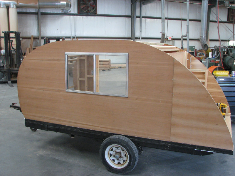

He added the sides which are American Cherry.

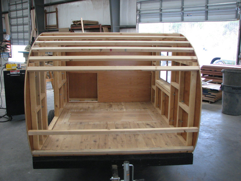

Then, he cut the hole for the window and installed it. It is single pane glass. Will that insulate enough?

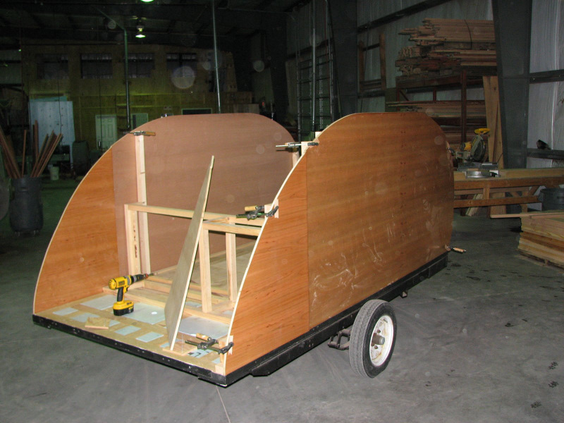

He started putting the ribs up. You can see the compartment in the back wall for the 2 12volt batteries he was planning on using. The plan is to have an access panel from the interior if there is a need to get to the batteries.

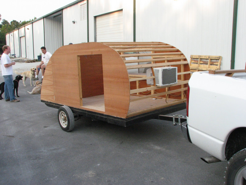

He took it home to his house to wire it up. As you can see, the A/C is in the front. I'll have to build some type of box to cover it when not in use.

Postby Ageless » Thu Dec 17, 2009 2:40 pm
The floor looks a bit heavy, but it appears that truck will have enuf power. Gonn look awesome when finished! I bought two boxes of clearance sale laminate flooring for mine.

Postby Cliffmeister2000 » Thu Dec 17, 2009 4:12 pm
What a great start, Matt!
About that window, that looks like a standard house window. It could be quite fragile for the application. I would worry more about that than how many panes it has.

Postby DasBaldGuy » Fri Dec 18, 2009 10:55 pm
Seems like a very good price!
I would remove that window though, it doesn't look like tempered glass and is probably for "office" or "House" trailers, not campers.

Postby S. Heisley » Sat Dec 19, 2009 10:28 am
DasBaldGuy has a good point. If the glass is not street legal, do whatever works for you and your state DMV.
Here are a couple ideas: There's a film you can purchase and apply. Check with your local hardware and/or glass store. The stuff is used on old sliding glass doors in some parts of the country, to make a home legal to sell without replacing them. Using this film, all you are trying to do is to be certain that, if the window breaks, the glass shards are contained so that it doesn't cut anybody or puncture anybody's tires. ...Or, you might be able to take the window to a glass shop and get the glass replaced. ... Or go to the hardware store and get some Plexiglas and do it yourself. Again, do what makes it legal in your state, if there are rules on that, and whatever works best for your situation.
As far as whether you'll be warm/cool enough, you can always buy and modify some insulated curtains for the window...Not a big deal.

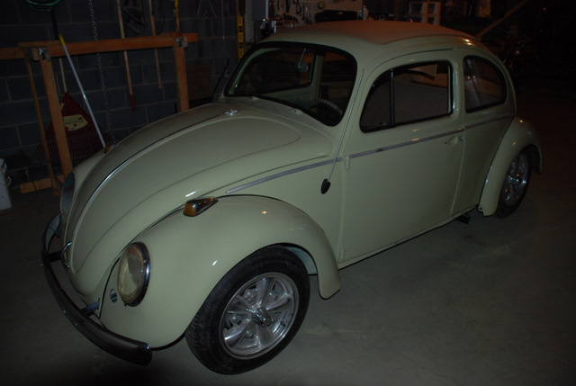

So, I'm just about finished with my '63 Volkswagen Beetle, and that means that I'm about ready to start work on the Teardrop. Because I've never built one before, and because this is someone else's project that I am taking over, what's the next step? Do I buy the inner ceiling and put that up, run the rest of the wiring, put insulation in there, and then put the roof on? Give me your experience and words of wisdom. Thanks in advance...
Here's a picture of my bug...
