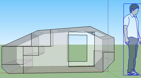

Design: Image

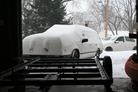

Semi-Gloss Black: Image
with my tow vehicle in the background (1990 Volvo 745 GL), piled with 8 inches of snow. Gotta love space heaters.

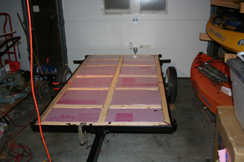

Floor: Image
22/32 Pine ply on the bottom, sealed with polyurethane, then enamel paint, then rubberized undercoating. 1x3 studs and 1/2'' foam insulation. Will be topped with birch when finished. Image
