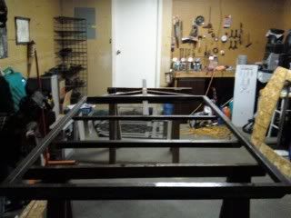

Hello everyone! This will be my second post here and the start of my first build! (ok, now a plan that I have had some time to think about and have decided on something different) I found the site from a link on another forum that I visit. I will be using a trailer that I started building for an ATV and never finished. (Same trailer but whole new direction. See bottom of thread for more please.)
The deck of the trailer is 4x6 right now, I will be extending it 1' and widening it by 1.5'.

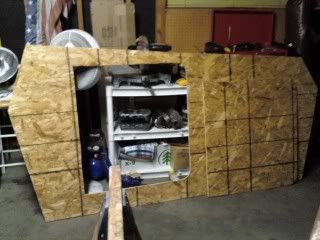

Here is a pic of the template that I cut out earlier today.

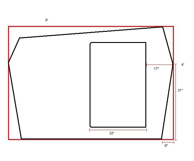

Here is a quick draw up of the plans in my head!
Excited to get started on my very first Tiny Travel Trailer!

And now, as I have been thinking about it all night, it's time for some questions.
1. Could I get away with using OSB for the sides, front and rear, and the top if I skin it in something like 1/4" ply?
2. I want to use 1/2" x2" pieces for the spars and on the inside of the walls. Then I will insulate it with 1/2" foam. Would this be acceptable?
3. I am wanting to avoid going and buying more steel to add that little amount to the frame. Could I build the floor frame to overhang the steel frame and be ok?
I guarantee that I will come up with several others, but this is all that I can think of right now. Thank you for any advice for a true NEWB :guzzle:

Postby Ageless » Wed Jan 13, 2010 11:23 pm
Since you will never be standing on that overhang; a good floor will suffice. Lay a sheet of 1/2" ply on sawhorses and stand on it; it will deflect. But if you lie on it; it will hardly bend

Postby bobhenry » Thu Jan 14, 2010 8:44 am
No galley ?
Just a sleeper ?
1/2" insulation in Idaho Brrrrrr !
Are the wheels outboard of the 4' or are they underneath the trailer frame. Can not tell by the pics !
5'6" wide by 7' long by 4' tall ? Kinda like me wide as I am long.
Looks as if you could cantaliver a foor forward and 2 foot to the rear easily giving you a 9' trailer. Osb is available in 4x9.
If you look in my album way back there are some shots of my spars and how they were installed. I used 1 1/2 x 1 1/2 southern yellow pine ripped from 2x12's ( about 50% stronger than pine,fir) Remember you may be drilling thru the spars for electrical wires and an extra 1" of insulation will be welcome in the heat or the cold.

Postby toypusher » Thu Jan 14, 2010 9:25 am
If you are going to use OSB, I would recommend that you be very careful when doing the waterproofing on this. OSB when wet will rot very quickly and just fall apart on you.

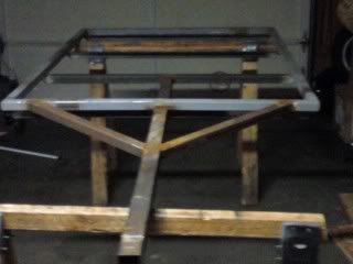

Postby bobhenry » Tue Jan 19, 2010 2:22 am
newbuilder wrote:I was just looking at axles and seen a half torsion axle http://www.southwestwheel.com/store/p-2316-935-lb-torsion-half-axles.aspx
Does anyone have any experience with these? Looks like they should work.
$ 182 :shock:
add $17 and you can have the whole damn trailer ~~~lights , safety chains , hitch and all !

Postby vwbeamer » Fri Jan 22, 2010 9:49 am
apples and oranges. The flex half axles allow you to build any width, and the trailer can be made lighter, sit lower and will ride better.
I can use a pair of 2 dollar plyers to lift the lid on my dutch oven, does that mean the plyers are better?
