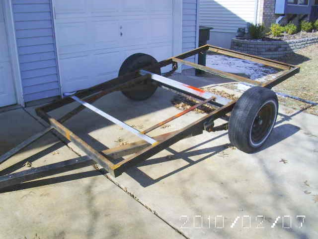

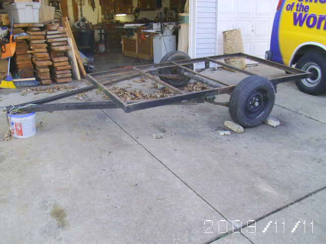

Finally started my tear build about a week ago. Started with a trailer I got off craigslist for $125 back in Nov. '09. It's going to be a 5x10 in the style of Mike's Lil Diner.
Had my brother in law modify it for me to accomodate a drop down floor. Still need to sand and paint it.

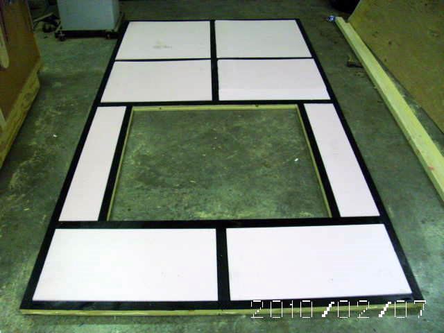

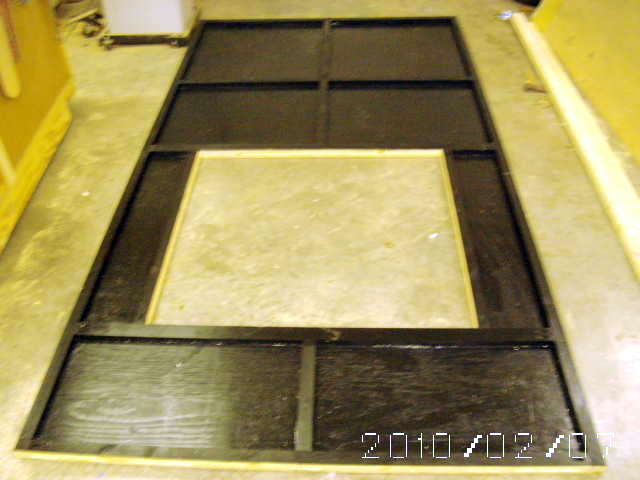

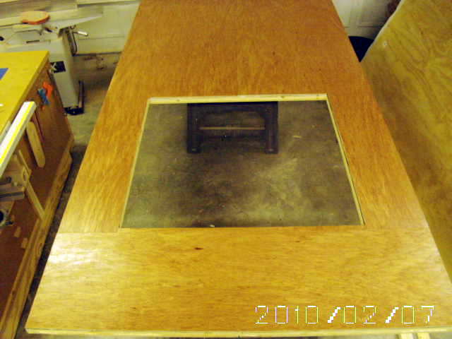

I ripped down 2x4x10's down to a true 1" thickness, used gorilla glue and pocket hole screws to assemble sub frame, glued and nailed 1/2" ply to the wooden frame and painted with black acrylic paint.
I then filled in with 1" pink foam insulation.
Today I added 1/4" luan to the bottom for a sandwiched floor and coated with spar varnish. It will get 2 or 3 more coats of varnish to protect the bttm. I did not want to use the black goo.

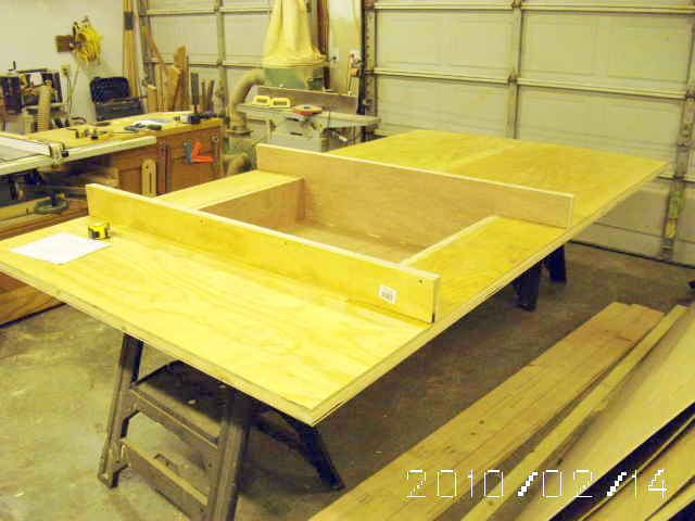

Postby rwelp » Sun Feb 14, 2010 11:29 pm

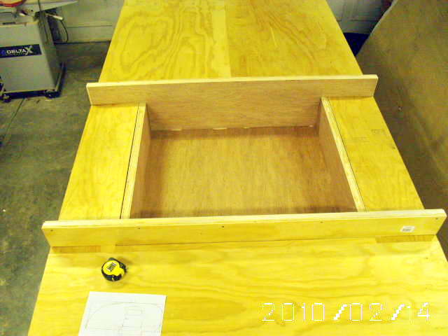

Got some more shop time in today and finished the drop down floor with walls for the raised bed. I built it just like the floor with sandwich wall construction with insulation. Hopefully tomorrow I'll get it bolted to the trailer frame. 8)

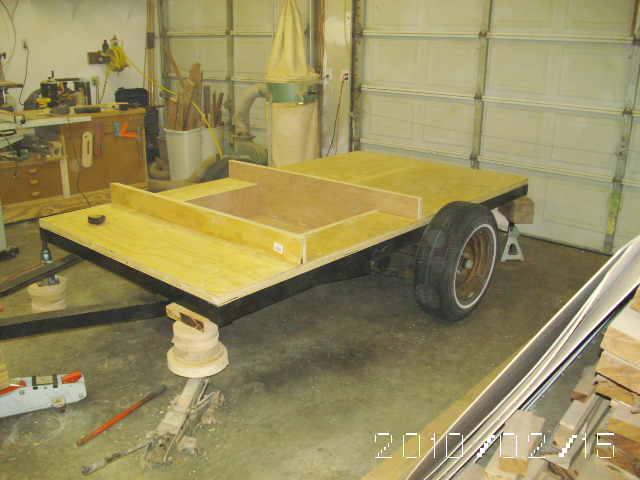

Got the floor mounted to the frame today. :D Image

Postby Rigsby » Wed Feb 24, 2010 1:01 pm
Loving the build, but mite the corner steadies be a bit of a pain when camping? lol

Postby rwelp » Wed Feb 24, 2010 10:06 pm
Rigsby wrote:Loving the build, but mite the corner steadies be a bit of a pain when camping? lol
steve
I guess they would be if I left them that way, but I'll get around to putting jacks on them eventually, if I can find 'em cheap enough. LOL

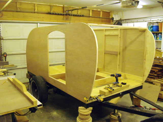

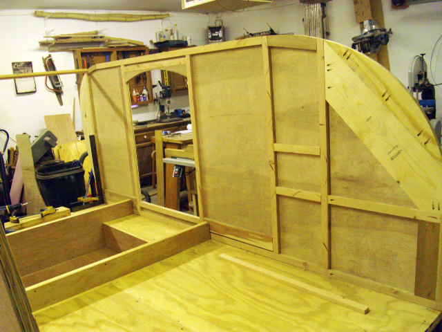

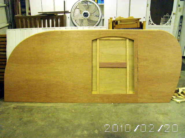

Finished cutting out the side profiles and framing them today. Hoping to get them onto the trailer tomorrow. 8)

Postby bve » Mon Mar 01, 2010 9:13 pm
Nice, I like the profile.
What are your overall dimensions? It looks like you are close to 11'.

Postby rwelp » Mon Mar 01, 2010 9:48 pm
bve wrote:Nice, I like the profile.
Burke
4' tall x 10' long.

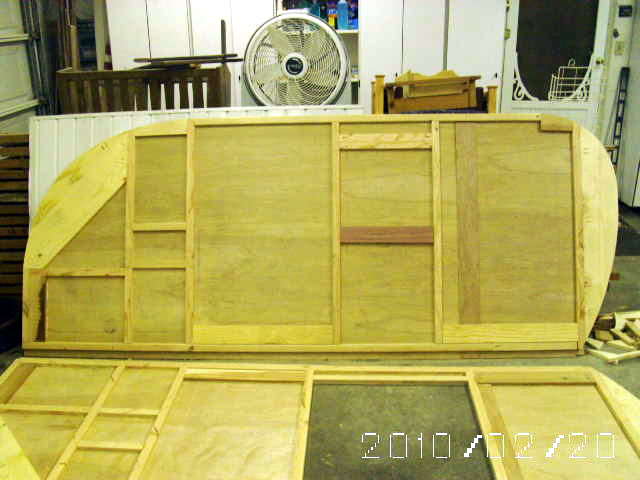

Postby rwelp » Tue Mar 02, 2010 11:27 pm
Dry fitted the walls tonight. didn't have much time to get them glued permanently. Hopefully I'll have more time tomorrow night.
