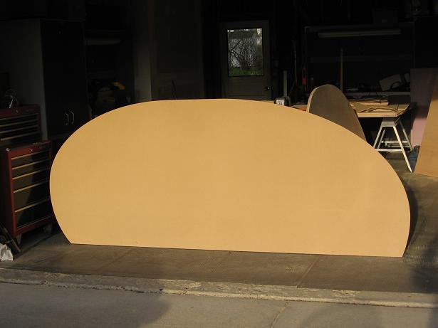

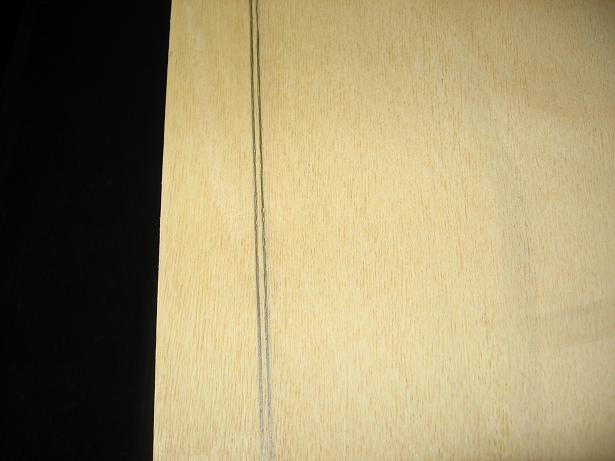

Sharon, my teardrop will be 10 feet long, 4 feet high and 5 feet wide. I am using the Grumman 2 specs that are in the design library exactly as they are. I really like the profile and with the measurements in the pdf it was very easy to draw out. here is a picture of the template I made.
John

Grumman 2 template image
Postby jamwius » Wed Apr 14, 2010 9:11 am
Forgot to press the Img button in prior post.

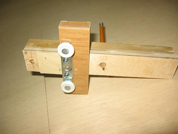

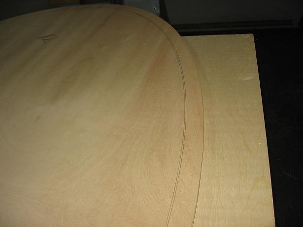

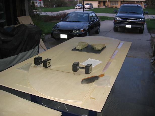

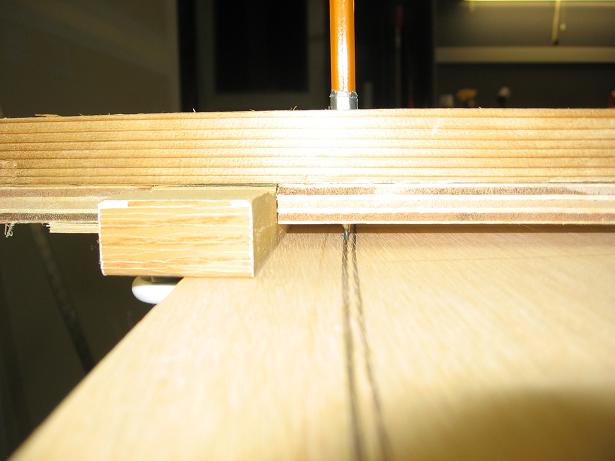

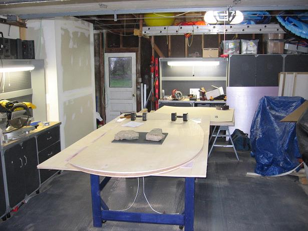

This last weekend I finished up the floor and I think it turned out nice. Very solid once it was all glued up. I also made a jig to draw lines on the side profile curves where the inside roof will be. What I plan on doing is draw a line the depth of the spars then draw a line the thickness of the inside roof which will be 1/8" birch. Then take a jig saw and split the lines and belt sand back to each line making room for the inside roof. Don't know if I explained it well but I will take some pictures when I do the actual cutting. The jig idea was from another teardrop maker and here is his website. It worked great.
John
http://www.richardflake.com/galleyhatch.htm
Here are my pictures from this weekend.
