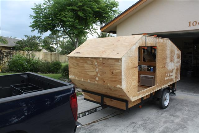

Postby Rigsby » Wed Apr 28, 2010 5:31 pm
I cant answer the cpes question, but looking at the picture, your tongue looks a bit weak for the build. Maybe you could put a couple of braces in between the hitch and the frame

Postby PapaJ » Wed Apr 28, 2010 7:59 pm
I hadn't thought about just using the cloth at the seams. I kind of like that idea.
I haven't gotten the tongue weight yet, but the trailer is pretty well balanced. Although, I've talked to a guy about welding a couple of pieces to reinforce it.

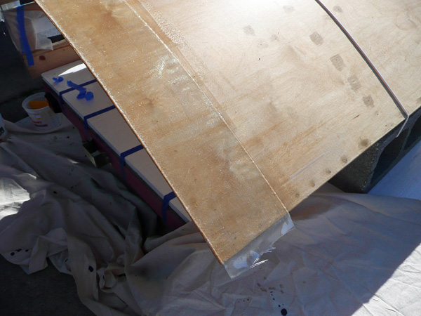

My 2 cents on fiberglassing seams - definitely use the tape that has selvage edge. this WILL keep it from unraveling and stray strands from working loose. I thought I could save a few $$$ by cutting my own from fiberglass cloth - what a mess.. If you are making short runs on seams, cut the length you need, then dip it in epoxy for maximum saturation then apply over the seam, squeegee out any excess. Please note that fiberglass does not like 90 degree angles, so a gentle curve many be necessary on the edges or you can use filler to get a square edge
. . .and you get nice edges like this:
