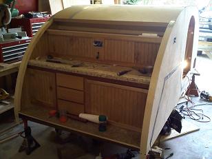

Postby grizz » Sat May 08, 2010 4:43 am
No messing about there then.....
Lovely galley.

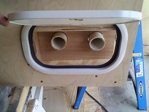

Postby prohandyman » Sat May 15, 2010 2:23 pm
Update to build - hatch installed

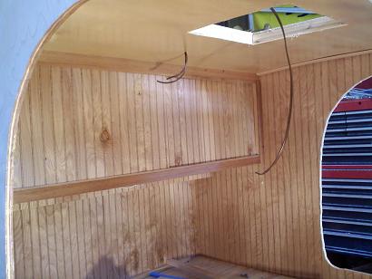

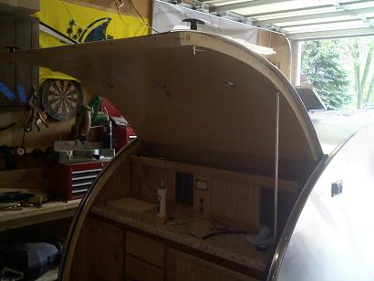

Postby jamwius » Sat May 15, 2010 4:26 pm
I like the interior you picked. It looks nice. I see you have a vent on the headboard. Curious to know how is that hooked up?

Postby prohandyman » Sat May 15, 2010 6:54 pm
John
The lady I am building this for wants a Petcool. The hook-ups are here behind this access door
and the ducting is thru the bottom of the forward cabinets and then up thru the wall cabinets to the vents. I fabricated an aluminum register box an attached it to the vent and 2" pvc. Of course that was after I puchased, modified, adapted and eventually tossed out a floor sweep head for a shop vac, trying to make it work for a register box.
Since only one pvc duct continues past the first tall cabinet, it allows for some storage under the hinged center panel with cup holders. The tall panel behind the center vent hides the LED lighting and reading lights

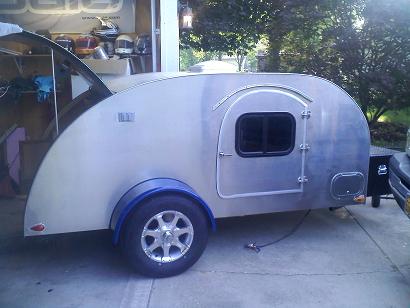

Postby teardrop_focus » Sun May 30, 2010 11:34 am
Dan! That's a great-looking trailer! Is is a "tenner"?
:thinking:
You do great work... I first noticed when you finished the '47 Kit.
In the pic above grizz'a post... that's the fender I want to use, and the tire-to-fender gap is about perfect. You using a torsion axle?

Postby prohandyman » Mon May 31, 2010 7:56 pm
Thanks for the kind words.
Chris
Those fenders are are 10 3/4" x 32" 16 ga. Painted with automotive base coat/clear coat. And yes I use torsion axles.
