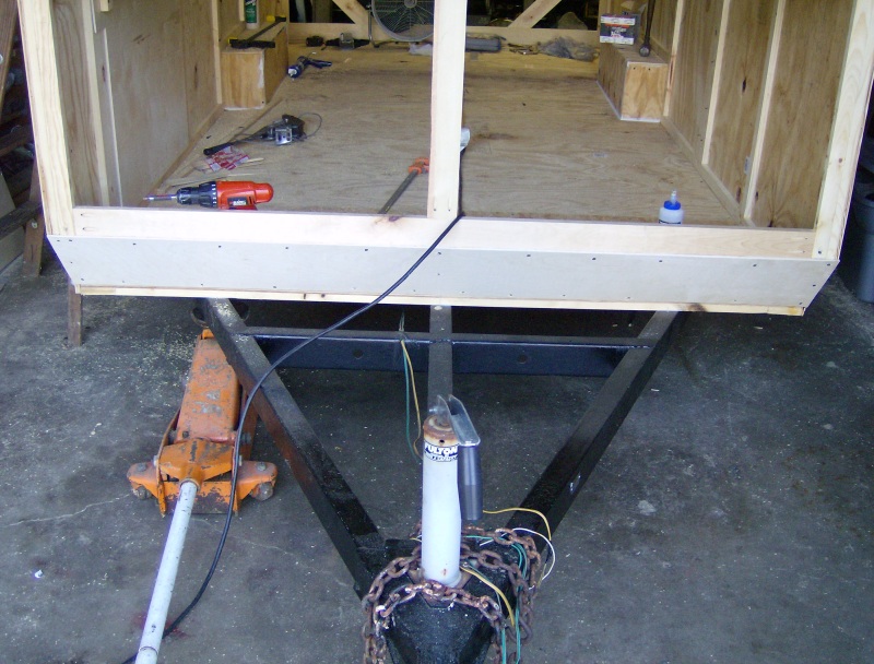

Te Frame started life as a camper of some sort, then did a stint as a boat trailer, thats how she was when we got her.
Her my oldest Boy is Grinding old welds so the floor framing will lay flat on the rails.

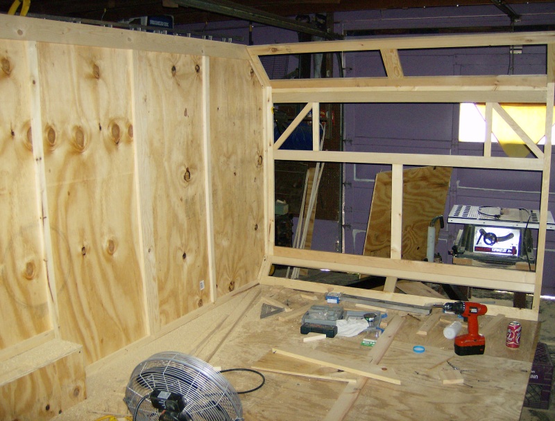

Then we built the framing and covered with 1/2" Ply.

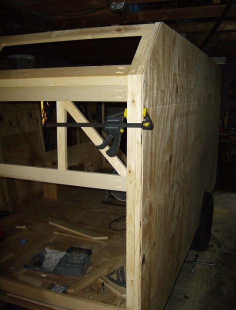

A few pics of the framing for the walls and front.
Starting to skin the front.

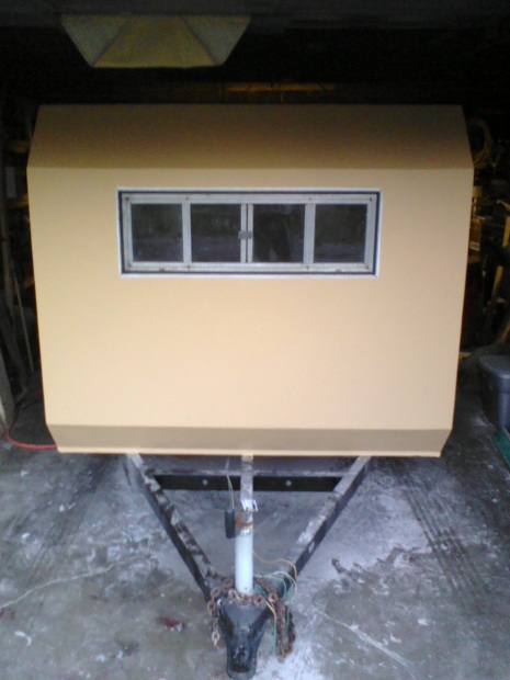

Front skinned, painted, window installed.

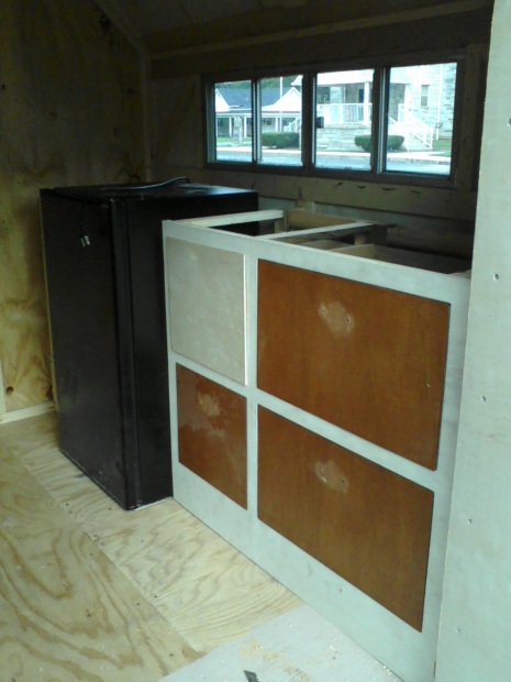

Cabinet, and Fridge test fit.

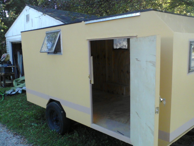

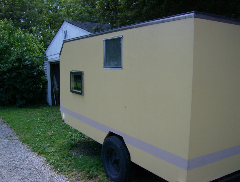

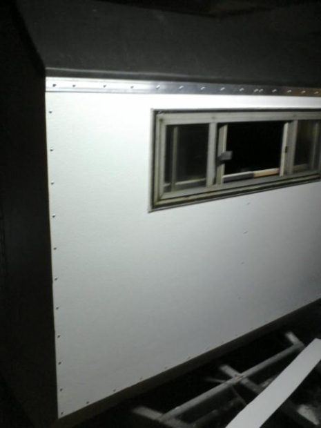

Side view with window in.
Thats how she spent the winter. Just wanted to get her under some paint so she would hold up to the weather a little better. She had to winter outdoors.

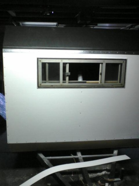

After a long cold winter we started to get her finished. putting filon on the outside.

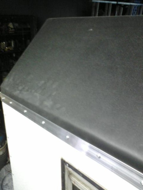

EDPM Roofing was installed

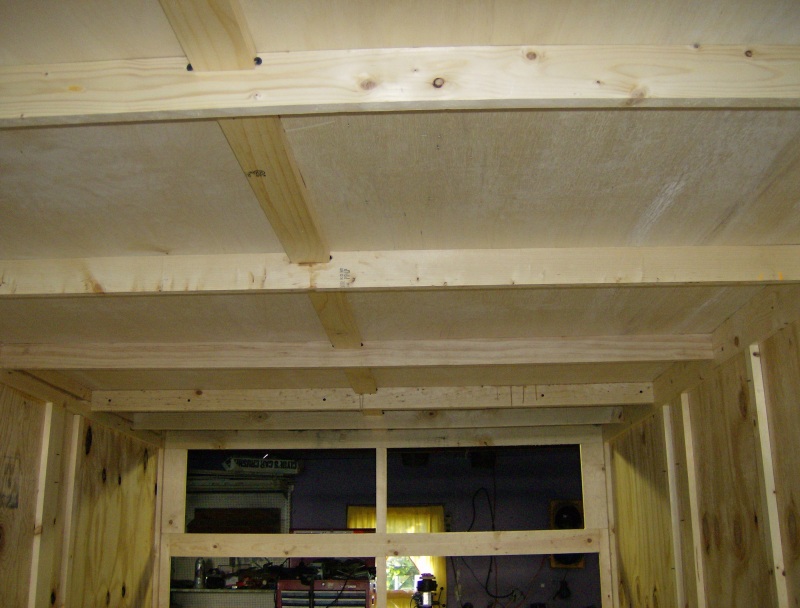

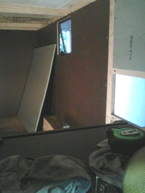

And we started insulating and paneling the inside.
We will be taking her on her maiden camp out, over the 4th of July weekend to Holiday World. She might not be compleatly finished then but she will be really close. for now the exterior sides will stay painted, planning on putting the Filon on a sheet at a time until she is done.
Also in the last pic you can see the cutout for the A/C.

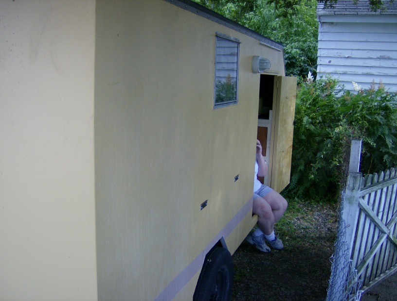

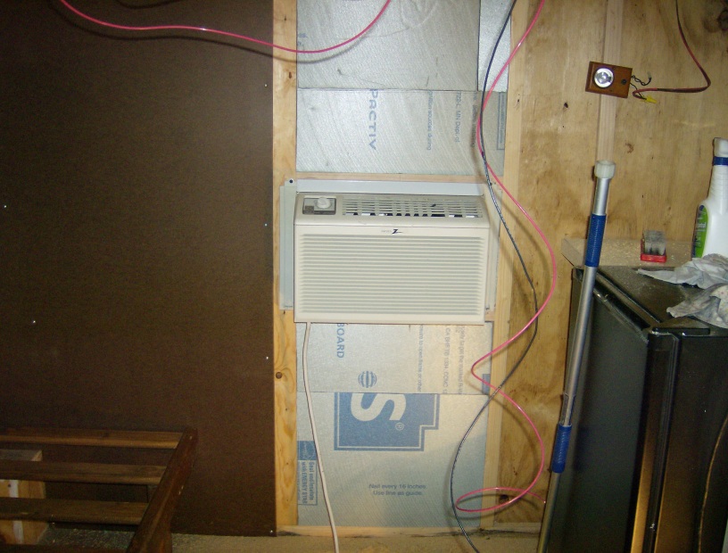

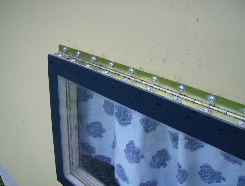

Here is where the A/C mounts.

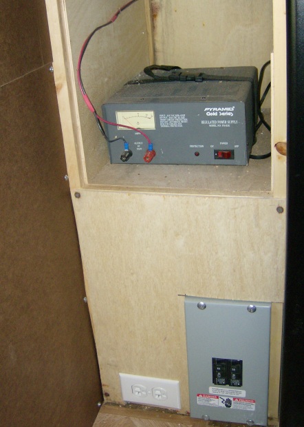

The power center, 12 volt power supply, circuit breakers and plug in for A/C

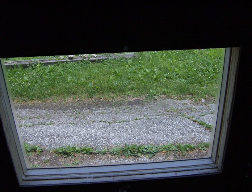

A/C opening from inside, swing out window.

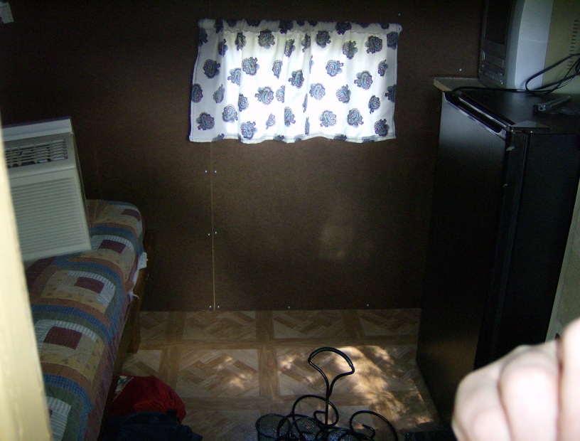

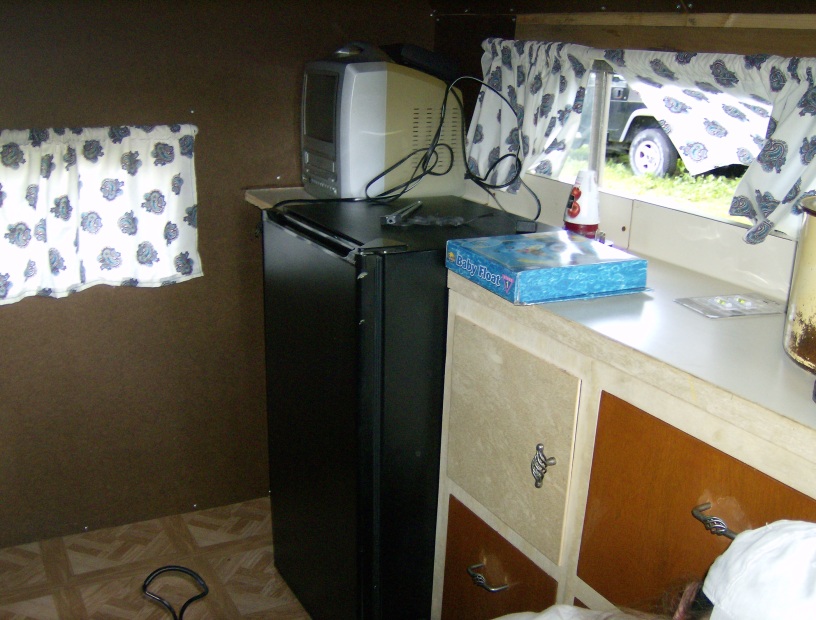

Fridge and cabinets, A/C window to the left.

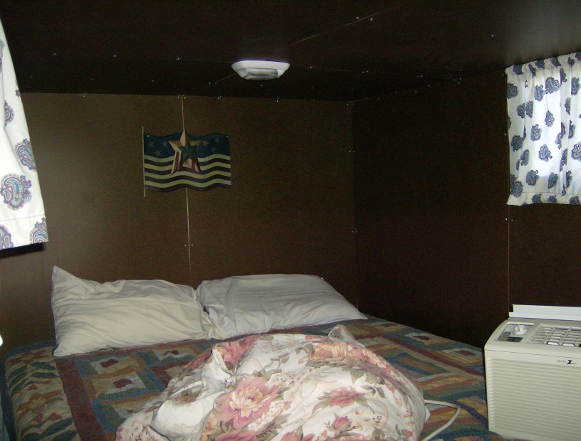

Bed and interior.
Curbside showing porch light and Table mounts

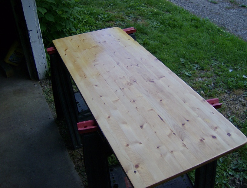

And table

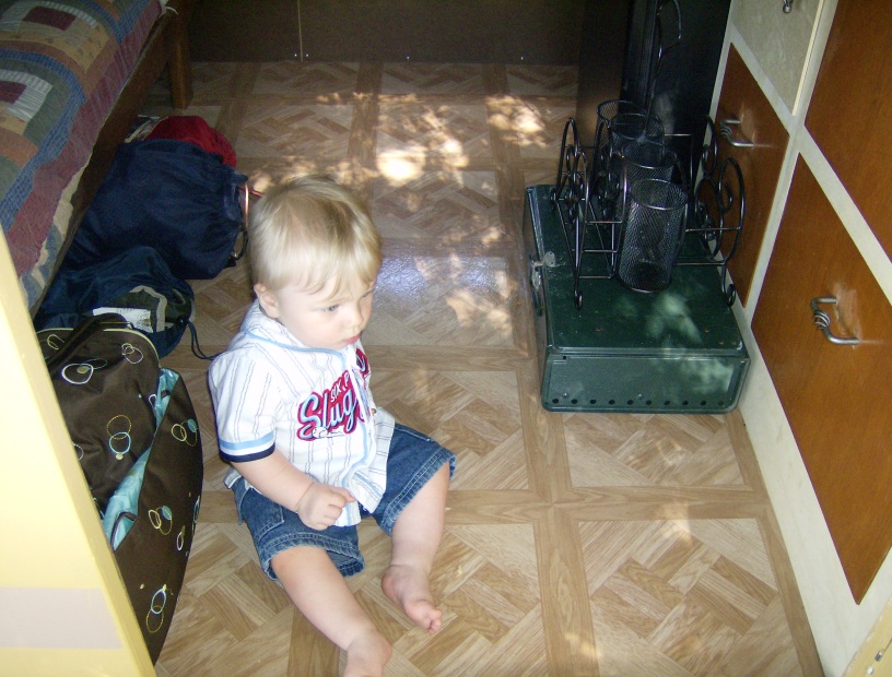

Little A inspecting the floor
