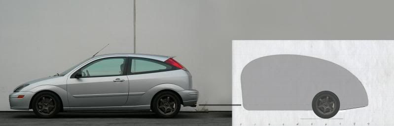

After hacking out a few teardrop profiles with pencil and paper I've come up with an almost-decent profile, and with the help of my friend Rocco, we got the profile drawing into a photoshop'd pic of my tow vehicle... a 2.3-litre-engined, big-braked 2003 Ford Focus ZX3.
Trailer wheels will be different, and the profile's underside rear angle will be modified...
The car has a (North American market) tow capacity of 1200 lbs creating a fully-loaded trailer projected weight goal of no more than 1100 lbs (preferably 1000)... 1100 lbs to include full-sized steel wheels and 205/50-16 tires, a 71-lb marine AGM 100 ah battery, 50-something-lb 12V refrigerator, some cast iron cookware and a few Coleman lanterns...

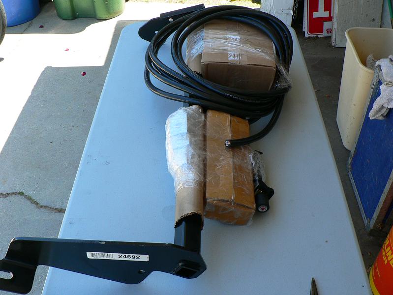

First thing was to get a hitch onto the car and get most of the material to wire it for trailer lighting...
:delivery:

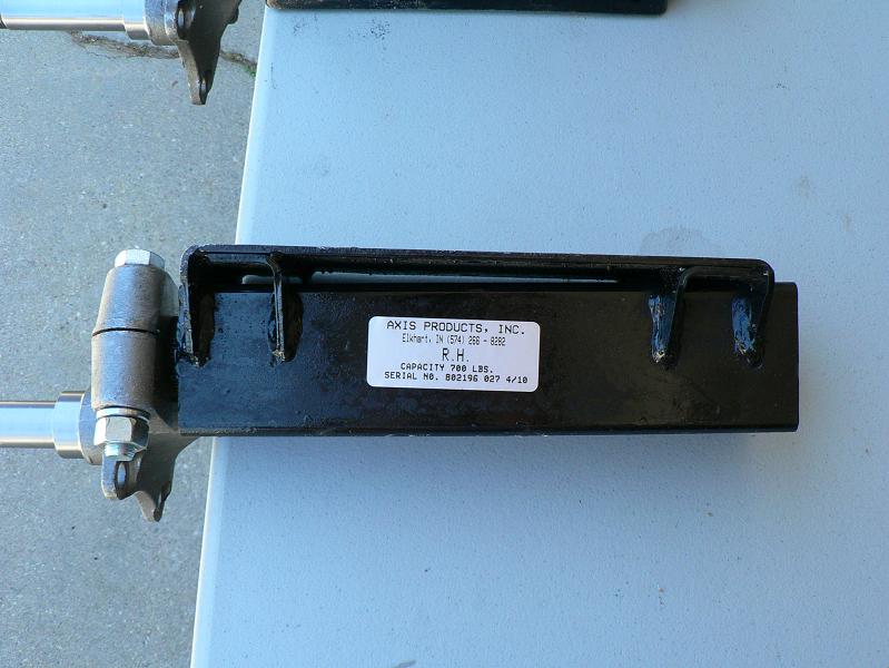

Next, the trailer chassis' suspension arrived. I'll be using a pair of UFC America Flexiride half axles... together as one axle they are rated for 1400 lbs.
When choosing a rubber torsion axle, it is recommended to consider the maximum load/maximum trailer weight, then multiply by 125%...
In this case the maximum load will be 1100 lbs, 125% of which is 1375 lbs... about as close as we can get w/ the Flexiride offerings.

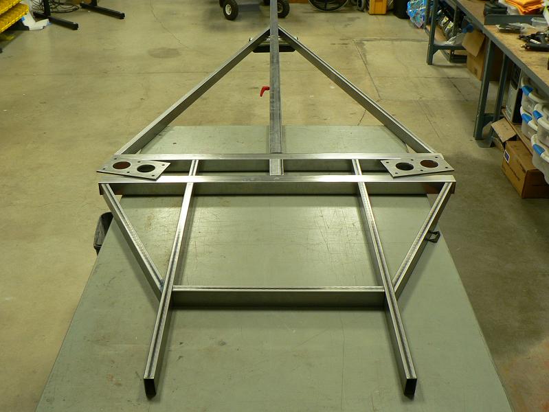

Although I was reluctant to post pictures of this chassis design until it was actually welded together, it was a recent post in a Trailer and Chassis Secrets thread that has prompted the release of this now de-classified material... Image
Here's the foundation of the T (Teardrop Camper) - 49 (4' wide x 9' long) Spirit of Muroc...

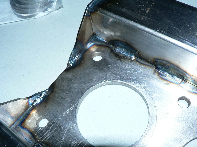

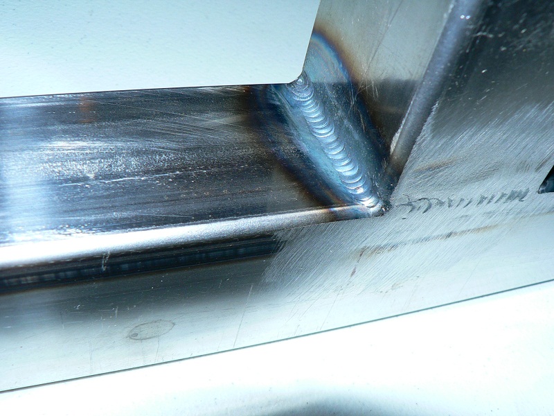

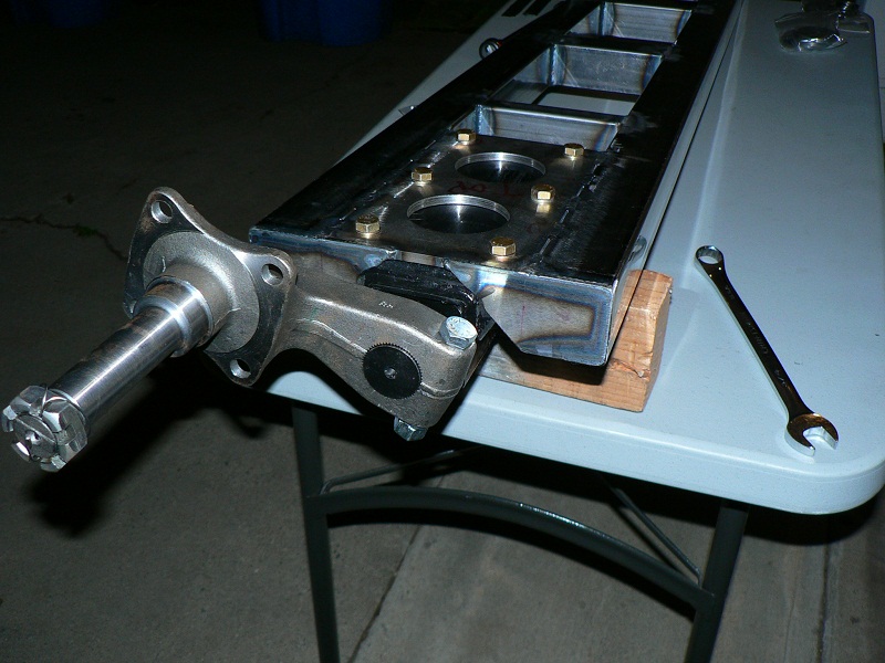

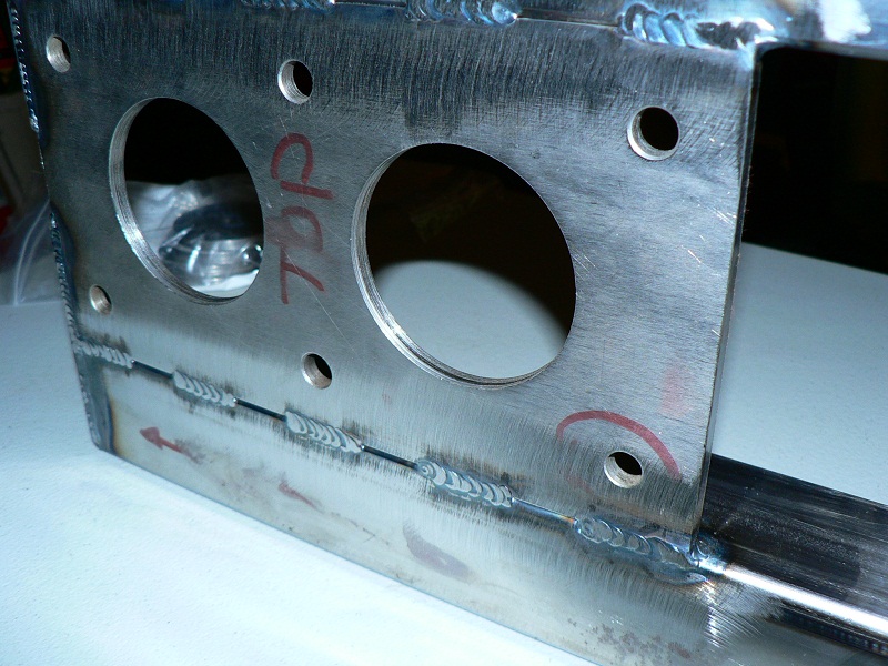

The Flexiride half axles will be placed as high within the chassis framework as is practical and bolted to these 1/4 inch steel plates... These mounting plates will be welded flush to the top surface of the dual crossmember's 2 X 2-inch 14 guage mild steel tubing. The additional 1 X 2 is also 14 ga mild steel.
I've been told that this is a tricky configuration, welding-wise. I may have to make some brackets to be welded the opposite (bottom) side of the 2 X tubing - but which will clear the torsion half axle boxes - to minimize warp.

A hearty thank you! to Anton and his boss Dan for letting me spend time cutting steel in their shop, and to Chris Considine at CXC Simulations who has also given me some room for the chassis layout but especially for grabbing the pencil drawing of my chassis design and putting it into a CAD printout for dimensions and angles to cut.

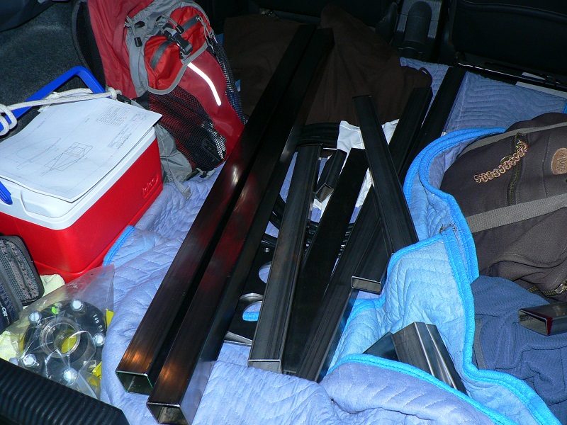

Here's a pile of crossmember bits loaded up for the trip out to the welder; I threw another furniture pad over the pile and strapped the mess down.
I wanted a professional opinion of this portion of the chassis... and if he deemed it sound to have him weld it too. The rest of the chassis tubes will be attached with similar skill by a friend of mine who's a great amateur fabricator, more than likely one night this coming week. Also on the list is to raise the tongue 4 inches.
I thought of doing it this way in order to get the torsion half-axles to ride as high in the chassis as possible, close to the cabin floor for a lower trailer ride height while preserving ground clearance and interior headro0m.
