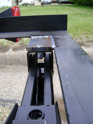

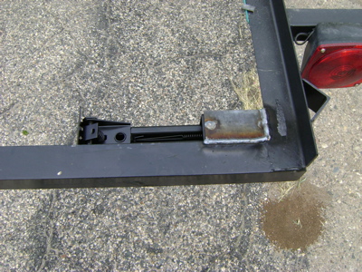

Bought the 5x8 Northern Tools no-floor trailer in Fargo May 15 and brought it to Perham Steel and Welding. There they reinforced the tongue and bed with diagonal 2x2 square tubing. The welder, Kenny, cut through the second angled steel crossbrace and also moved the channels that hold the trailer lights wiring to weld in the reinforcing. You can see pics in my album.
I also asked if they could find a way to mount the plate for the rear stabilizers a little lower so, when I laid the bottom 3/4" plywood base, I wouldn't have to drill out too much so that the plywood would lay flat in the trailer frame.
The guys came up with what I thought was a great solution. I've never seen it here on the forum so here it is. Kenny welded corner plates, then drilled holes to fit the bolt heads with threaded part pointing down, then welded the bolts to the plate, cut off the bolts so that the stabilizers can be mounted below. Here's a pic to make sense of all those words.

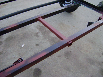

I've also decided to take the trailer back to Perham Steel and Welding and get them to weld a bar with a hitch receiver on the back end so I can put the bike rack back there when I'm traveling, then put the rack on the car when I get to the destination. This next week will be too busy for me to do much, if any, work on actual building, so it would be a lot easier for the guys to weld before any wood gets attached to the trailer.

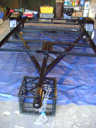

Well, I've spent more money and made some progress on the build, some of it sideways, but it's all progress.
First I got the trailer frame back from the welders with the rear receiver welded on all for the low, low price of $16.71, labor included. Somebody pinch me! Then I proceeded to prime it and any other spots in need of a recoat.
Took almost two cans of black Rustoleum Spray Paint to cover the trailer. My pointer finger was cramping up so I started spraying with my middle finger, and then with my left hand. I ended up eliminated the little white pinstriping on the trailer. Looks pretty bada$$ now!

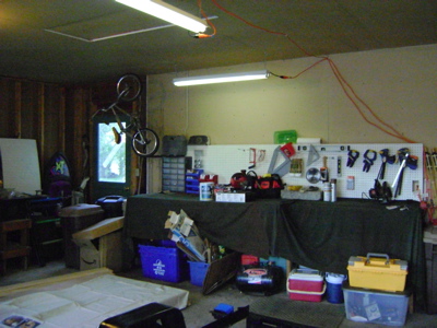

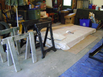

While waiting for the paint to dry, I finished a project begun many years back by another person in this house who shall remain nameless...I put up the pegboard on the back of the workbench. I cut the pegboard to length, mounted a brace between the uprights, painted the pegboard with primer, and screwed the two pieces to the uprights. I also installed the two flourescent fixtures that I had bought seven years ago at a garage sale. Sideways progress is good!
Under the dropcloth are the 4 sheets of 1/2" plywood and the 3 sheets of 3/4" natural birch plywood waiting for me to buck up my courage and start making sawdust. Tonight perhaps.
I ordered the CPES today. Should be here by Friday. I'm planning on building the bottom floor out of 2 sheets of 1/2" plywood cut 48" x 60" glued with PL glue stuff (can't recall the name) and joined with Kreg screws. I plan on covering the bottom with Herculiner. I'm debating if I should wait for the CPES to coat the bottom first, or if I should just go ahead and use the Sealer/Primer I have on hand instead, then the Herculiner. Any opinions? Will either CPES or primer be good enough to seal the join from moisture before I apply the Herculiner? I'm trying to avoid epoxy and fiberglass about which I know absolutely nothing.
