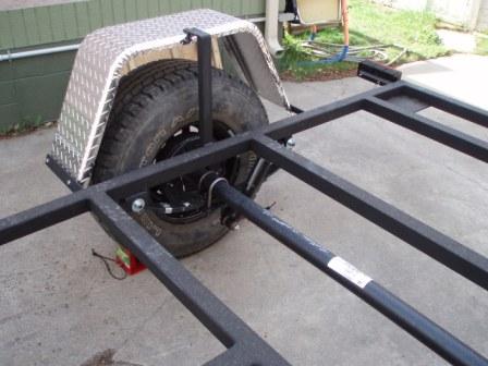

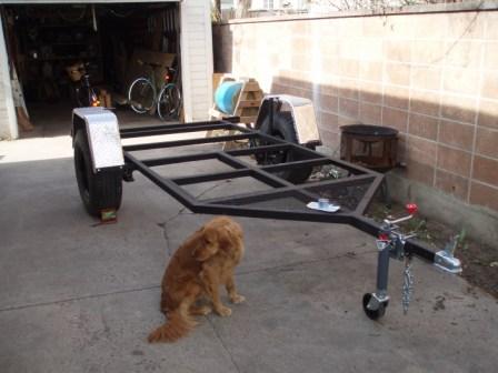

Here are some pictures of my frame, which I had a local welder make for me. I'd like to weld it myself, just lack the tools and space to weld. I got the frame done a while ago, but just finished getting paint on it. It has been a cold and rainy "spring" in Laramie Wyoming.
The golden's name is Ally. Thought I'd get her in the shot so I'd get more reply's to my post.

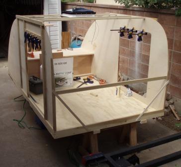

Construction of the teardrop body is happening off my trailer right now. The reasoning is to have a little easier access behind my fender supports to work and attach my walls.

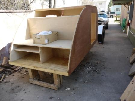

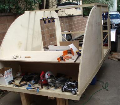

Here is a view of the galley area, which is a convenient tool storage area during the build. I don’t have space in my garage to build the teardrop in, so I have to tarp the build after work (and quickly before the afternoon thunderstorms, the joys of living at 7200 feet).

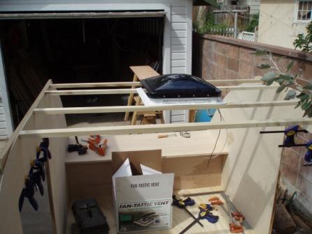

Here is the mock up of the location of the Fan-Tastic Vent.

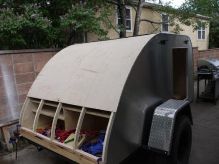

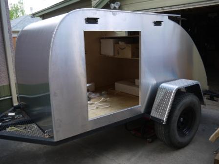

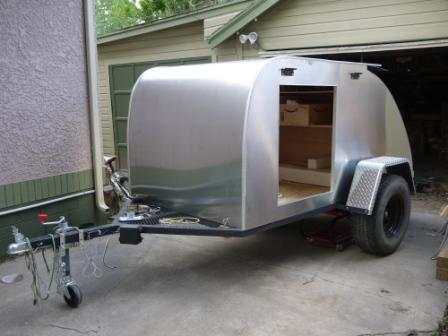

After the plywood went on I coated with CPES, attached the cabin to the trailer, and then started sheeting with aluminum. Almost have the major trim pieces installed.
The black brackets are Yakima Widebody mounts for a roof rack.
Next up is to fabricate the side doors and rear hatch. Looking forward to working with wood, cutting the aluminum with a router just generates so many aluminum chips, not fun vacuuming the driveway. My current goal is a campable Traildrop in early August. I think I can do it as long as Nell doesn’t want to keep doing stuff on the weekends.

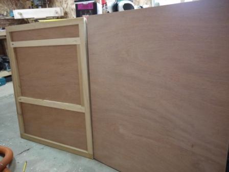

First off, I started on the side doors. Framed up to accept my windows and skinned with plywood on the outside.

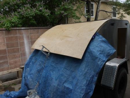

I also started on the rear hatch. To make sure that the hatch fits the opening, I clamped the frame of the hatch to the opening and bent the plywood over the frame. Wetting the plywood with a misting hose worked pretty well and the tarp kept the water from doing undo damage.
And secured with screws:
Just need to add one more piece, but I don’t think it will require as much bending as the radius is less.
