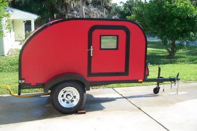

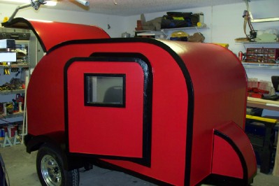

End result.

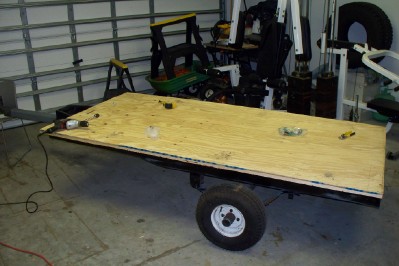

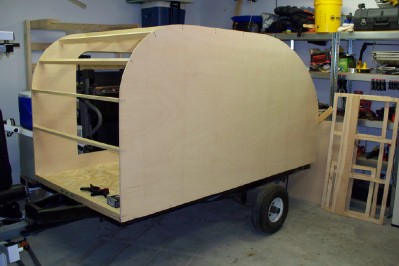

Trailer after bolting on deck, 1/2 ply with 1X4 framing.
Sides on.

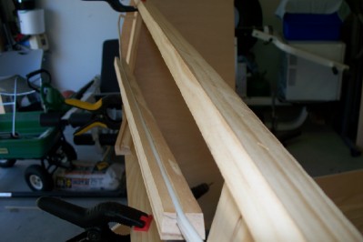

Spars going in, used 1X2s

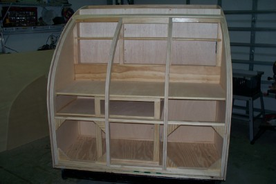

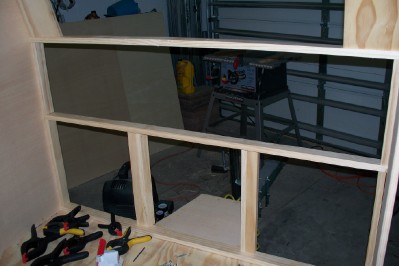

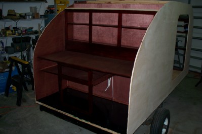

I built my cabs by doing frames and then building rest of cabinet piece by piece, mounting each piece as I went. Probably be easier to build as a unit but was worried I'd put together something wrong and it wouldnt fit since didnt go by any specific plans.

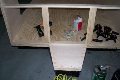

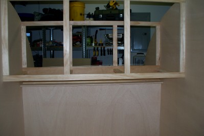

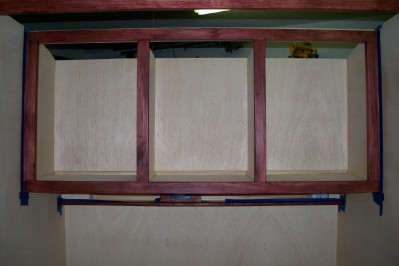

Front spars and a cubby for shelf. Since trailer I bought was a tilt, it had a front area framed so just built on top of that for the shelves. Wasnt doing a tongue box. Tilt was welded so no worries....
Front cubby for inside shelves. Just used ply for "walls" of shelves and then skinned just like the tear. Turned out to be very solid.
Kitchen cabs built same as inside cabs, pieces added as cut. Made some of it harder but turned out ok. Chose not to put cab doors on. May add for inside later but doubt ever will for kitchen. Notice I said doubt, not never...

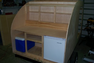

Kitchen finished. Placed fridge and cooler in to see how it would be. Fridge just slides in so can slide it out when camping as it needs more space around it for venting.

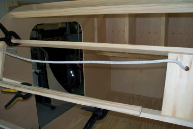

Electrical going in, didnt do 12v. We always camp in state campgrounds so just did 110. Making a track to hide wires since leaving spars exposed.
Pic of wire track to hide wires from one side to another. Did same for wires coming up to first light/switches on the side and just put same on opposite side so was same.

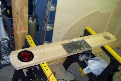

Made a bumper out of a 2X8. Lights including plate light are flush mount. Bolted bumper to rear member of trailer with 5/16 carriage bolts.

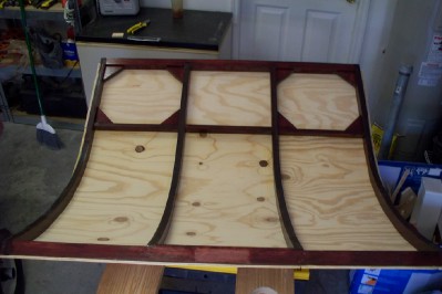

Hatch frame made, probably was most part I dreaded and that took most time in the build. Not as bad as I expected but was time consuming.

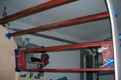

Stained after installing, took more time but was easier since not enough room in garage to have things layed out to dry.
Same. Stained trim in Dark Mahogany while walls and shelves are in Red Mahogany. Contrast looks great.
Stained all then coated with 3coats of polyurethane. Sanded between coats.

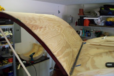

Postby ktnc30 » Wed Jun 30, 2010 9:19 am

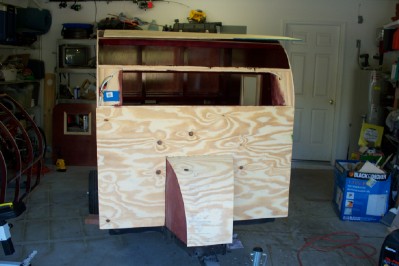

Skinned in 1/4 ply.
Skinned hatch, not as bad as I thought it would be.

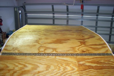

Hatch hinge on. I used a regular SS hinge. Later pics will show how I made it waterproof.

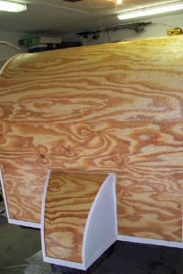

Postby ktnc30 » Sat Jul 03, 2010 6:06 pm

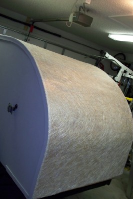

Glassed top, front and hatch. Glass laid out ready for resin.
Glassed.
Glassed using one layer of 3/4oz. mat.

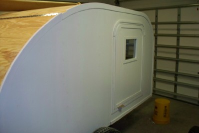

Sides and top coated with several coats of exterior primer.

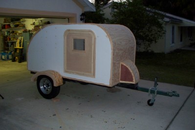

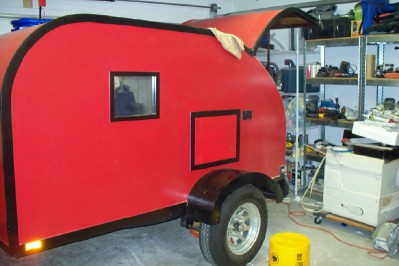

Postby ktnc30 » Fri Jul 09, 2010 8:40 pm

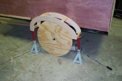

Testing fender frames with a wheel cut out from scrap ply.
Fenders on. New axle from Northern tool on sale, spent 100 on axle and hubs. Looked better with the larger tires instead of the 8" ones. Later sold small axle and tires for 50.
Painted Candy Apple Red, too many coats to count. Red is a hard color to paint, wont do it again. Too much bleed through. Trimmed in black.

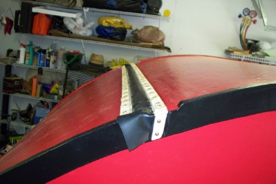

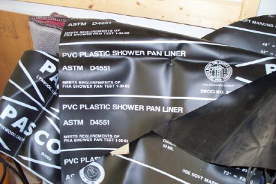

Postby ktnc30 » Fri Jul 09, 2010 8:46 pm
Used shower liner as a seal for hatch hinge.
Just painted wood strips black to match trim. Sealed with clear exterior caulk. Plumbing co. gave me some for free after I explained what I was using it for. Will send him a pic. Big stores only had grey liner. NO LEAKS!!

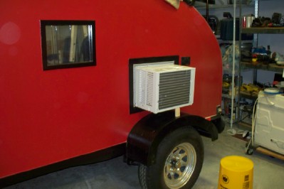

AC
Postby ktnc30 » Fri Jul 09, 2010 8:52 pm

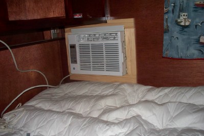

Originally had ducts from a larger ac but was too heavy to take with us. Small one kept freezing up even after adding duct volume so went to this:
Made a cover for opening when not in.
Inside view, need to stain and varnish trim. Doesnt stick in there much so didnt lose much room, maybe a inch.
Keeps it cold, even in Florida heat as long as put up tarp above camper so sun isnt beating directly on it since just 1/2 ply with no insulation.

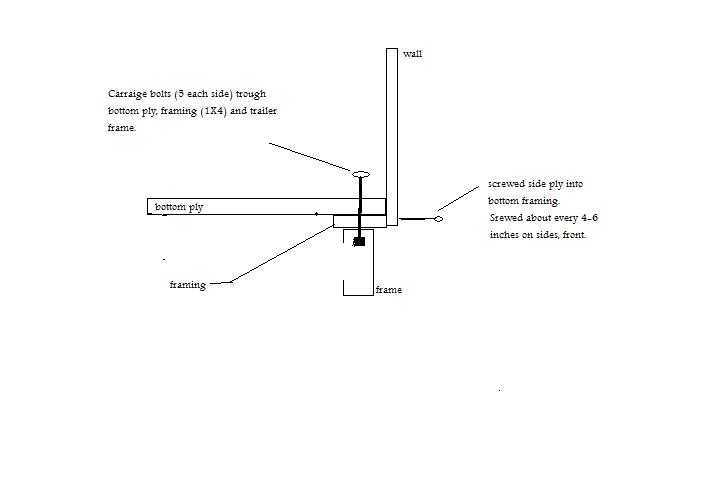

I just checked out your posts on making your teardrop, it's adorable and I like the red even though it was a pain. I would like to know how exactly you bolt the plywood to the trailer frame itself? I don't get that part.
Also, can you tell me does plywood really bend that easily so that you can bend it to make the hatch? I don't see how you get the wood to be curved like that. Any information you could provide would be so appreciated. I want to build one myself and am researching the best way to go about it.

Postby ktnc30 » Sun Jul 11, 2010 12:29 pm
Thanks. Below is a crude drawing of how mine is done, there are many different ways to do it and there is a post on site that shows pictures of different ways.
Bending ply- I used 1/4 plywood on this one. I have bent 3/8 ply on another one I did and it was difficult. The 3/8 was soaked to get it to bend without breaking. The 1/4 bends with no issues. For the hatch, you need to have strong and enough hatch ribs or it will spring back putting your hatch out of whack. I used 1/4 since I was glassing the top/hatch this time. Some types of hardwood wouldnt bend as easily as the pine ply so I went with it.

We used 1/8" ply for our roof and hatch. Bends pretty easily, without soaking, but only in one direction. We used two layers of 1/8". 1/8" ply is not usually at your big box hardware store, need to go to specialty wood shops. We also bought 1/4" bendy plywood, which we used to skin the inside of the hatch. But the quality is not nearly as good, very fiberous, but it does bend very easily.
