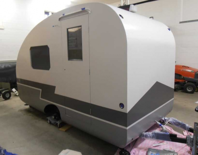

Color begins...
121881
And I figured out the mounting clips for the hubcaps, and installed them...
121878
121880
121831

The paint scheme is done.
Hint:
To get really sharp lines from the painters tape... paint over all the edges with the same base color, and let dry before applying the new color. You have to wait for one more coat of paint to dry, but the results are worth it. No bleeds under the tape.

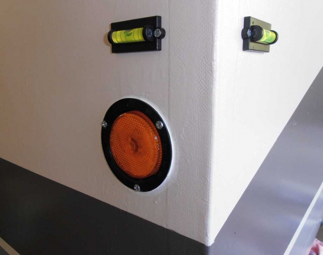

Just to demonstrate that "Ten Foot Rule" will really need to apply. Even one of the best looking seams still looks like this:
The flat seams really are the worst offenders.
