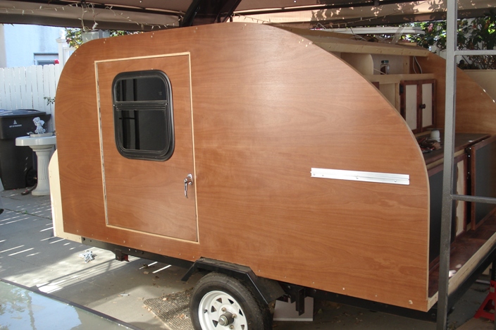

I got a trailer from Harbor Freight, and originally decided that I would build a 48 x 96 Benroy style Woodie. I got the frameworkk done and laid a piece of plywood on the floor and had my wife come out to make sure there was enough room. Well we decided to go 5 foot wide and I added another 2x2 floor joist system that brought the bed up another 1 1/2", which actually brought the floor of the Tear up past the wheel wells.
I decided I would build up the walls using 1/4" Mahogany plywood, 1x2 frames and 1/8" luan plywood for the interior. I laid out all of the plywood as it would fit together on the trailer. I put some small nails in about 4 places, and then I marked and cut out all of the pieces at the same time. I also did the same thing with the doors. All of the pieces came out exactly the same.
I cut the bottom of the interior plywood 1 1/2" shorter than the exterior piece, so that the wall formed a rabbit joint at the floor.
I assembled the walls on a large table in my garage, filling the voids with rigid foam insulation, and gluing everything together with Titebond III and using 12 24packs of water to apply pressure to the wall system until dry, along with all the clamps I had.
I attached the completed wall assemblies to the trailer floor and added the 2x2 spars, which surprisingly straightened everything up. I glued and screwed the spars in place.
I then cut and assembled the inside skin to the spars using a sealant that we use to install windows. It stays pliable, put is very strong and has a 50 year warranty. I applied pressure to the inside using some lumber that I pried into place. I then framed out the fan opening and cut away the inside.

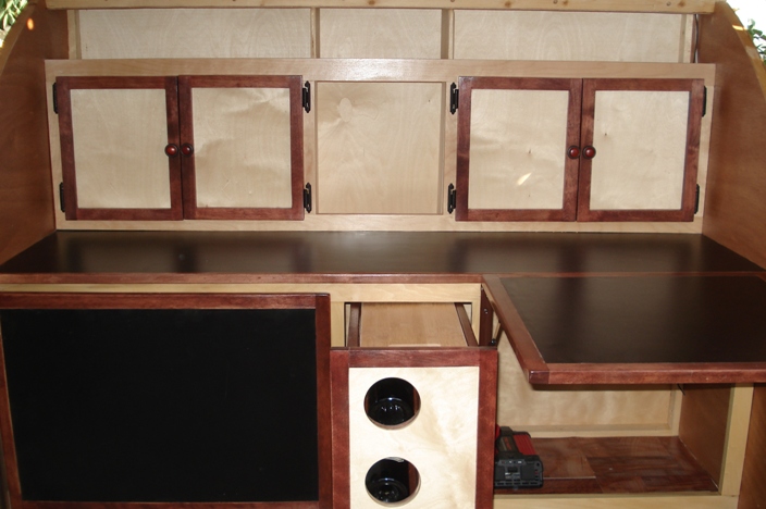

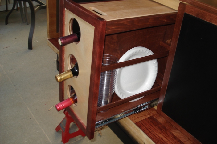

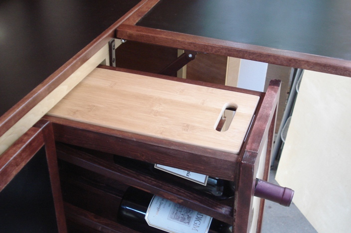

I had to hunt around, but found your gallery. Until the "button" appears, I hope you don't mind me posting a few of your pictures:
Your gallery is stunning.
The integrated wine rack and removable cutting board are fantastic!
