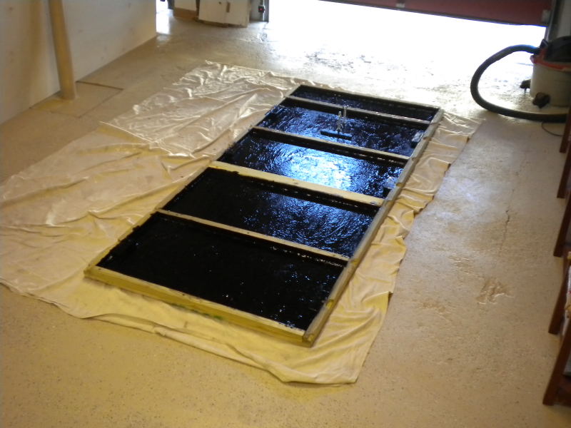

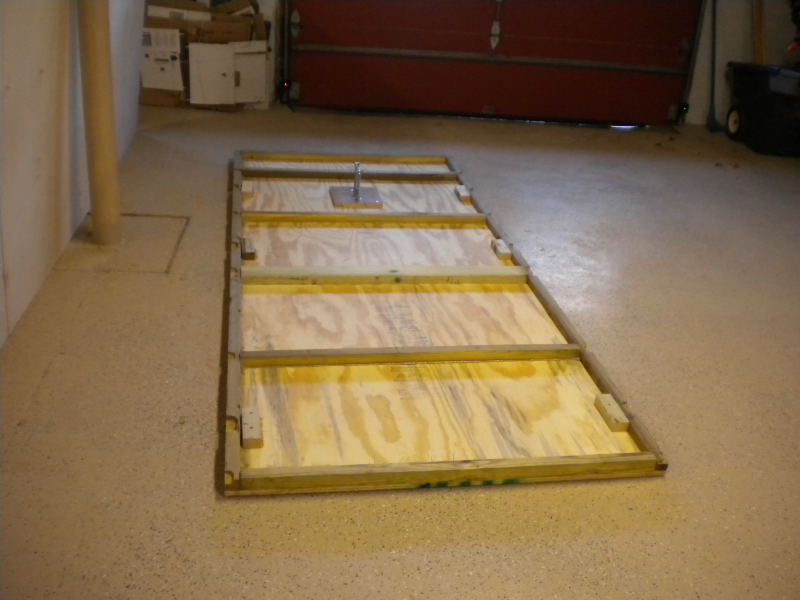

Postby dlud » Mon Dec 20, 2010 10:15 am
We made the floor from 3/4" exterior plywood with the joists made of green treated lumber ripped down on the table saw to 1 1/2' thickness. We routed out for the bolts on the HF frame and added a mount for the spare tire.
We then sealed the bottom with roof cement/sealer.

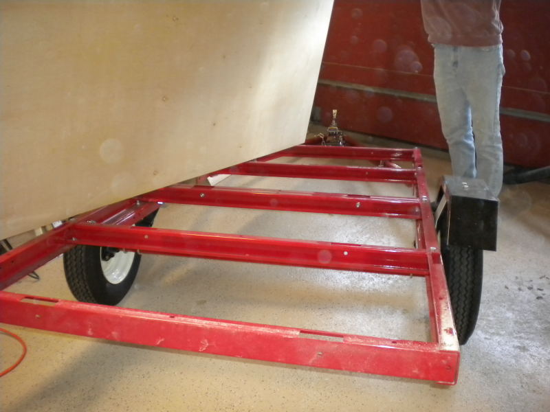

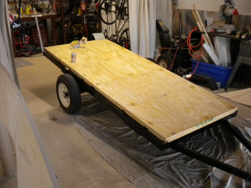

The frame was painted black and floor structure then bolted to the frame after it was lengthened by 12" to take into account that we were building a 9' teardrop. The axle was also moved back on the frame by 12."
