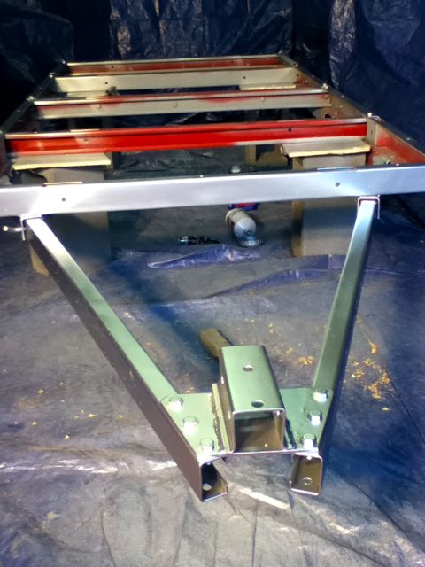

The early stages of assembly of a Harbor Freight 4x8, 1720 lb trailer.

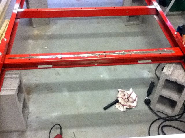

I decided to weld the two halves of the frame together. Here, I've ground the area around the seam down to bare metal. After some marginally acceptable welding, I drove a 1/2 inch bolt through the cross-member just for extra security.
Klaatu barada nikto!

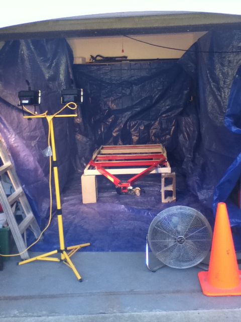

My makeshift paint booth.
First coat of Rustoleum aluminum color paint applied with an HVLP sprayer I picked up at Harbor Freight for $15. The second coat applied with a foam brush looked even better.

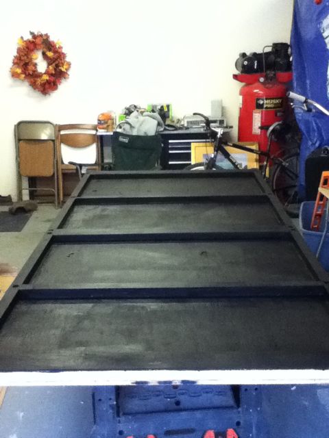

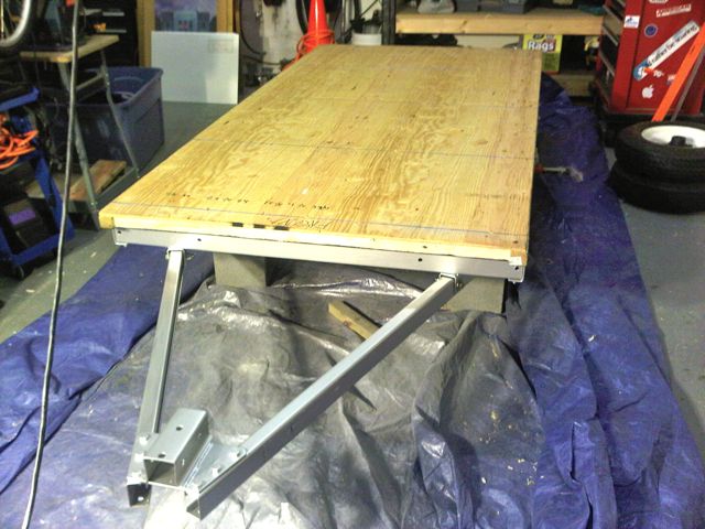

Underside of assembled deck.
Underside of deck coated with Henry's 107 asphalt emulsion. Working with this stuff is a nightmare unless the ambient temperature is at least 50 degrees.

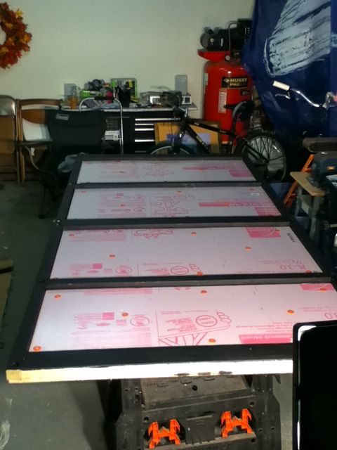

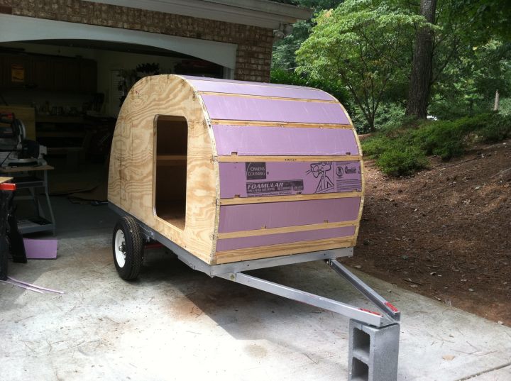

Foam sheet insulation under the deck.

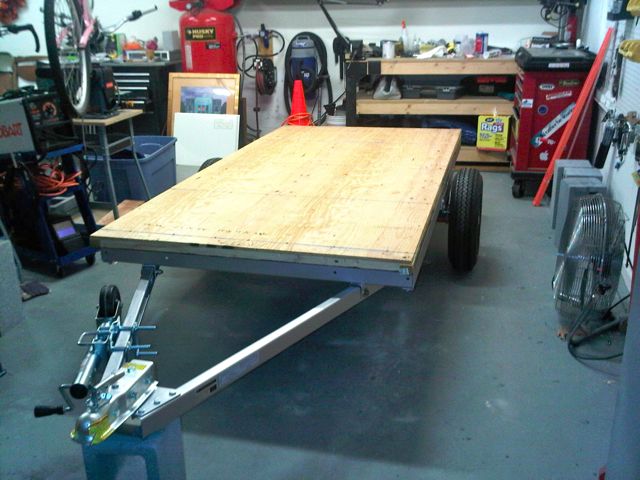

Aligning the assembled deck on the frame. Tomorrow I'll start bolting the deck to the trailer frame.

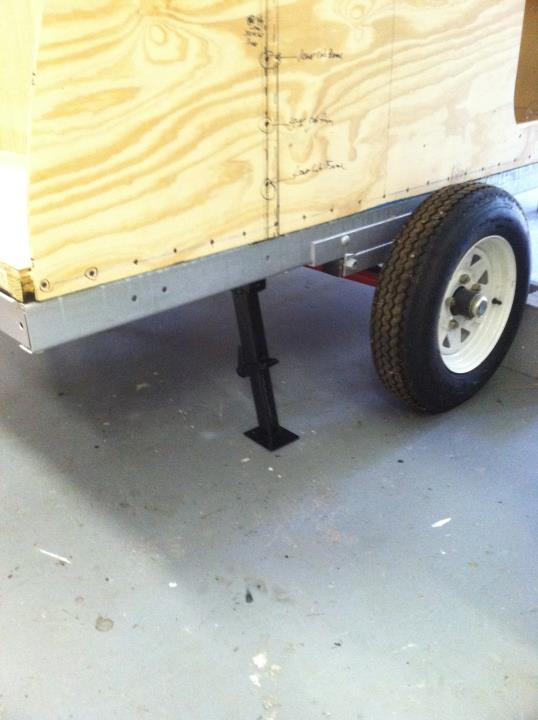

Gear down!
Postby tvlawyer » Sat Feb 05, 2011 11:29 pm
Gear down and locked!

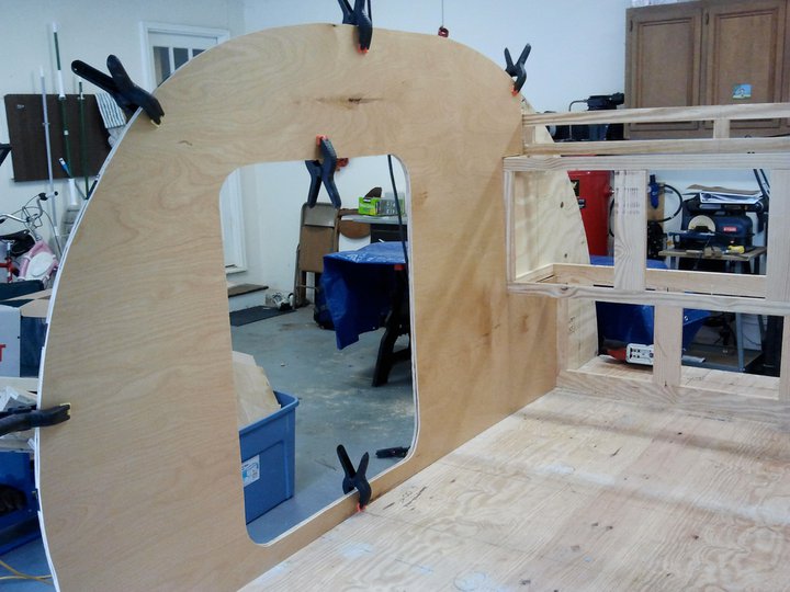

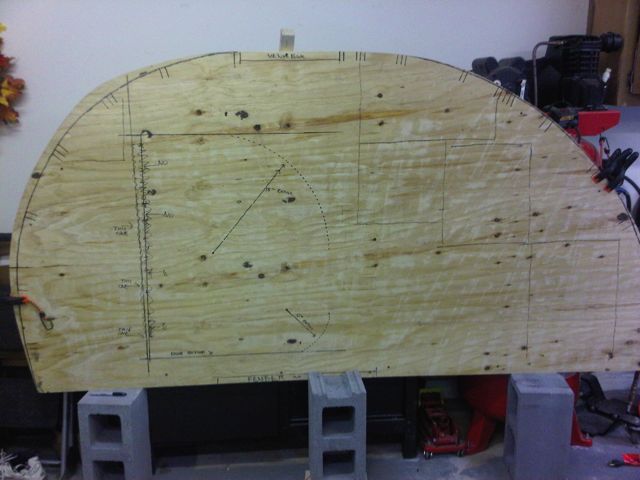

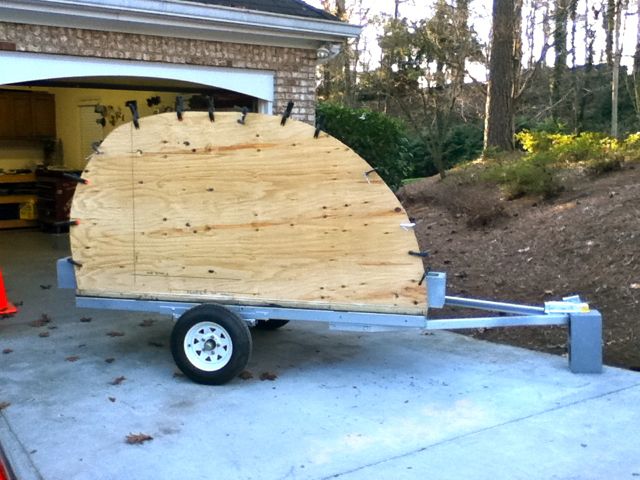

This weekend (2/13/11) I plotted the profile from the Cubby plans onto two plywood sheets clamped together. After the rough cut, I ended up with this.

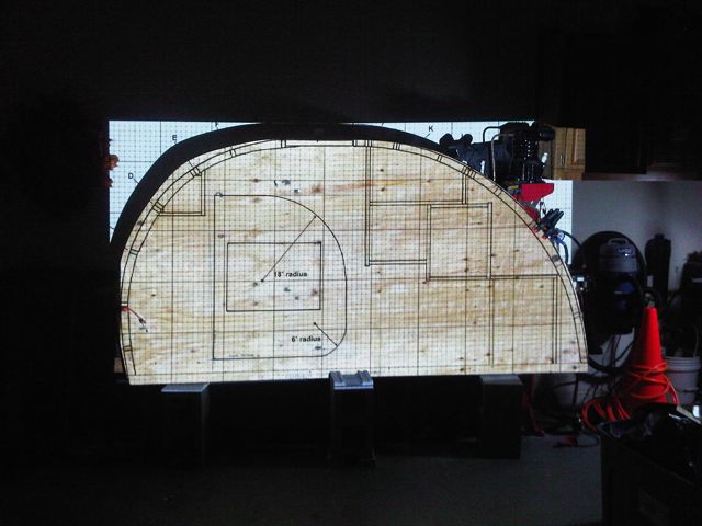

Today (2/15/11) I used a belt sander to contour the edges to the profile outline. Something didn't look right when I stepped back a few feet to look at the profile. I carefully compared the plan to my finished work and could see that somewhere, my plotting went awry.
Light bulb went off in my head! If I project the profile drawing onto my sidewalls, I can see exactly where I went wrong. Voila!
You can clearly see where I went wrong in the "northwest" quadrant of the profile. Using a Sharpie, I traced the projected profile onto the plywood. Here's what saw when I turned the garage lights on.
As you can see, my plotting and cutting was not so bad, except for that upper left section. Tomorrow, I'll cut off the offending area with the RotoZip, sand the entire edge, and I should end up with sidewalls that match the drawing quite nicely.

Postby Miriam C. » Tue Feb 15, 2011 9:29 pm
Um shouldn't the profile be reversed? Are you making the fat part the back? Maybe it is the angle.... :thinking: I used a belt sander to make my edges even.
Postby tvlawyer » Wed Feb 16, 2011 7:15 am
You're right. The wall is not affixed to the trailer. I just put them on the deck so I could step back and look at my work.
Larry S.

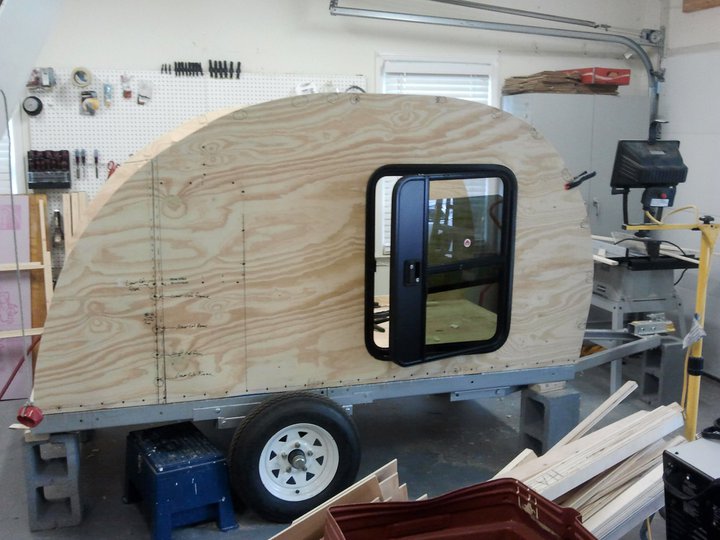

Postby tvlawyer » Mon Feb 13, 2012 8:19 am
It's been a long time since I've posted any updates. I'm 14 months into a 9 month project. :?

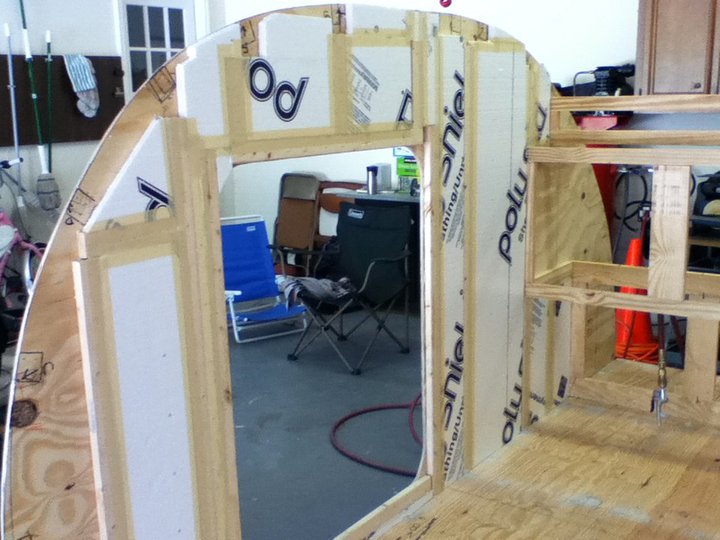

Postby tvlawyer » Mon Feb 13, 2012 8:21 am

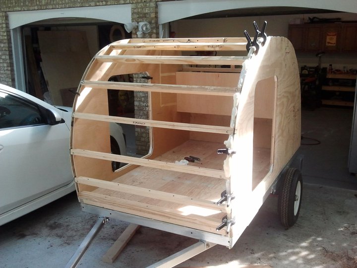

More
Larry S.
Marietta, GA
tvlawyer
Posts: 30
Images: 14
Joined: Wed Dec 15, 2010 8:30 am
Location: Marietta, GA

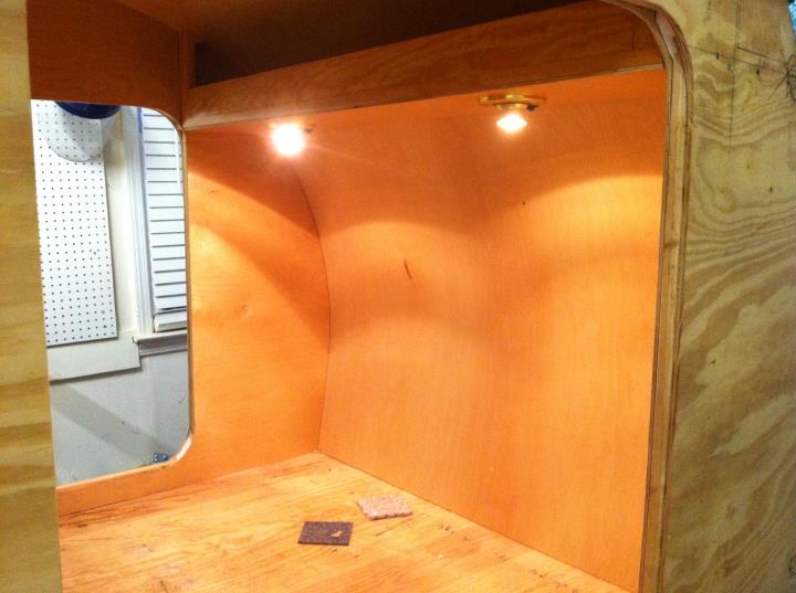

Re: The DC-TT
Postby tvlawyer » Mon Feb 13, 2012 8:22 am
More
Larry S.
Marietta, GA
tvlawyer
Posts: 30
Images: 14
Re: The DC-TT

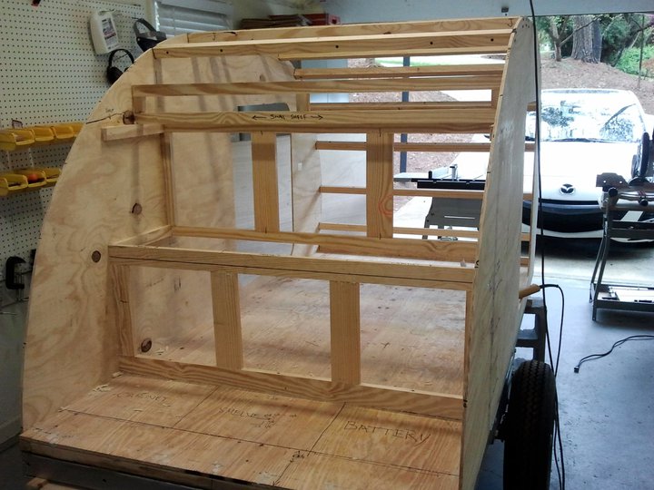

Postby tvlawyer » Mon Feb 13, 2012 8:25 am
More

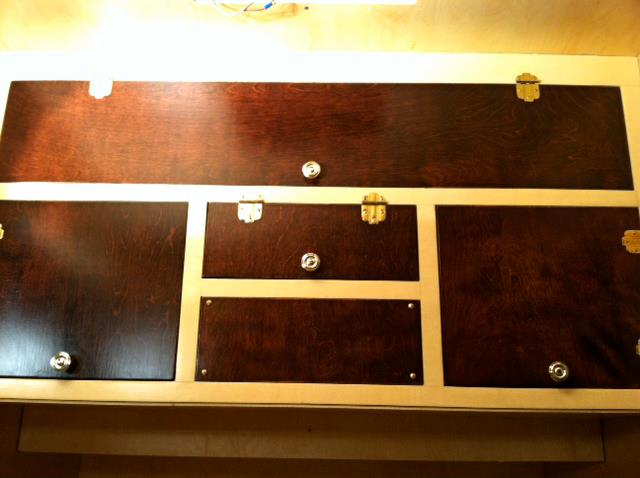

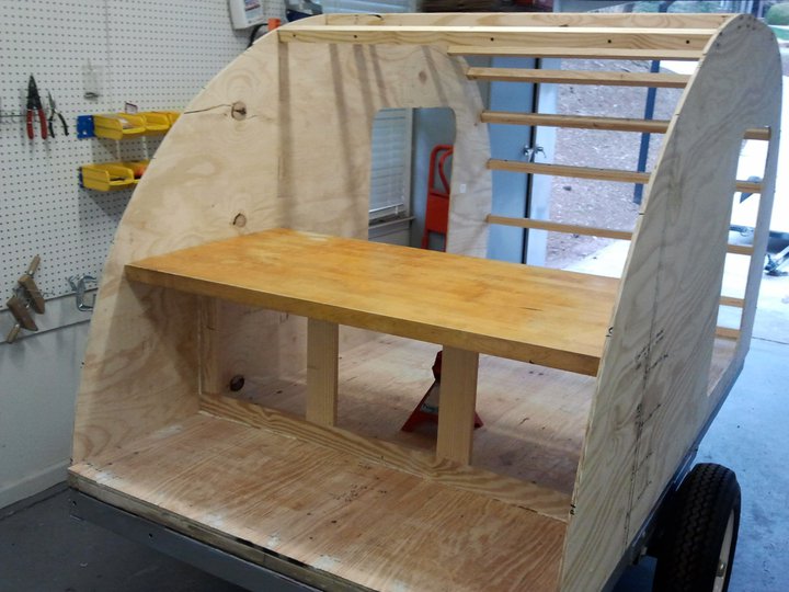

Interior cabinets
