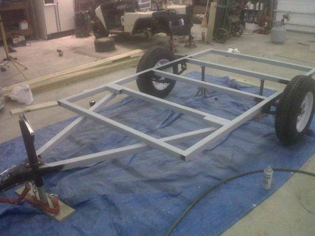

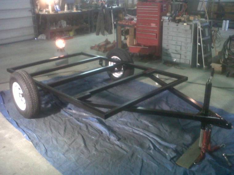

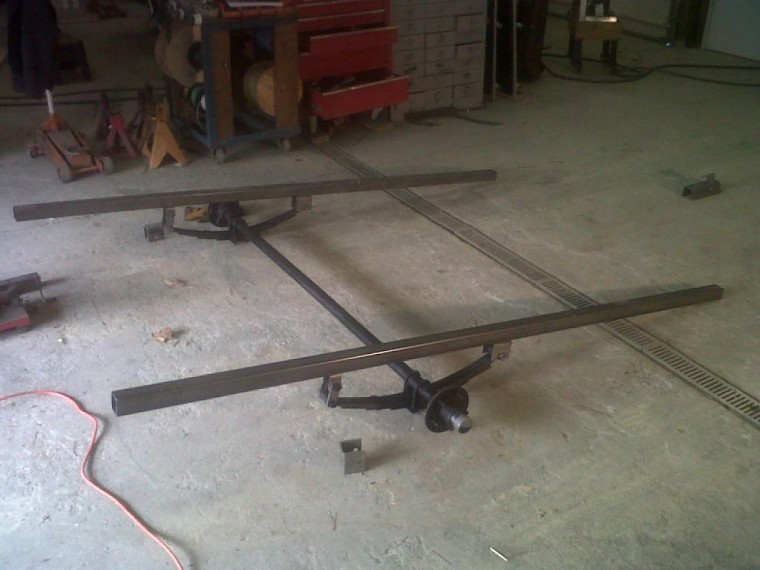

HERE IS THE TRAILER AT THE BEGINNING OF THE BUILD. BUILT THE TRAILER AT WORK Image
PRIMED
PAINTED Image

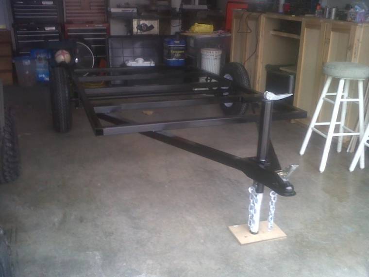

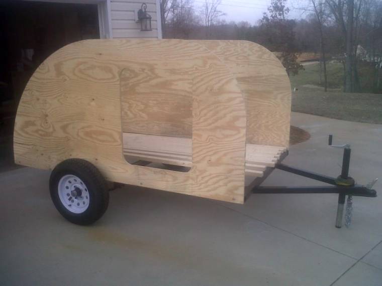

AT HOME AFTER MAIDEN VOYAGE Image

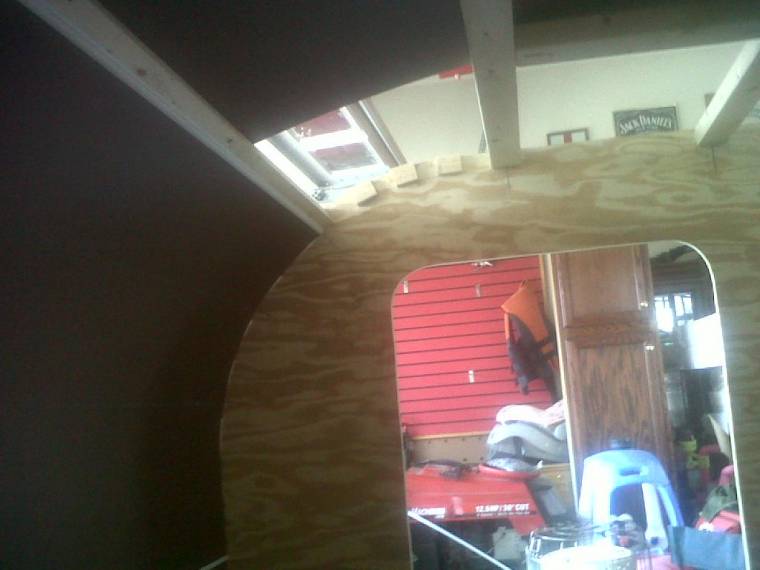

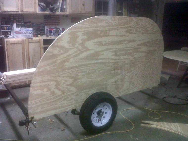

TEST FITTING THE WALLS Image
NEW DOOR FITS GREAT Image

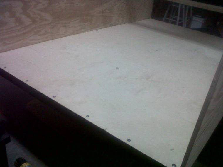

FLOOR COATED, BOLTED AND SCREWED DOWN Image

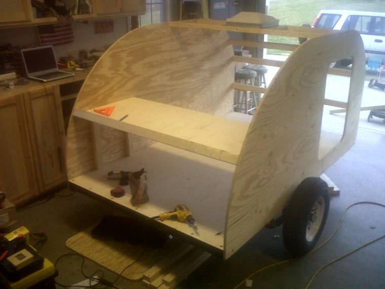

TRYING TO FIGURE OUT MY "HALF" GALLEY Image
AND THIS AS FAR AS IVE GOTTEN... Image
PLEASE GIVE ME SOME FEEDBACK... WHATS YOUR THOUGHTS

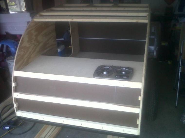

Hey JoeBob looks great!! Why a half galley?

Postby joebobsqrpants » Fri Mar 11, 2011 7:49 pm
Im not really sure to be honest. i think its kinda what I saw in my head when i started to design it. The trailer is 5x8 and im gonna use a queen size mattress which only leaves about 9 or so inches... Im thinking that area will be used to hide the wiring,battery and propane hose. Thank you by the way! Im actually getting ready to work on her as we speak so hopefully ill have an update pic soon.

Postby LDK » Fri Mar 11, 2011 8:12 pm
joebobsqrpants wrote:Im not really sure to be honest. i think its kinda what I saw in my head when i started to design it. The trailer is 5x8 and im gonna use a queen size mattress which only leaves about 9 or so inches... Im thinking that area will be used to hide the wiring,battery and propane hose. Thank you by the way! Im actually getting ready to work on her as we speak so hopefully ill have an update pic soon.
Hey JoeBob,
Maybe you could hinge the galley counter to lift up. That way you could have a compartment for your battery etc. :thinking:

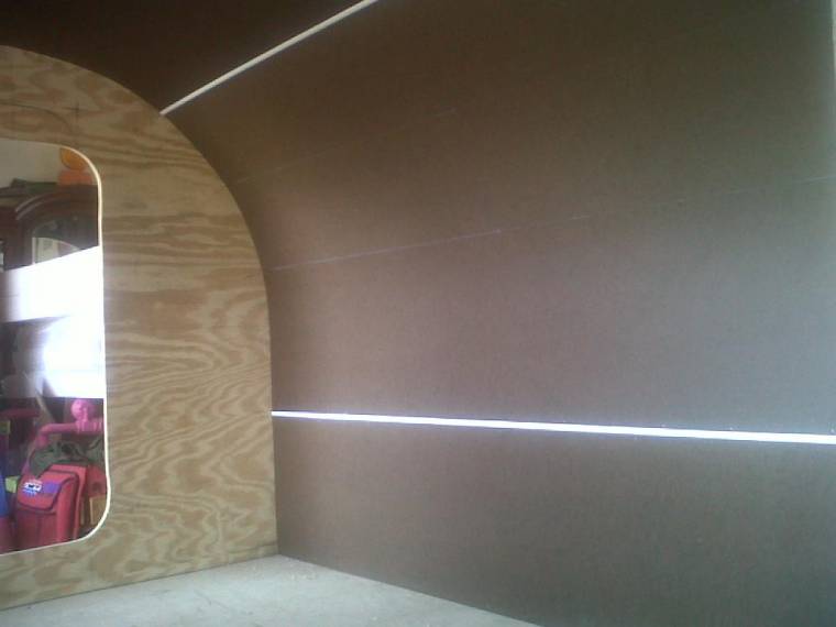

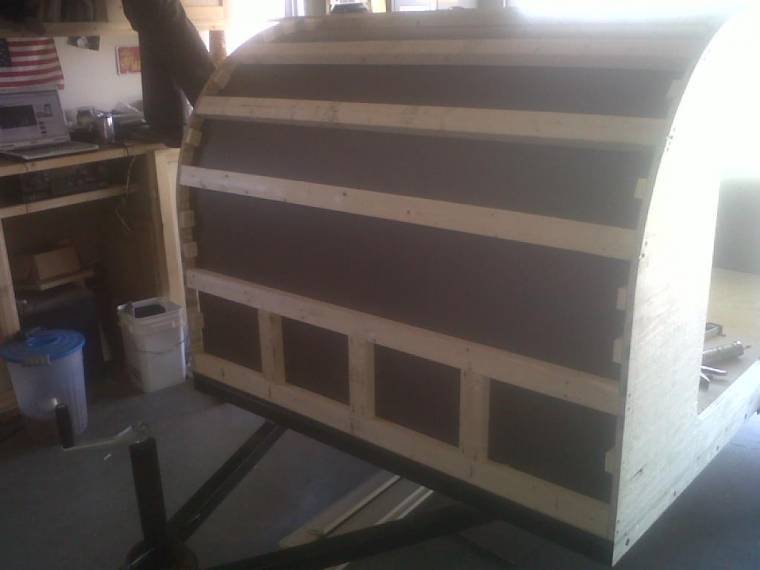

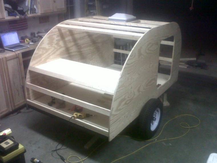

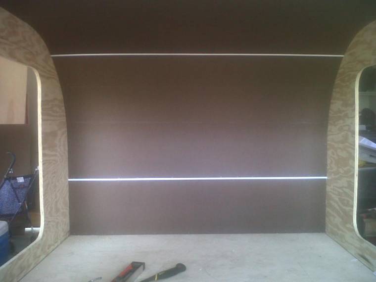

Starting the headlinerImage
Headliner in...looks awesome!Image
Another view of the new headlinerImage

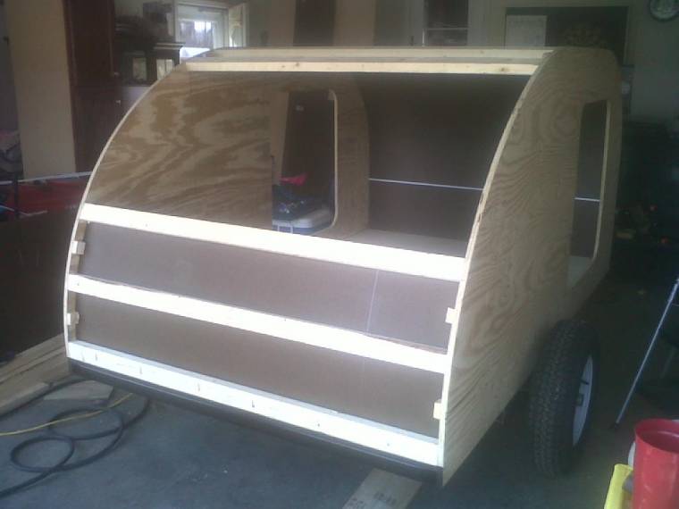

Getting ready to work on the galleyImage
Front view after installing headlinerImage
Got the stove i picked up from a wrecked rv for $20! never been used!Image
Another look at the "new" stove in the countertopImage
Started to add the insullationImage
I cant stop looking at the camper that is coming alive more and more everyday. I had a good weekend and had so much fun working on the camper...which i still need to name...it was taken down to just the floor on the trailer. After coating some edges and glueing everything back together it just fell together. All i can say is a weekend full of theropy!

Looks good Joebob!! What are you using for your headliner?
Cliff

Postby joebobsqrpants » Mon Mar 14, 2011 7:42 pm
CliffinGA wrote:Looks good Joebob!! What are you using for your headliner?
Cliff
Im using 1/8 tempered masonite ($8) and the joints are right next to the masonite in Lowes. I glued and stapled it up. My trailer is 60" wide so of course im having to figure out new ways to "stretch" 4' wide everything. I plan on priming like crazy and painting interior.

Postby CliffinGA » Mon Mar 14, 2011 7:48 pm
I was wondering what it was! I picked up the 1/8" Luane I will be using in mine today. Trust me I understand the stretching because mine is 66" lol. I will be doing a lot of stretching for headliner and the roof of the tear.
