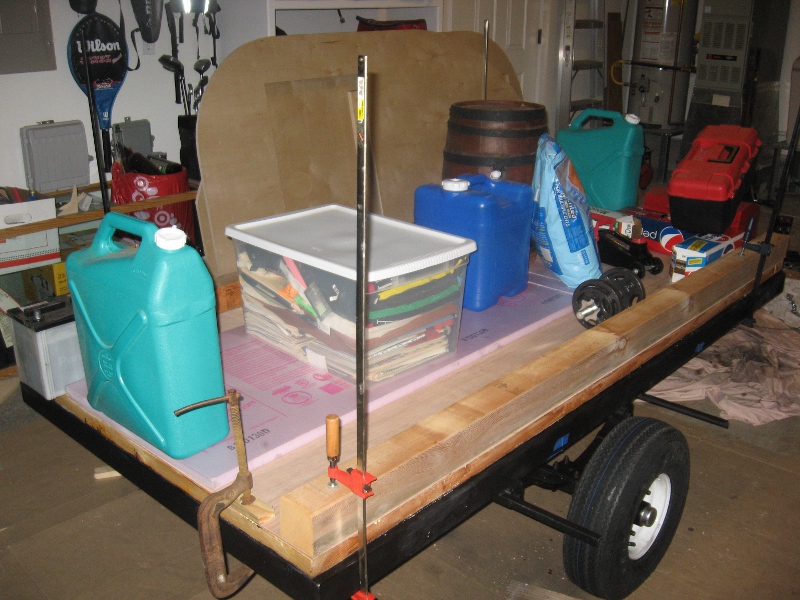

Cutting some pink board to insulate the floor.
Getting the underside all sealed up. Used Polyurethane, exterior latex primer, and black exterior latex paint (I had it laying around and wanted to get rid of it).

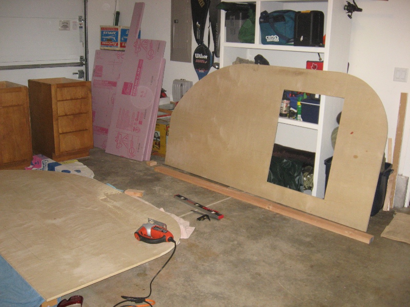

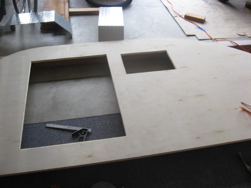

Doors being cut out of the 3/4 inch birch plywood walls.
One door test mounted back on with a 2 foot stainless piano hinge. I put a 1/4 inch round-over on the inside of the door and the frame, the fit came out really nice.

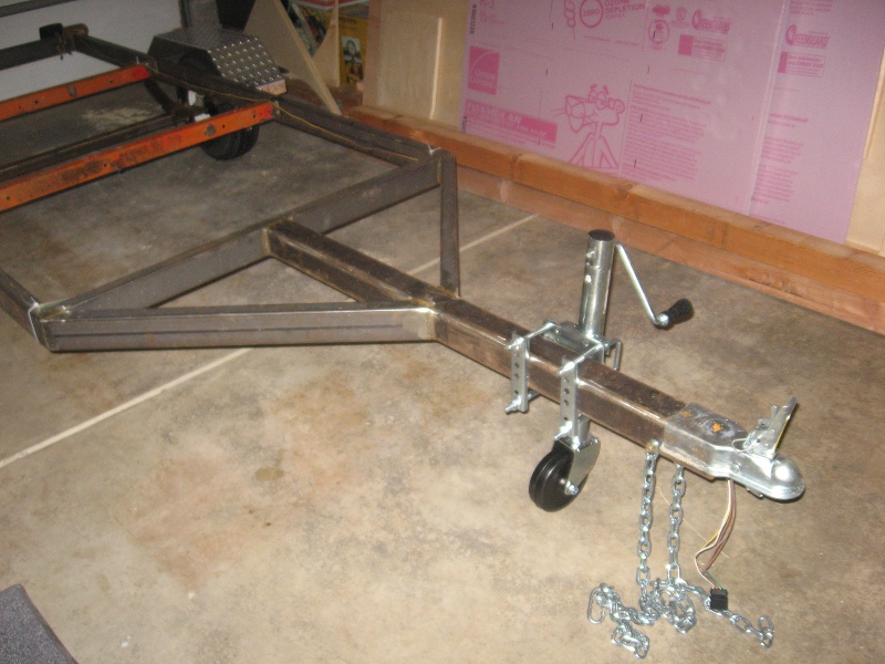

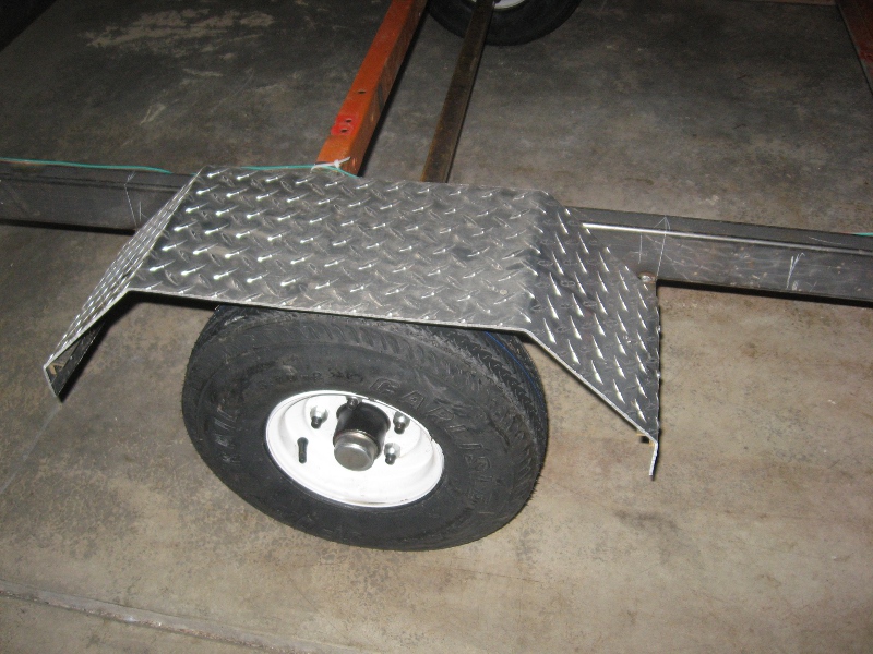

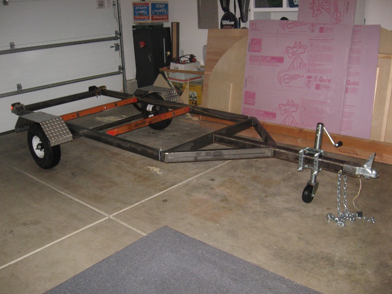

No updates lately because I've been busy building a frame in my dads barn. Finally got it finished and towed home yesterday so here are some pictures. It is mostly 1 1/2 x 3 tube steel with aluminum diamond-plate fenders. The wiring and light job was just to get it home, I'll start priming and painting the frame tomorrow.
Finally got it home. I'm very happy with the quality, but a pre-fabricated trailer would have been a huge time-saver.
The fenders were a little bit of a problem since I don't have access or skills to weld aluminum. We ended up bending these in a press then attaching them to steel supports that are welded onto the frame.
The tongue is 4 ft of 3x3 tube steel.

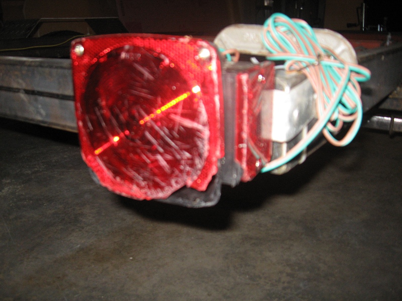

During the test drive I lost a taillight from my temporary light set-up and drug it down the road for a while (hard to say how long). Surprisingly it still worked and i was able to reattach it for the drive home.
Next up is priming and painting the frame, then I can attach my floor that I've already made and I'm off and running. Now that all the work will be done at my house I should be able to move much faster. Wish me luck!

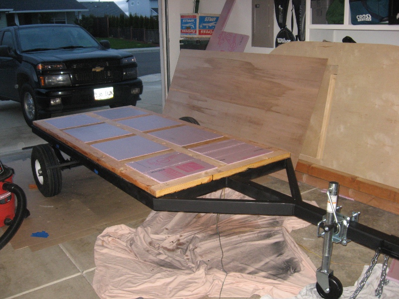

Got the trailer frame painted black, did the whole thing with rattle cans and it actually gave a pretty good finish.

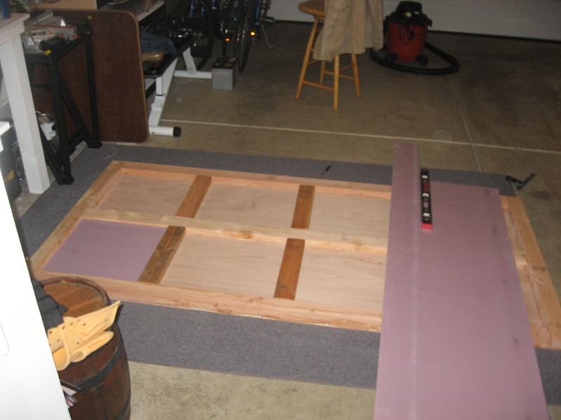

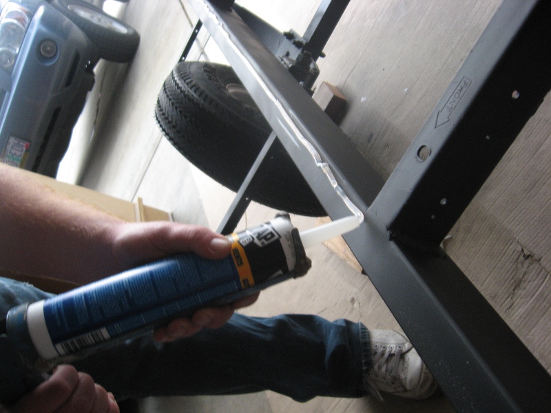

I ran silicon caulk around the whole thing prior to putting the floor down to prevent water from entering from below and getting into the floor or walls.
Floor frame is bolted down and the insulation is all cut to size.

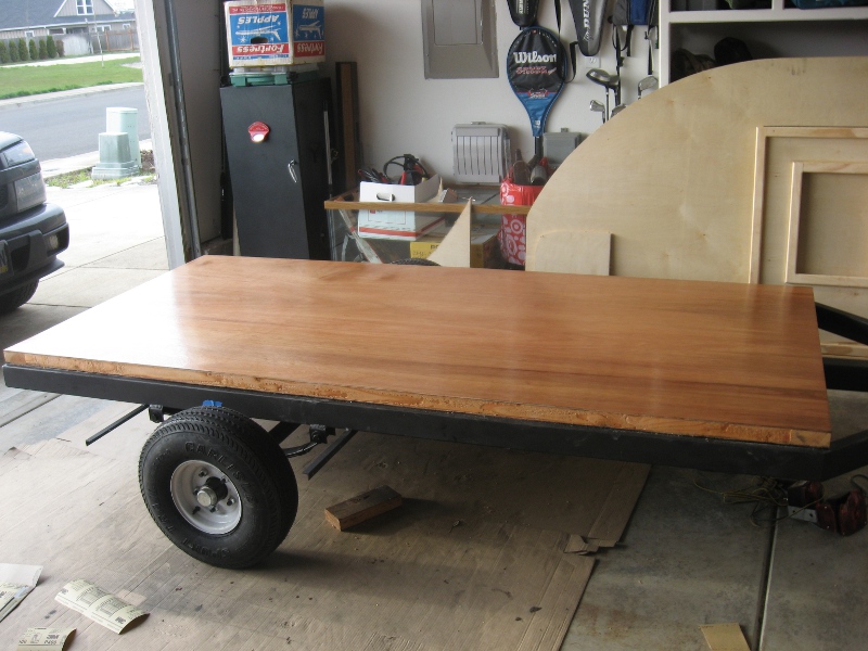

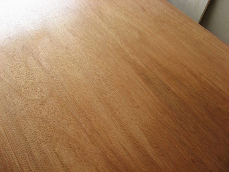

Gluing down the Mahogany top of the floor unit. I didn't want any screws or nails showing on the floor so I glued the whole thing down with as much weight as I could find. It ended up really being stuck on there and it looks nice with no fasteners showing.
Here is the Mahogany floor with a couple coats of Poly on it. It wont be seen much, but I think the contrast with the Birch walls will look nice.

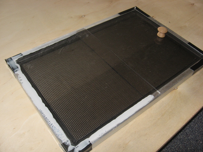

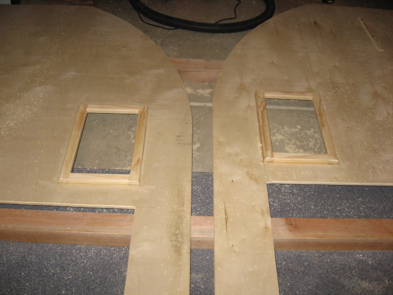

I was having trouble finding windows that fit my needs, so i built these out of window screen, aluminum channel and lexan. It's a slider that will be framed into the walls, one on each side. Once the wood trim is framed in around it you won't be able to see the aluminum anymore, just the lexan and screen. I like the screen because it has almost the same effect as using a tinted lexan, keeping some of the light out.
A closer shot of the Mahogany floor. I like how the look turned out, but it is a little dark for doing the whole interior (the lighter birch might make it seem bigger inside.)
Here is the window cutout on the sidewall, showing the window placement.
There will be large tinted double paned glass windows in both doors, then one of these smaller sliders on each side.

I wonder if an added benefit of the silicone caulk bead will be elimination of the squeaking that can happen when the undercoated floor flexes against the chassis. That happens with my build that does not have the silicone caulk although it has diminished as the trailer weight has increased during construction.

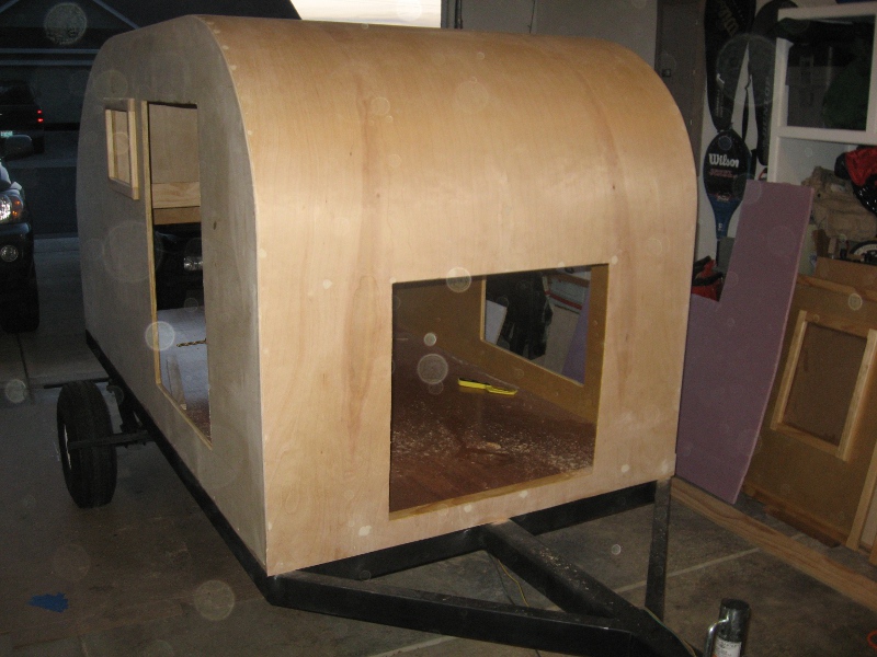

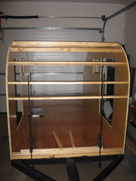

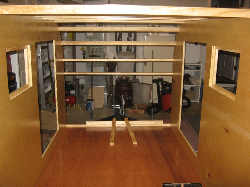

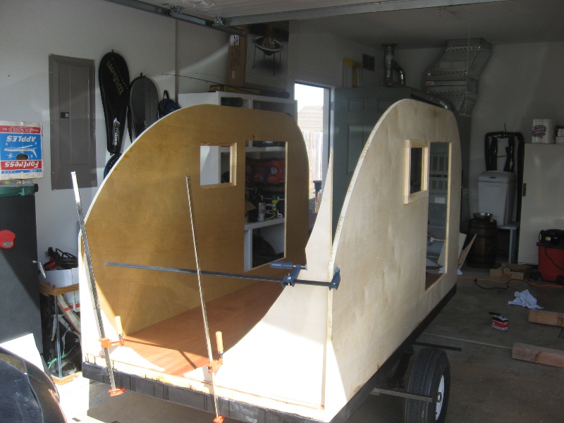

Time for another quick update. I got the walls attached and square then secured in most of the roof spars. I'm doing all the polyurethane on the interior prior to installing these pieces which is slowing me down a little, but I'd rather do it now than get inside later and do all the surfaces at once.
Here are the exterior frames for the smaller sliding windows.

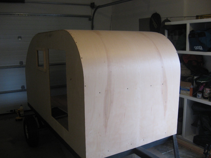

Got the walls attached and square with the floor using clamps and scraps.

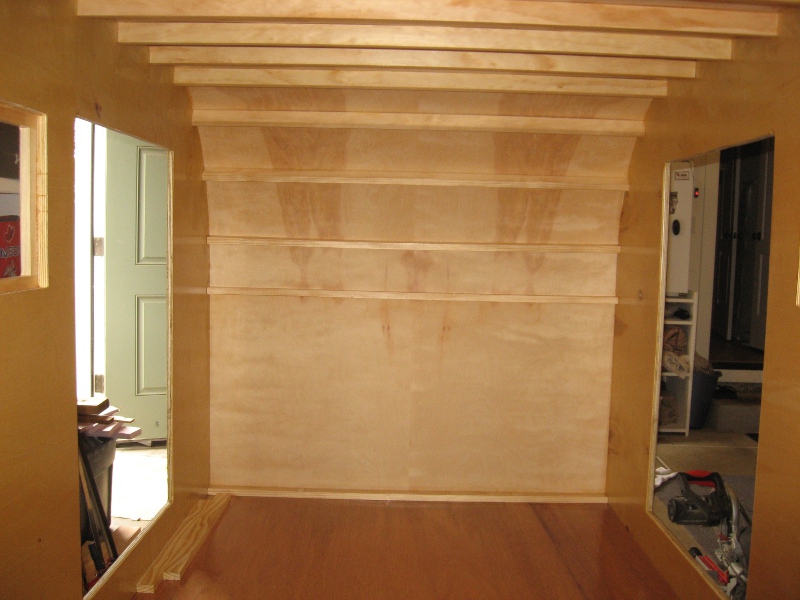

Here is the front of the TD. The reason for the vertical spars is that I am making the tongue box accessible from inside the trailer as a spot to keep backpacks so they aren't taking up mattress space.
Here is an interior shot after getting most of the spars installed.
Here is a shot of the spars from the front.
Thanks for the comments and input. MYoung, I hadn't thought of the silicon as a way to reduce squeaking on the frame, but I will take any benefit I can get on this project. Loader, I kind of wish I would have done the whole thing in Mahogany, but I thought the light birch would make it seem bigger inside. Now that it is all going together I think I may have really liked the red for the whole interior. Sawyer, it is a 3x3 on the tongue, it was a piece that was laying around so i took the angle grinder to it, I like how it looks, I like the strength and it was easy to attach the coupler to. You'll have to make it over here to take a look in person!

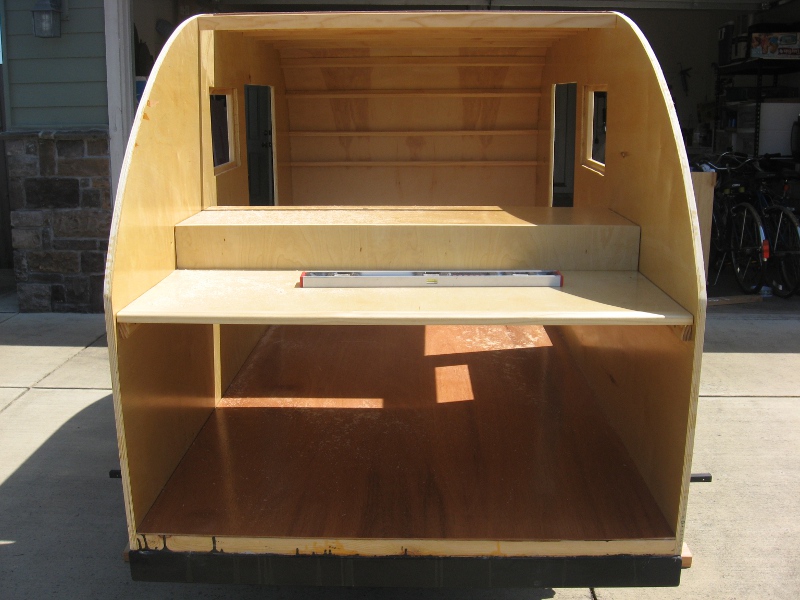

here is the front roof piece bent on and fastened with drywall screws and wood glue.
And the interior view.

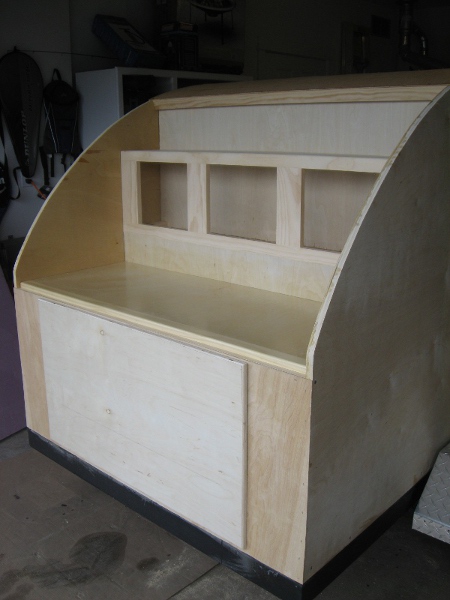

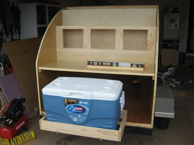

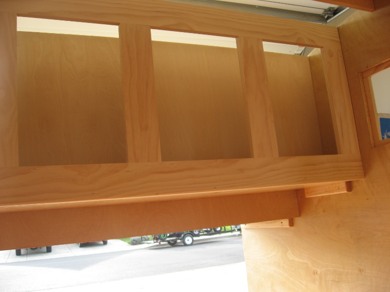

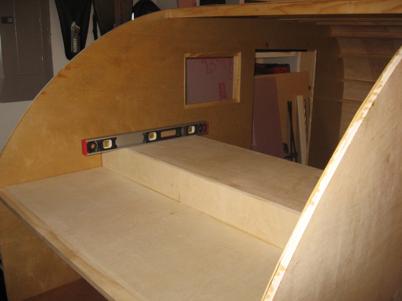

Here is the counter top and base for the cabinets.
And a rear view of the base installed.
Here are the interior cabinet faces.
This is the cutout so that we will have access to the tongue box from inside.

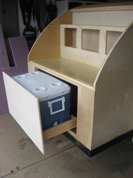

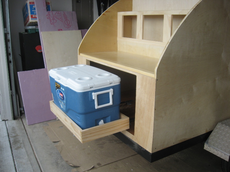

I skipped a few steps on pictures, but here is the slide out cooler that is going in below the galley.
And here it is with the rest of the "roof" installed and the hole routed out.
Here it is with the faceplate installed.
And here it is opened up.
My next two big goals are to build the tongue box and to build the hatch for the galley. Instead of trimming all the edges I've been putting a 1/4 inch round-over on the whole thing then sealing it with body filler. So far I like the look of the round-over and it will hopefully hold the paint better than a 90 degree connection between the roof and sides. With the amount of rain we get here in Oregon "Teardrop Time" is a really useful concept to keep yourself from going crazy with how many little jobs there are.
